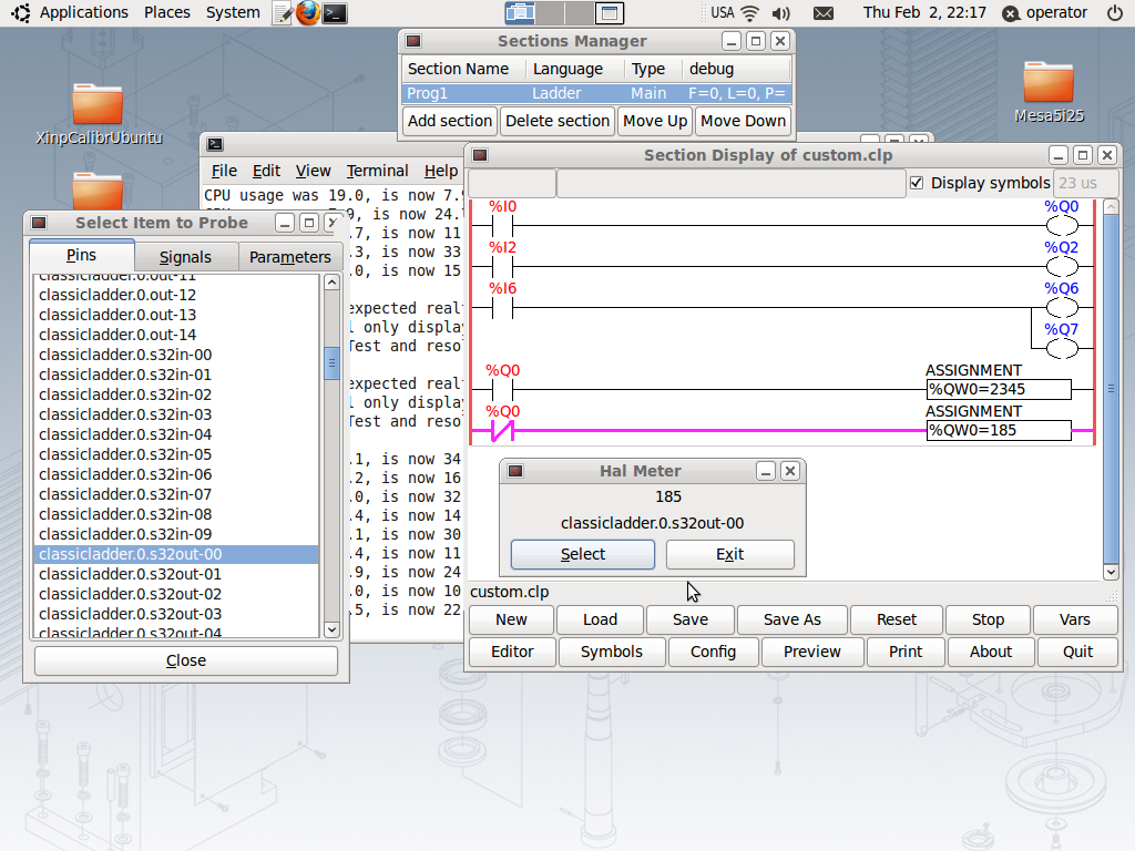

Hello,
I'm trying to work with PathPilot 1.9.6b , in non Tormach machine .I need classicladder .
additionally installed in operator/tmc/rtlib file classicladder_rt.ko .
Now in halmeter classicladder pins are available .
....in hal :
parport.0.pin-12-in => classicladder.0.in-00
.....in custom.clp....
--| %I0|----( %Q0)---
%I0 it works :
parport.0.pin-12-in changed => %I0 changed
but Q0 not changed !
In halmeter parameter classicladder.ladder-state = 0
I cheked config in Debian linuxcnc there classicladder.ladder-state = 2
Can you help me to start classicladder with PathPilot ?
Best regards
Dinyo

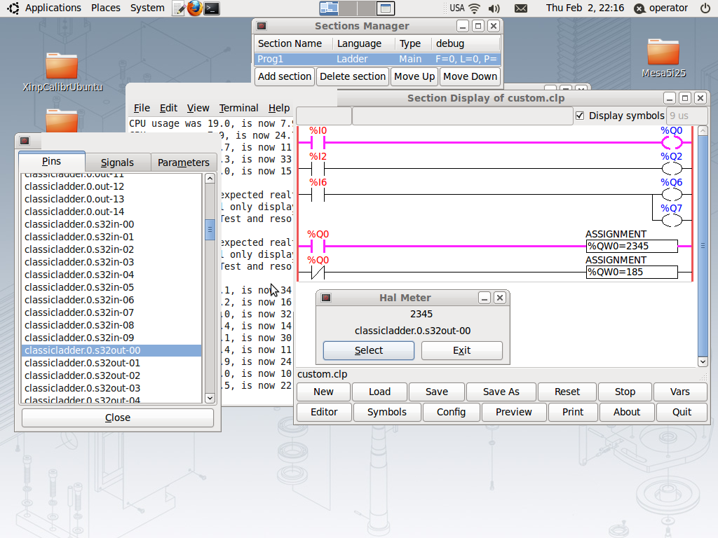

Update - I sourced the classic ladder runtime from a LinuxCNC V2.5/2.6 system that is on Unbunto 10.04. I first just loaded the classicladder_rt.ko into the rtlib directory. At that point the halmeter of classicladder.ladder-state was = 0 (just as you described). Another file for the loadusr instruction is needed. I found the classicladder executable and loaded it to the tmc/bin directory. At this point the classicladder.ladder-state was = 2. So this is very close to working. I brought up the gui by removing the --nogui on the load usr command. The ladder is there but not animated and also the scan time in the upper right hand corner is not moving. The classicladder.0.refresh.time is running. So there must be one more step. The code works in LinuxCNC 2.6.

Update 2 -
So i mixed my executable code from LinuxCNC V2.5 and V2.6. When I took both to the V2.6 everything was good.
classicladder_rt.ko -> tmc/rtlib/classicladder_rt.ko
classicladder -> tmc/bin/classicladder
These are referenced from the HAL code:
loadrt classicladder_rt numPhysInputs=15 numPhysOutputs=15 numS32in=10 numS32out=10 numFloatIn=10 numFloatOut=10
loadusr -W classicladder --nogui custom.clp
Looks like it works fine!
