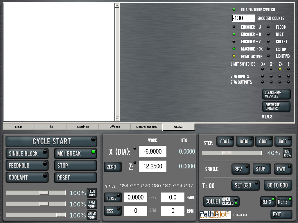

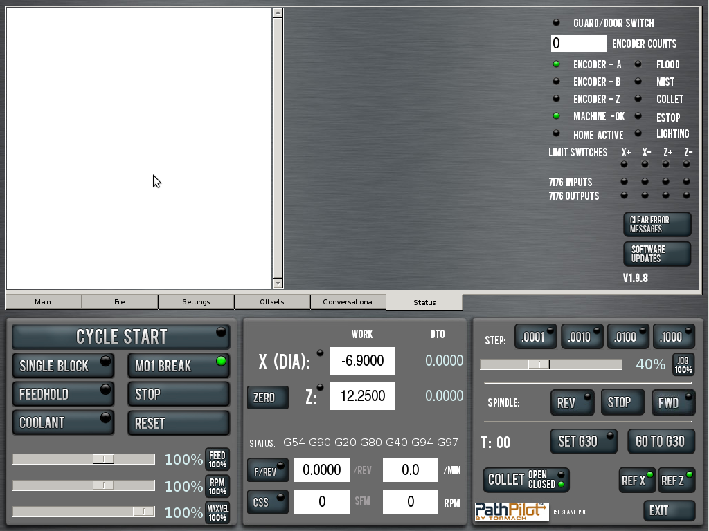

Spent some time learning how the gui works and I am getting a better idea so I made some minor changes to it
I changed the led for the Door, I'm color blind and can not tell the difference between the yellow and green led so I made it green and black, That was first change.
I added a second colum for Flood, Mist, Collet, estop and external lighting. (flood is working)
I also change the label on the HOME to indicate when it is homing and added individual leds for X+/- and z+/- also working
so when HOMING the HOME LED comes on, then when it trips the limit switching the one that is hit is lit up.
Finally changed USBIO labels to 7i76 since thats my source of I/Os
oh, and made the version number a bit larger and i'm doing this to the V1.9.8 Version
I have more work to do but it's fun learning the gui and python
I want to add a Lighting Button on the main page but there really isn't room for one. I could add it to the Settings page but that makes no sense really.
Anyway, thought I would share my adventure in GUI editing.

also, i had to move the limit switch stuff to the postgui because I couldn't figure out how to use a signal inside the GUI. does anyone know if you can use a signal inside the gui or are you limited to HAL PINS?

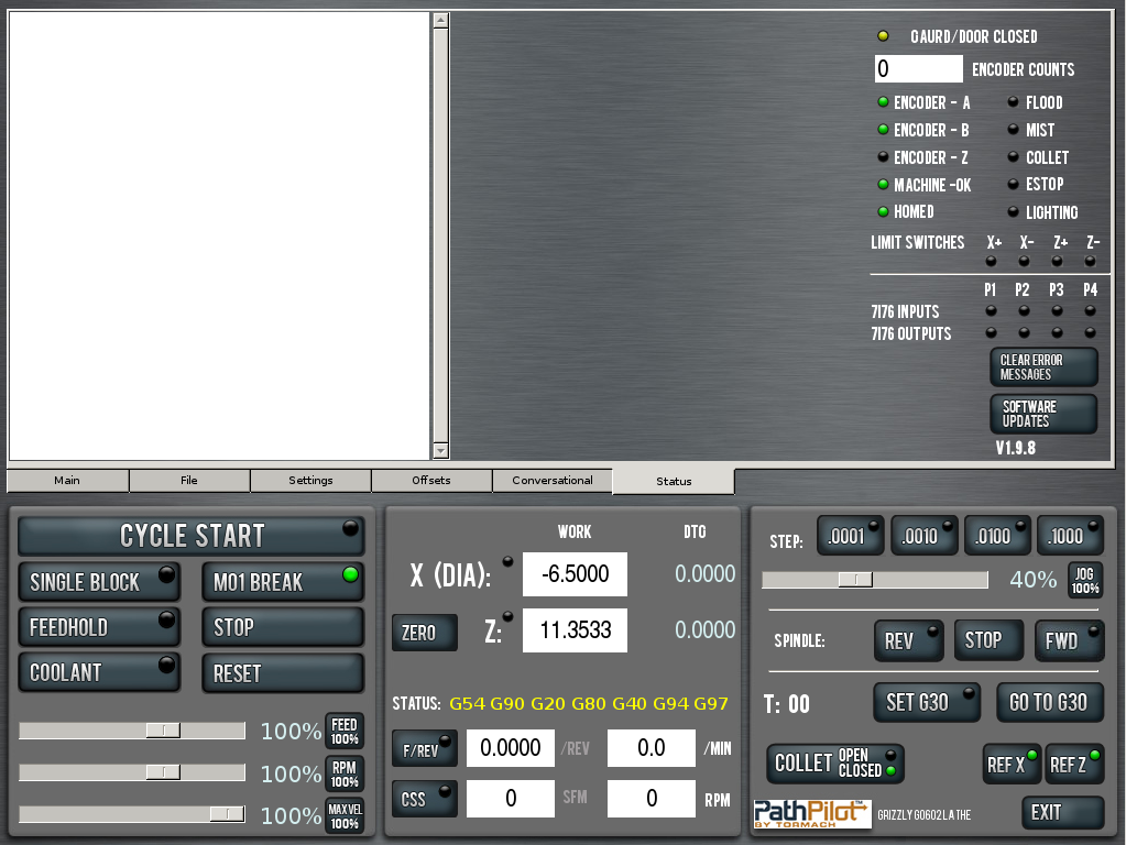

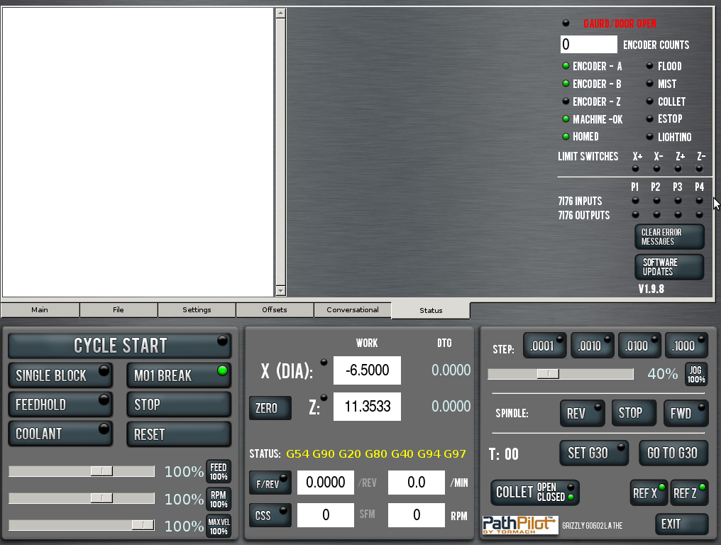

I tried like putting a OFFET just above Status, it worked but I needed to figure out how to remove the current offset from the Status line otherwise it really looks redundant
Here's some of my latest playing around
Modified the Gaurd/Door Label to turn RED when it is Open, Makes the unsafe condition clearer
Modified the Home Switch to Say Homing while it's Homing with a Yellow LED, When Both X/Y are Homed the LED is Green and the Label Says HOMED.
Modified MACHINE OK to also Go RED and Say MACHINE NOT OK when the Machine Check is in error
Added a [CUSTOM] to the INI
with a way to change the Labels for the Machine Name and USBIO Label
[CUSTOM]
MACHINE_LABEL=Grizzly G0602 Lathe
MACHINE_IO_LABEL=7i76
you can see both on the screen shots, if they are not in the INI it will use the defaults in pathpilot
Shifted things around a bit to put labels above the IO LED for P1-P4 just so there's no confusion with the X+/- and Y+/- labels
Flood and Collet LEDS working
Not sure yet how to hook up the Mist LED
Need to tie into the ESTOP logic
Need to Add a Lighting Button Somewhere which would turn on/off the lighting inside the enclosure (or any lighting you hooked up)
This is mostly a learning experience for me on Glade, Python and Pathpilots UI
Really does help understand it.
One thing I would like to work out is having a Spindle Orientation DRO show 0 - 360 degrees of rotation,
Curious of anyone else thinks that would be useful?

I decided to bite the bullet on selecting between Flood or Mist Coolant. So I did up new buttons for Flood and Mist, added the code to support mist (for flood just changed the images).
Here's the latest version of of the lathe control screen
you can see a few other cosmetic changes.
Next to figure out where to add a Light Button so you can control any light source such as the one inside the lathes enclosure (maybe use the Y Axis Ref button for that and I don't need rapid turn features)
Also I'm thinking I might use the Y axis for a Spindle Orientation DRO. this is normally used for rapid turn also
