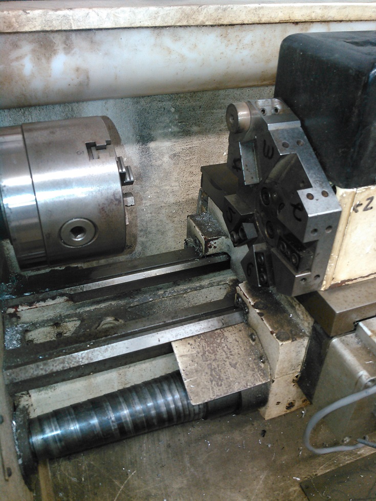

Hi All,
I'm starting this thread before I make a mess of everything. I have a lathe with a 6 place turret with a 3 disc opto sensor to position turret. This lathe was running mach on the parallel port (with gecko G210) so it is already wired with a breakout board.
I have PathPilot installed (and have a mesa 5i25 card) but have not install the card yet for fear of flashing it wrong. I have also read most of the treads on PathPilot before I started. Also I have downloaded a copy of the 5i25_7i76x2.bit file.
So here is where the question starts, Is this the right directory for Lathe ?
"you will need to set the file permissions for the bit file
group 1002 & owner 1001
so : $ chgrp 1002 <path>/5i25_7i76x2.bit
$ chown 1001 <path>/5i25_7i76x2.bit "
,it looks like mill.
Also , will the 5i25 be OK with the gecko drives or do I need Mesa's breakout board ?
Thanks'
Brian

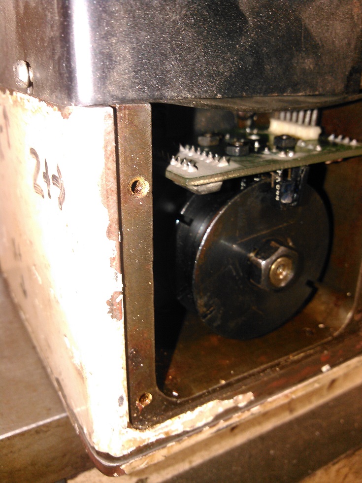

Here is a little more info on the turret.
It only turns clockwise to change tools ,but turns counter clockwise 2 degrees to lock tool after the 3 opto sensors have sensed the proper tool.
Thanks'

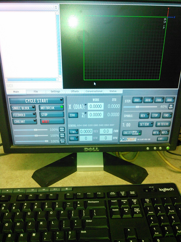

OK,
Have mesa card installed and it got flashed with the 5i25_g540v2.bit , also I have tormach_lathe_5i25a.ini and tormach_lathe_5i25a.hal from cncbashers #2 tutorial up and running and I'm up to the main screen with the reset flashing. Now how do I configure pins to get something to move ?
Thanks'
Brian

There is signs of life, here is the code for the lathe's e-stop from BOB to 5i25
net machine-ok-raw hm2_5i25.0.gpio.003.in_not => machine-ok-db.in (this is pin 15)
Now I'm out of e-stop

Alright! congratulations! Must feel like a win! following your success closely! please keep us posted to your obstacles and solutions as you find them, I for one would be most appreciative for the illuminations!
Keep up the great work!
