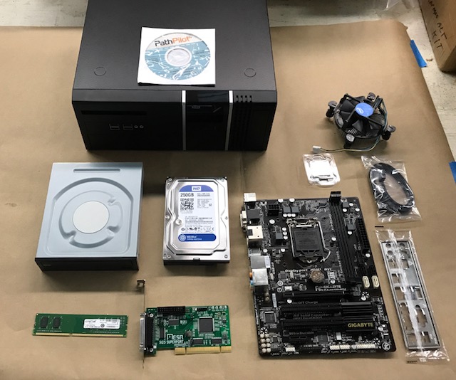

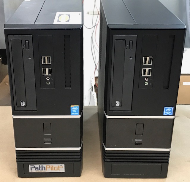

This is child's play for you guys but it's my first build. I took the covers off my controller and wrote down all the part#'s.
I booted my controller in BIOS and got the processor part#. In the spirit of the build I ordered the same case. I know the case is the least
important part but and least they match! My only issue after loading the recovery disc was it won't fully boot up. The date and time was no right in the BIOS I changed that and it boots just fine and I changed the power management settings so the controller could be tucked away and it would power up when power it applied. I hooked it up to my machine and it works fine. Now I can play and not be a fade
of killing my daily machine.
