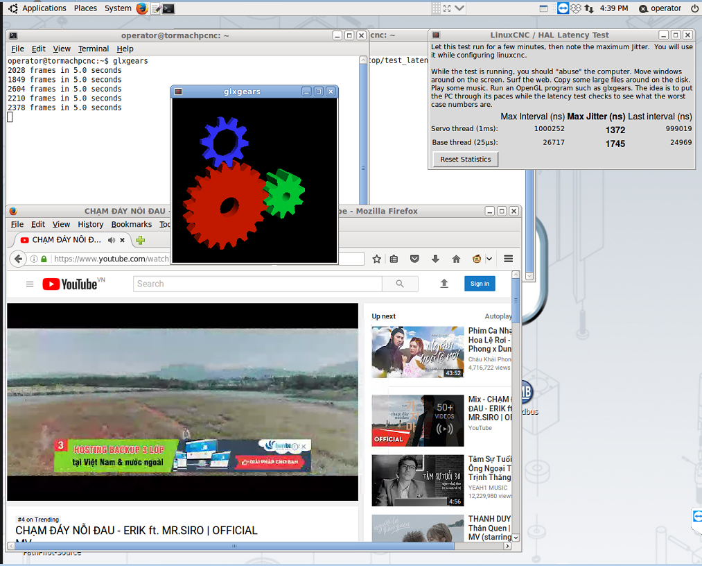

is It working ?, i'm going back to 10.04 Lucid because it give me better latency and i don't owner mesa ethernet card so no need Preempt RT kernel.
