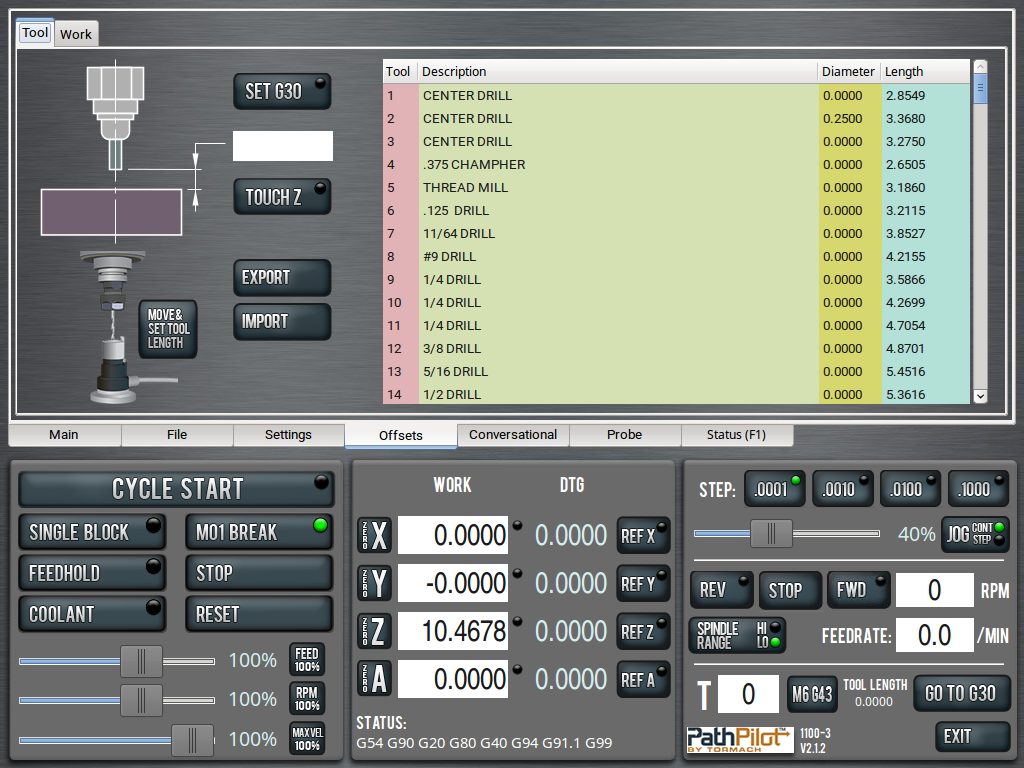

As indicated above, I'm haveng difficulties with this latest upgrade. I switched from Mach to Pathpilot on my Novakon Torus Pro a while back and ran the system for months without a hitch. Great software. However, I recently switched to a later version PP 2.1.5 and cannot keep the tool table populated. Using the procedure published by Tormach, I backed up my system and reloaded after the upgrade but my tool table will not stay populated once I power down and re-start. I have manually loaded some values in the TT (offsets) and they too are lost where cycling the system.
Any ideas??
Why would the new software eliminate the table when starting up??
Any help will be appreciated.
I'm just getting into Linuxcnc so I'm quite lost.
Bill

04 May 2020 15:02 #166625 by billyjack
Thanks for the information. I can't believe this problem is my machine only.
Summary. Upgraded from PP 1.9.7 to 2.0 then 2.1.2. Moved all my Torus Pro files generated by several folks to make the Novakon run PP and had the software running to my satisfaction. That is, until I noticed that my tool table disappears when I cycle the power. I use the ADMIN SETTINGS RESTORE command and load the current tool table. When I power down and back up, offsets shows all my tool id's but the data table is all zeros. I'll try to load a Screen Print of both the before and after.
I'm running a Torus Pro servo with everything stock but the 5I25 card and a dedicated SSD for pathpilot. Version 1.9.7 ran great but I wanted some of the new features offered in the 2.0 upgrades. Besides, I've already paid for it!!!!
Has anyone running my configuration been successful in the upgrade???? Again, I have made no modification other than adding the Novakon ini file, hal file and Torus Bit.
In an effort to help understand what is happening, I cleaned out my pathpilotlog.txt file and restored my tool table. Screen print number One. I then cycled the power and the resulting tool table (offsets) was as listed in screen shot number two. I then printed out the new pathpilotlog.txt and will attempt to attach it. If anyone finds any hint of what my problem is, will you please help.
In the log, mentions are made of "pack porting tools 1-256 in one line and "no update file found" in another line.
I know this is PP and they did a number on the UI but I'm hoping some of this is just Linuxcnc.
If there is anyone that had been successful in this upgrade using a torus pro servo, would it be possible to share your ini,hal and bit files???

05 May 2020 14:32 #166774 by billyjack
OK Guys, this is what I've learned by trial and error (with some thoughtful help from here)!
Tormach did make a change to expand their tool table starting with version 2.1.X. Now In My Opinion. They also are setting some sort of hardware switch for tormach machines. The use of software above the 2.0.4 for the Novakon Torus Pro (and maybe others????) will result in a corrupted tool table after the first restart. Thus the loss of the table.
To get me to the point of a functional 2.0.4. First thing, backup the system and tool data to a flash drive using the ADMIN SETTINGS BACKUP command. This will save the data to be transferred to version 2.0, I then installed the new software to a new SSD with the original 2.0 flash drive from tormach. This flashes the system with the original Tormach data and bit file.
I then added the all of the modified Novakon files to the mill directory and the Torus bit file to the mesa directory. We are still working on version 2.0. I also deleted the 1100-3 ini file. The Novakon modified files will generate a new 1100-3 file pointing to the Torus bit file in the Mesa directory. After restart the system flashed the Torus bit file and the system was functional, I then restored the backed up data by using the ADMIN SETTINGS RESTORE command. The tool data was back and remained after restart. .
I then update the system with the 2.0.4 update and performed the necessary changes for the Torus pro as identified above. The tool table remains and so far no problems. Thus (hopefully) the end of this less than great adventure.
