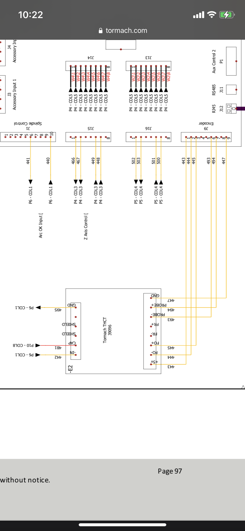

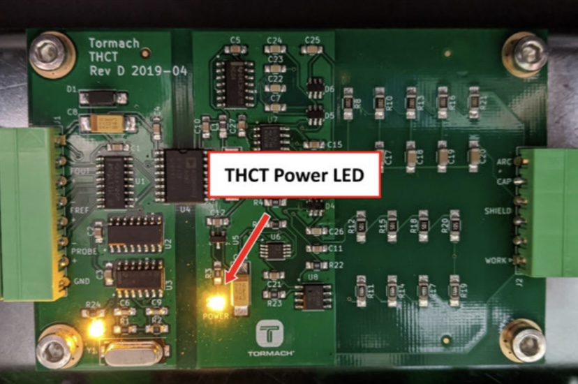

Actually, Robert has eagle eyes. It has 8 pins on the output side and the THCAD only has 6. I'm wondering if those extra wires are for ohmic sensing.
I think It's quite viable to use the one THCAD, for arc and ohmic sensing, particularly if you have a custom FGPA board.

If you trace the wire marked CAP back, that refers to the Ohmic CAP on the torch and the probe signal connects to the encoder pins that the Mesa Plasma bit file would call "encoder 2". So they can use the same board for other machines.
I wonder if their card includes the resistors we've been using? I guess they would.
I think they've quietly benefited from the open source development and put together a good package.
