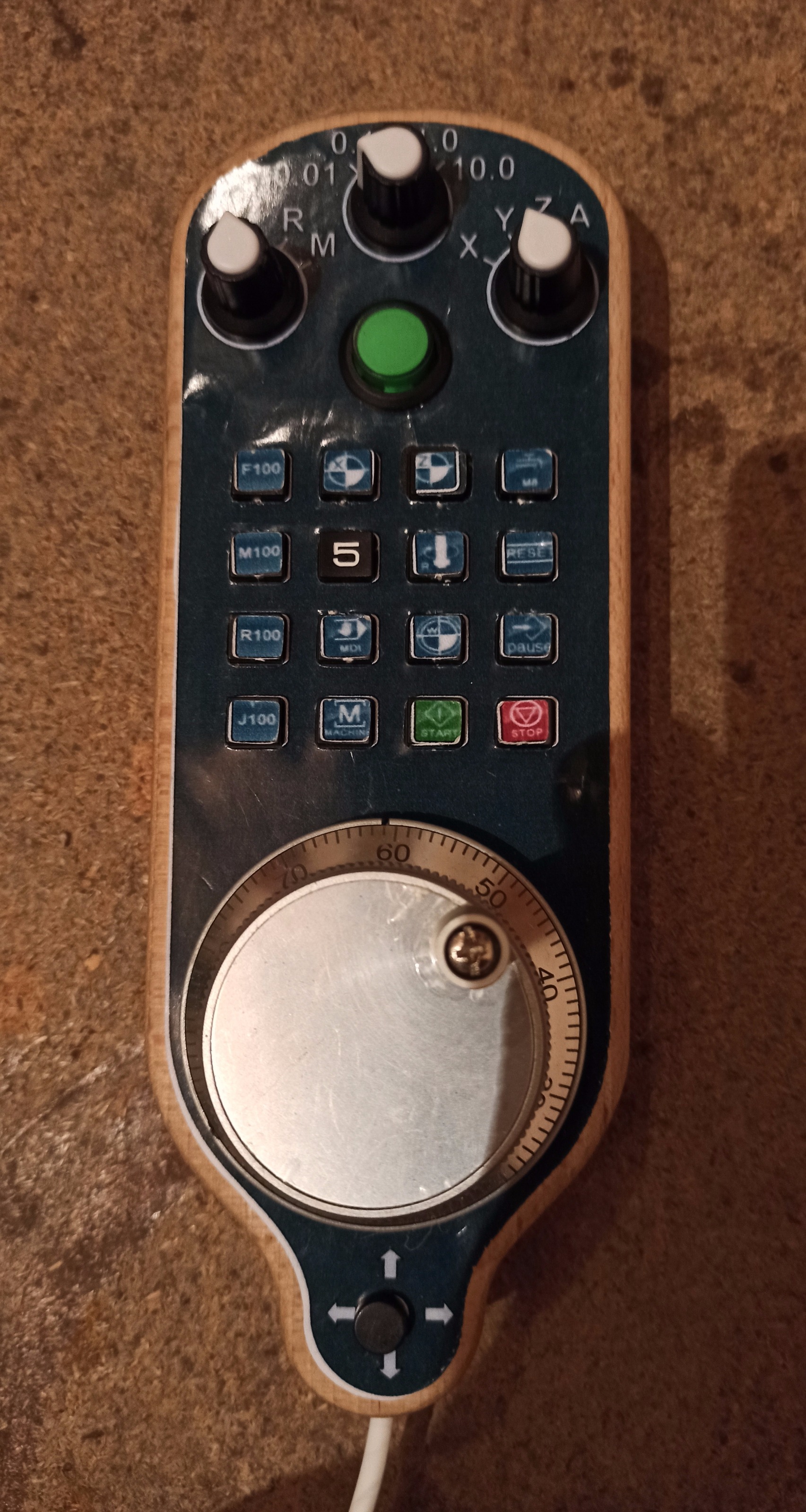

Hi
Does any one know how PathPilot supports the USB Pendants and if its possible to add this support standard LinuxCNC?
I'm interested in this product.
www.madewithcnc.com/products/hand-held-c...h-pilot-cnc-machines

Replied by rodw on topic PathPilot USB Pendants
There are already drivers for USB pendants so sticking with the WHC 4 and 6 axis devices is probably a shorter path to success.

The Tormach implementation, and likely the one you linked to, are all based on this: github.com/ftkalcevic/GenericHID/wiki
Follow the trail from here (www.franksworkshop.com.au/CNC/GenericHID/index.htm) for further info. The original implementation is for LinuxCNC
Gerrit
