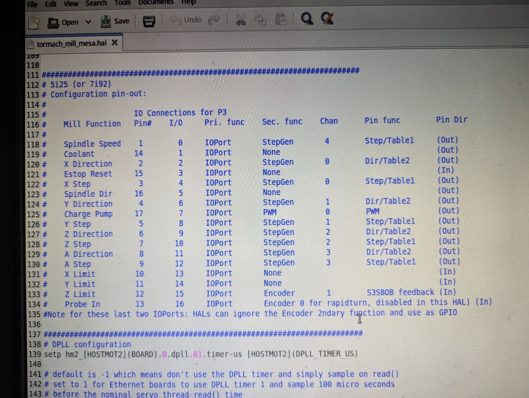

Here's a pic of the .hal file if it's helpful
Thanks for the info. I'll see if those changes are already in Pathpilot and if not I'll figure out how to implement them.
Did you have a chance to look at creating the .bin file for the Tormach? If you need any info from the control, just let me know

- Posts: 18086
- Thank you received: 5321
03 Dec 2024 16:26 #315905
Note that I'm not sure about the encoder inputs. I am assuming both are A inputs
and that the rapidturn encoder is not correct as Tormach has special interpolation
code for this (1 PPR encoder)
Replied by PCW on topic 5i25T Setup with PathPilot
