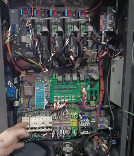

Hello all!
I have a project. I need to build a machine to make small wooden parts. They are simple parts, but they have tight tolerances for wood, and I need to be able to dial in changes in dimensions with software.
I've made two machines in the past that make these parts. The last one used 2 axis coordinated motion with a Yaskawa mp2300 controller (basically a PLC with coordinated motion) and servo motors. The coordinated motion is to cut one simple (but easily changeable) profile with a custom cutter. It cuts a short profile on the end of a long piece of wood, then I advance the wood forward and cut the part off with a separate spindle that has a cut-off saw on it. Then the cycle repeats. the parts are 15-17mm long, we get 100 or so out of each length of wood. A sensor watches for end of material, stops the cycle, and runs a drop scrap material routine. After tuning everything, I got to 1.8 second cycle times on my last machine.
I built those machines more than 10 years ago, and they ran production since then until we recently lost both of them in an act of god type scenario. They took me a year each to build since i did it from scratch and we had the time.
Now we'd like to get back into production ASAP, so I'm looking at buying a CNC mill to have a base to start with. Then I build a bunch of tooling/work holding on and above the table.
My worst-case scenario is I buy a mill and strip off its control, put on overpowered Yaskawa servos, and use the same MP2300. I am pretty confident I can make that project work, and the build time will be slightly faster than building from scratch. But it will still be a lot of work and seems pretty wasteful.
I would much prefer to buy a mill with a flexible enough control so that I can modify it for my application. it could be less work, and we get the benefit of an actual CNC mill to help us make our own tooling faster. But I'm unsure if the control will be fast and flexible enough for me. My program will look something like:
Tormach was helpful enough to run some speed tests for axis motion, but couldn't give any specific info on I/O timing. They said the USB add-on I/O might exceed 100ms of lag between receiving a signal and starting motion. They said the I/O they use through the ethernet axis drives is faster, but there is only 1 output and 1 input left available. Ultimately they said they don't recommend the machine for my application. I doubt any mill manufacturer will though. Haas hasn't been willing to give me any info at all. Titans of CNC hasn't gotten back to me. I'm assuming manufacturers don't want the liability or to have to support some weird project like this.
It looks like the 1500mx uses ethercat drives for spindle and axes. So I think I will see their model and try to buy another matching drive and motor for the 4th axis feed unit . The-cut off spindle could be anything, but I'm considering making it a servo drive also. Maybe those two extra drives on the ethercat network will give me enough fast I/O for my clamps and stuff.
Resources and limitations:
My fear is that I will get too far down the road of modifying the existing control before I find some insurmountable limitations and have to start all over with the custom Yaskawa control option.
My questions for any pathpilot/linuxCNC experts out there:
Thanks for reading.

- Posts: 18078
- Thank you received: 5316
14 Apr 2025 20:38 #326314
Replied by PCW on topic tormach 1500mx modifications, 4th axis, fast I/O expansion, auxilary spindle.
No specific recommendations except to say that there are EtherCAT digital I/O interfaces
with fast response, (servo thread rate so ~ 1 ms precision), so you don't need to add more
servo drives to get more digital I/O that's fast.

- Posts: 18078
14 Apr 2025 21:19 #326317
Best supported I/O devices are probably Beckhoff

15 Apr 2025 01:38 - 15 Apr 2025 01:58 #326330
by spumco
Quite a few ethercat servo drives have onboard IO available. Some of the IO are identified in the manuals as limit switches or similar, but there's no reasion you couldn't use the IO for some other purpose. It'd just get mapped to LCNC as general purpose IO and could be read or set via M-codes.
And some drive have pluggable terminal blocks instead of the fiddly D-sub connectors for the IO pins. No need to chop up a cable to connect to the field IO.
I don't have a brand recommendation, but it wouldn't hurt to download a few user manuals or spec sheets and see if there are IO speeds provided.
Just an example... the Leadshine EL7 series could be had for around $400-500 and has easily wirable IO. You could pick one up and cook up a test rig with some sensors and relays and see if it'll work fast enough for your needs.
EDIT
This is, in fact, what I think Tormach is doing on the 1500MX. From a video I watched, it looks like they are using Inovance SV660N drives, and have bought/fabb'ed a breakout board for the drives' extra IO. Instead of sourcing an ethercat IO module (like PCW mentioned) for user-installed IO, they're using thier existing USB IO module.
Each SV660N has digital 5 inputs and 3 outputs, so looks like they've got 25/15 available.
Pic of the 1500MX panel below. Note that all the drives have a D-sub ribbon cable to the center IO breakout board.

- Rockwood
- Posts: 8
16 Apr 2025 20:02 #326487
by Rockwood
Replied by Rockwood on topic tormach 1500mx modifications, 4th axis, fast I/O expansion, auxilary spindle.
Thanks for that great info on the drives, I hadn't identified the model yet.
I'm diving deeper into the user manual/electrical prints. They are pretty well done. tormach.com/support/mill/1500mx-documents
The prints confirm you are right on all counts. They are getting the I/O from the drives. The I/O board is called "Tormach Servo IO Breakout". and its connected to each drive with a cable.
And the axis drives are listed as:
"Inovance SV660N, AC Servo Drive, Ethercat, 220 Vac, 5.5 A, STO Function"
I'm likely going to add a 4th axis anyway. So either 5in 3out more will be enough for me, or I'll just buy a Beckhof module like PCW mentioned.
I'm sure I could repurpose some of those existing 25/15 I/O, I'm not going to have flood coolant, for example. But it would be nice to leave the factory stuff alone as much as I can, just for simplicity.
I also noticed the ATC option, which I was going to get, looks like it gives 2 more In and 1 more out unused. It looks like I've got plenty of I/O options.
Thanks for your response!

- spumco
- Posts: 2169
- Thank you received: 896
16 Apr 2025 22:12 #326491
by spumco
Replied by spumco on topic tormach 1500mx modifications, 4th axis, fast I/O expansion, auxilary spindle.
Unless I'm misreading your response, you might want to buy a single drive and test the IO response speed with the actual hardware you intend to use before committing to buying a complete machine.
The other thing to consider is that nobody outside Tormach knows exactly how they're doing stuff behind the scenes with PathPilot. They've not released the ethercat version of PP to the opensource community (yet?), and what little I've dug in to the non-ethercat version of PP indicates it's really, really different from standard LCNC. Lots of python-based stuff, not as much HAL/INI.
I'm pointing this out because you're not as likely to get much help from this forum if you're trying to modify a 1500MX, whereas if you stick with a standard LCNC installation and some ethercat drives you'd likely find some assistance here when things inevitably go sideways.
