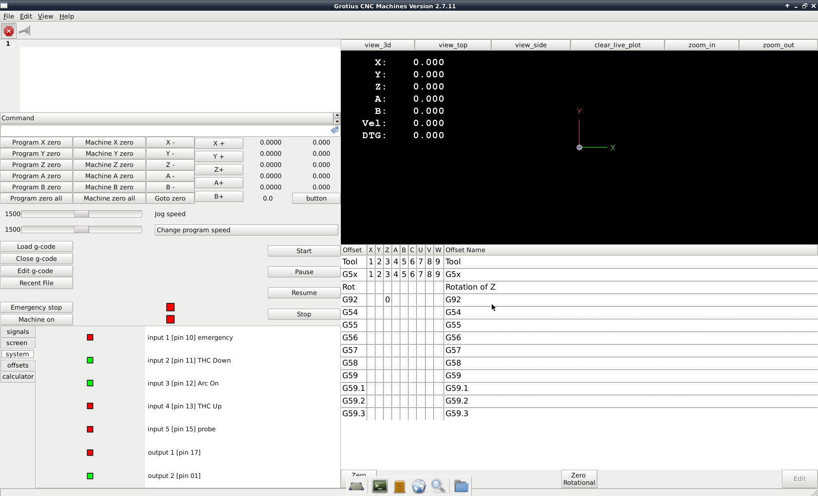

Hi Nerd here again,

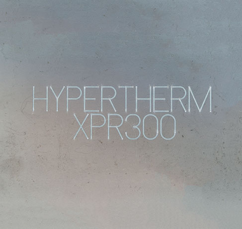

I have now a Hypertherm Powermax 45xp with cpc and serial interface in my shop for testing on Linuxcnc.
The most important issue to use this type of powermax is the metal marking option. This works very good. And my customers
use this option because of the CE qualification of their steel product's. All their pieces must be coded to get the CE qualification on
their output product.
So what i want to realise are 2 important things.
1. Connect the stand alone linuxcnc application to a proma thc and use the 3 input signal's from the proma thc to
move the z-axis up and down. So this configuration i want to realise first.
2. Connect the stand alone linuxcnc application to the hypertherm powermax serial interface. Then i can read and set all the available hypertherm value's. This connection make's plasma cutting to a next level.
Here i have attached the serial protocol. I have also the serial connection cable ordered with the powermax.
The first thing's i need to know is the best en simple way to manipulate the z-axis while cutting.
I read in serveral document's off Rodw it can be done with "External offset's" or with direct hal manipulation.
I found out that there a very complicated hal code's to use the proma thc.
Has someone a good advise to start with?

Michel, I don't know anything about the proma THC but they have a working Linuxcnc config on their web site. See
proma-elektronika.com/index.php/en/tips/plasma-thc-linuxcnc
Tommylight on this forum uses Proma a lot so he may be of help.
With regards serial communication, one option is to use a Mesa 7i76e with revised firmware that exposes the RS-422 UART used by Mesa's smart serial interface. See this thread
forum.linuxcnc.org/27-driver-boards/3328...i76e-with-uart#98948
Because Hypertherm uses a RS-485 4 wire interface, this should allow communication via the modbus protocol used by Hypertherm.
However, you will need to write a hal software component in C to access the 7i76e UART as there is no such driver in the Linuxcnc distribution.
I've not done anything with my plasma machine for some time due to lack of time.

Hi Rodw,
Nice to hear you. I hope you have a lucky year !!
This summer i was starting with Linux tutorials. Understanding Linux (python) programming is for me a very difficult thing to learn.
A few weeks ago i started again with learning jt tutorials. It takes many, many time to make things working and understand how it is working. Respect for the linux programmers.
At this moment i have the basic cnc item's working in a stand alone application. I have tried to simplyfie the python programming to
a python basic level. The screen layout is not finished at this moment, it is only for functional useage at this moment. Later in my project i finish the screen layout. This is when the THC funtions are done.
For now it's important to make the THC software working, starting with the Proma THC on a standard break out board.
When this is working i can alway's look at the mesa card's and other possibilities in the future.
Also i want to communicate with the Hypertherm with the Modbuss system. So i want to look if this can be done with the
standard com1 port on the pc.
The Toma thc program looks very difficult in the Hal section. So i am considering to modify this pyvcp layout into a stand alone application with the layout made in Glade. This hopely takes a few evenings to do. Then it's working good, but in my opinion to complex build.

I have written, very basic python component to communicate with hyperterm 85 it is working.
as I say it is very basic but works well to set and get the pressure, current and mode
also Gets the errors.
I have tried it with a USB to rs485 converter.

@Grijalvap,
Wow....
The code is smaller then i thought, perfect !!!!
Many thanks, i will test this when order is delivered.
Wow i didn't expect this today !!
I am currently building a plasma inverter for my own company to sell with the machines.
It's like a Hypertherm Powermax, but then a little better and watercooled inverter. You can easely improve a Hypertherm concept by
placing the air valve at the torch head. Also the ingnition time out can be a little longer in time.
It needs a modbuss reciever with a few i/o. When this story with a hypertherm works, it wil work also with other modbuss
devices i think.
