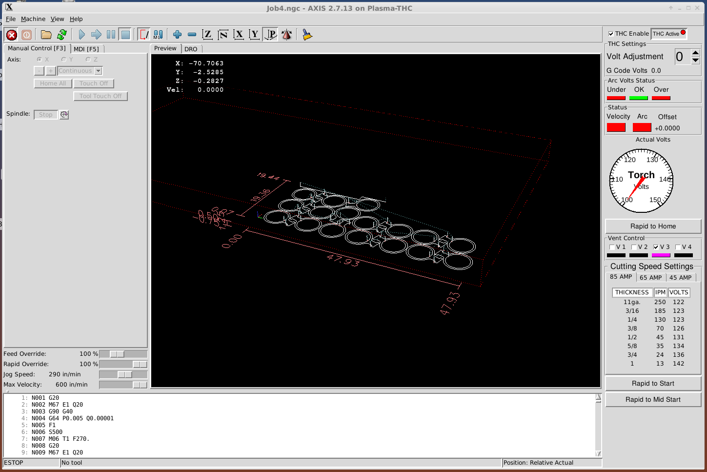

I'm setting up my post processor to activate and deactivate the THC throughout the Gcode file.
I am considering to use M64 and M65.
In the documentation I read (M64 & M65 happen immediately as they are received by the motion controller. They are not synchronized with movement, and they will break blending.)
Will that affect my G64 P- <Q- > blending tolerances I set at the beginning of my file?
Must I program a G64 P- <Q- > after each M64 THC activation?
Thanks,
EW

16 May 2018 19:58 #110800
by EW_CNC
Replied by EW_CNC on topic Enable and Disable THC in Gcode
I used your suggestions, and did some cutting using M67 E1 Q20 THC on and M67 E1 Q10 THC off. I am using it with gcodehold.comp by rodw forum.linuxcnc.org/plasma-laser/32700-co...hc-from-within-gcode works as intended!
Now I have uncovered an existing problem that I already had previously. When my THC enables and disables it doesn't always remove the THC offsets. With it turning on and off many times throughout a file, the offset multiplies and gets worse.
When the THC turns off close to the end of the cut the torch rises to a high Z position to finish the cut. The first few cuts it appears to remove offsets at the beginning of the next cut when the torch is on and it moves to Z cutting height after piercing height, but then the offset (might be?) greater than the Z move and it doesn't remove the offset. It quickly multiplies. In the thc.comp component I noticed it shows the line "if(!torch_on){ // remove any offset". Does this mean it will only remove offsets with the torch on?
To remove an offset, does the THC need a Z move with the torch on?
Do I have a problem with my g code torch touchoff?
I am using Hypertherm Powermax 85 with THCAD to control torch height.
EW
EW

17 May 2018 15:44 #110819
by EW_CNC
John,
I used your input and added the delay G4 P0.2 after torch off with THC on. It solved my problem! This morning I cut a job with over 70 cuts and it always removed the offsets.
At this point I am not ready to tackle a newer setup, because I don't have the programing knowledge that you have. I will keep tabs on the work with plasma that you and rodw and others are doing. I appreciate your time and effort!
My plasma setup is fairly basic and is working ok, but there is always room for improvement. Some of the changes I just made recently are;
I changed the THC Z direction indicators using rodw's showzdir.comp forum.linuxcnc.org/plasma-laser/32657-th...-indicator-component. Thanks.
I added a M68 to read the Volt settings from Gcode, and added an offset to adjust the THC Voltage + or - from the Gcode setting.
Now I also added the M67 to enable and disable the THC from Gcode.
My configuration files are attached.
EW
EW
