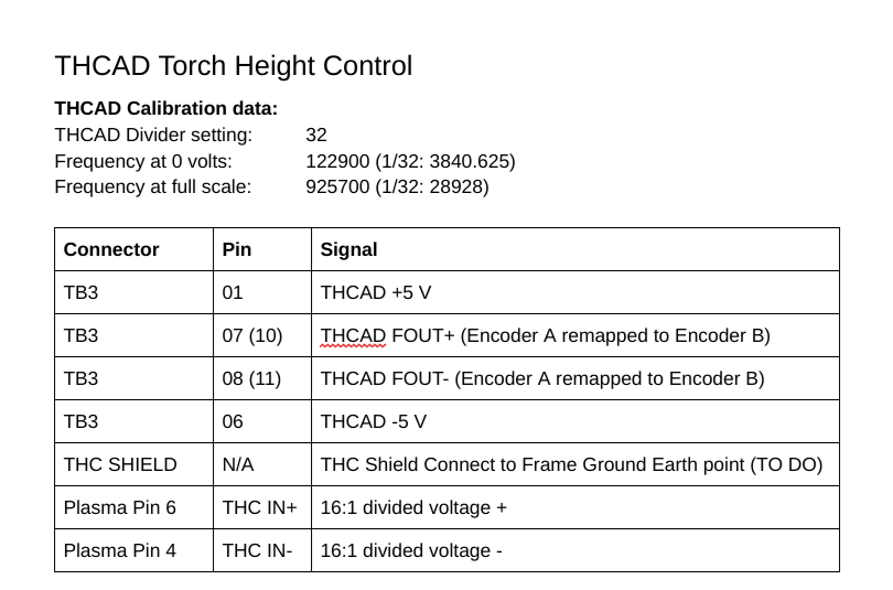

27 Mar 2019 15:44 #129795
Replied by rodw on topic THCAD-10
Here is a screen shot of my pinouts for the 7i76e for the wiring of the THCAD. Yours should be similar Note that my system is non standard as I blew something up and PCW wrote me new firmware that mapped the Encoder B to Encoder A so ignore the numbers in brackets
Set the THCAD link to be 1/32
So once again halshow will be your friend. With the 9 volt battery connected, you should first check the encoder pins and one of them should be close to 90% of the 1/32 frequency based on your calibration data. Then it is a matter of scaling the reading back to a voltage reading. You can do this using standard hall components, but I wrote a component to do it, If you look through this section, you will find it.

Hi Rod
I have all the physical connections complete. Its the code in hal that is causing me issues
