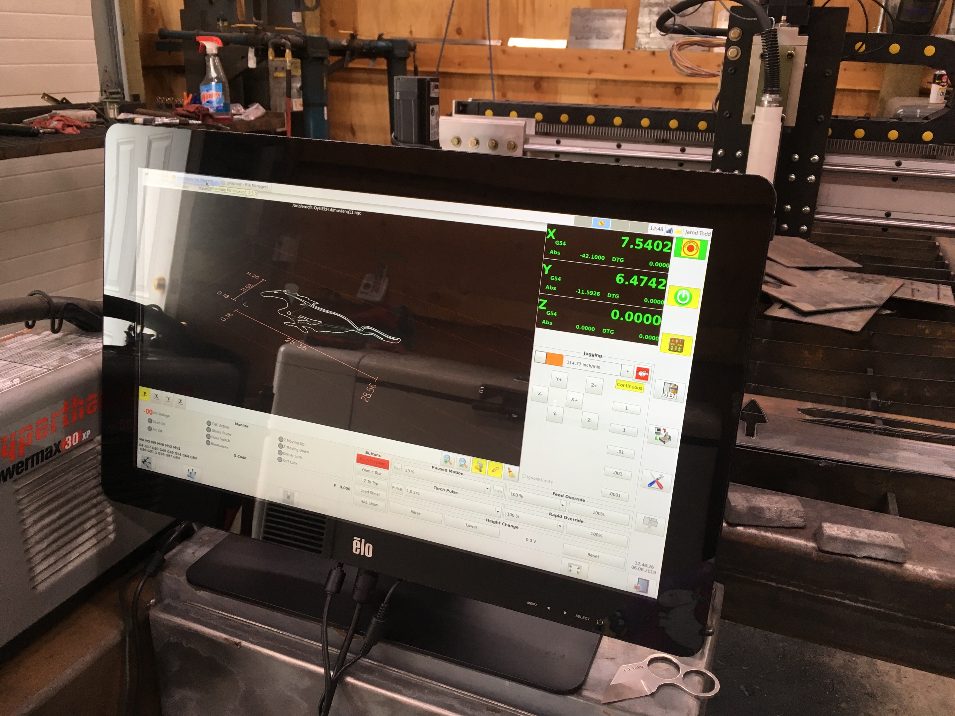

I am in search for a monitor for my plasma. I'm also very frustrated with using a keyboard and mouse (tiny touch pad on key board). I am wanting to upgrade to a touch screen but i know there are some frustrations i came across with using them or trying to get them to connect. I was wanting Elo brand as thy seam to be sealed rather well and would handle a shop environment. i had also considered getting the glass zero bezel version. Any of you guys use a touch screen or have advise on what i should get? Thanks

06 Jun 2019 09:09 #136024
by JTknives
Replied by JTknives on topic Monitor for plasma
I bought a 22” Elo 2201L wife screen touch monitor. It should be delivered tomarow. Is there anything I should know about interfacing this display with Linux?

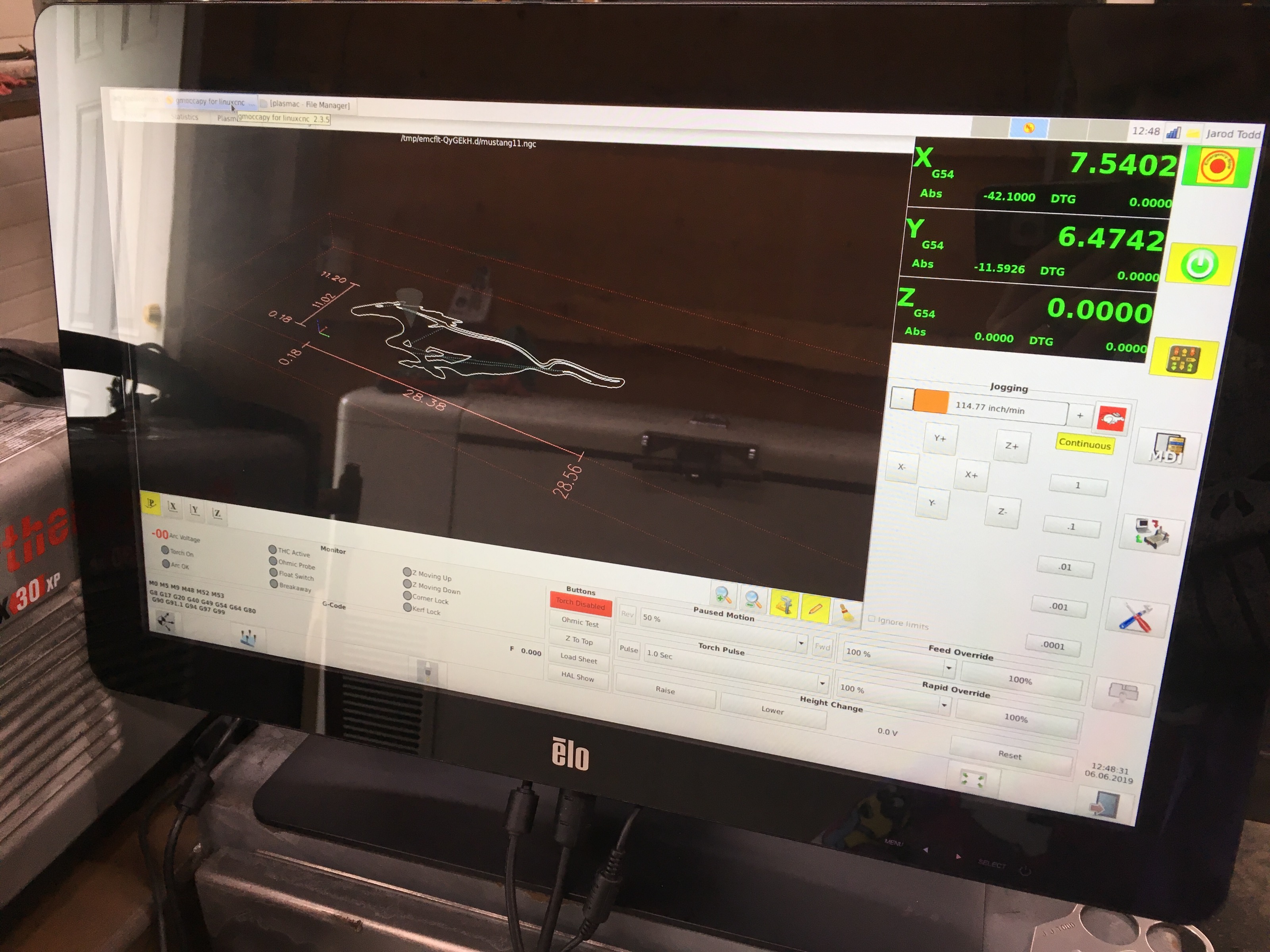

06 Jun 2019 20:00 #136084
by JTknives
It ran right out of the box. No calibration or anything, just perfect in every way. I could not be happier and the larger 22” wide screen fits the GUI much better. Thanks guys - JT

07 Jun 2019 07:14 #136178
Replied by rodw on topic Monitor for plasma
Just curious. How usable do you find the 16:9 screen with Gmocappy?
I don't like it myself and rarely run it full screen.

07 Jun 2019 07:53 - 07 Jun 2019 07:54 #136181
by phillc54
Replied by phillc54 on topic Monitor for plasma
I reckon a display that size and aspect ratio would be a good candidate for having the plasma run tab reworked and put on permanent display on the left hand side.
Maybe I should revisit that as an option...
Cheers, Phill.
