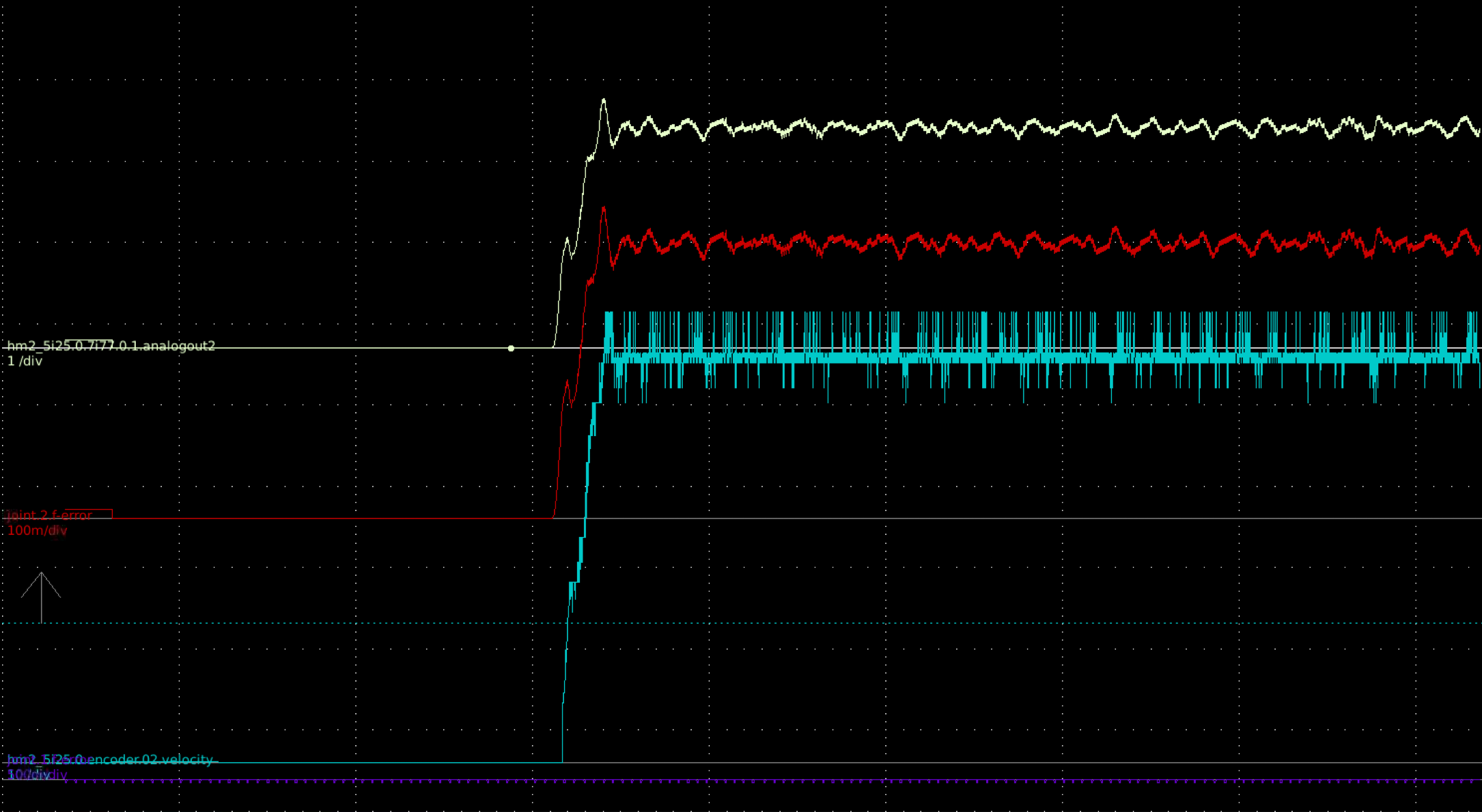

Hard to tell if this is a noise issue or a tuning issue
Can you post your hal/ini files?
- alex.statie
- Posts: 19
25 Mar 2020 10:18 #161411
by alex.statie
Replied by alex.statie on topic PID tuning for LS Mecapion setup with MESA 7i77
Attached.
The "problem" is on Axis Y - joint 2
Thank you!
Thank you!

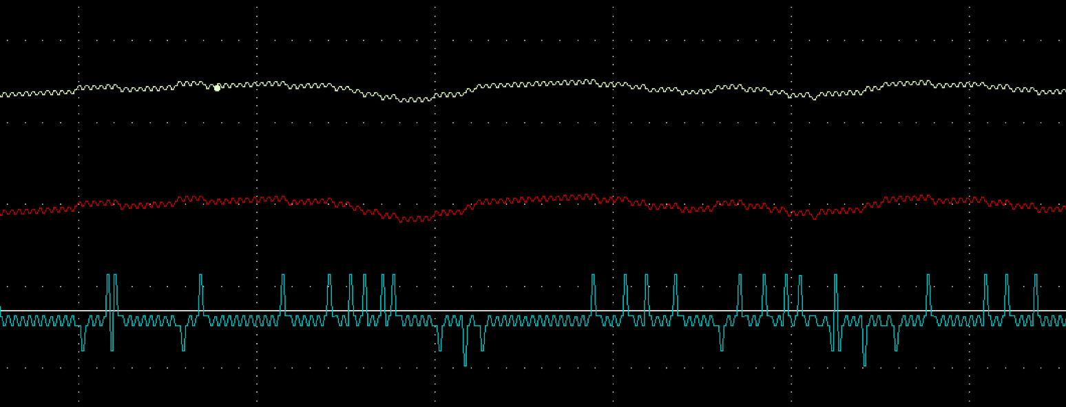

Just to test whether this is a noise issue, can you set the encoder sample frequency to 1 MHZ (1000,000)
Note that if the drives are in velocity mode, FF1 does 99% of the tuning

Could you please give me just a bit more info on how to do that?
Should i create a new thread with higher frequency and assign the halscope to that thread?
- Posts: 17976
- Thank you received: 5275
25 Mar 2020 14:12 #161431
Replied by PCW on topic PID tuning for LS Mecapion setup with MESA 7i77
setp hm2_5i25.0.encoder.muxed-sample-frequency 1000000

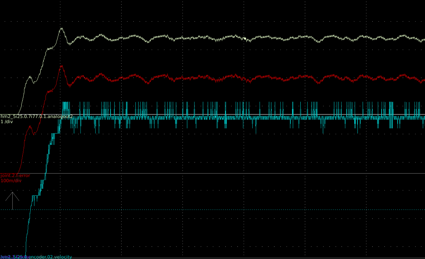

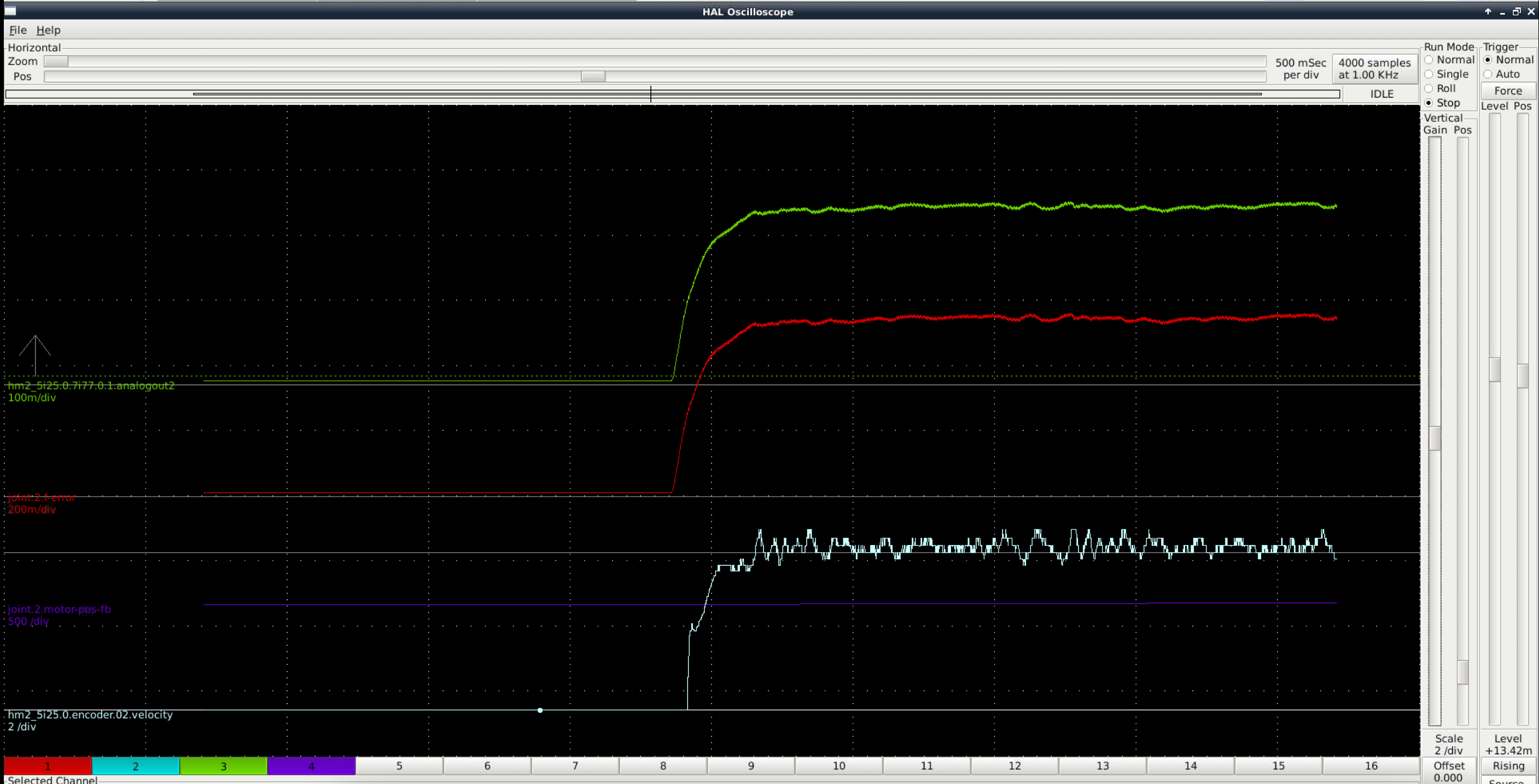

Can you lower the P term to say 0.5 to see if the noise is feedback related?
also including the complete halscope screen would help (so the time/div is visible)

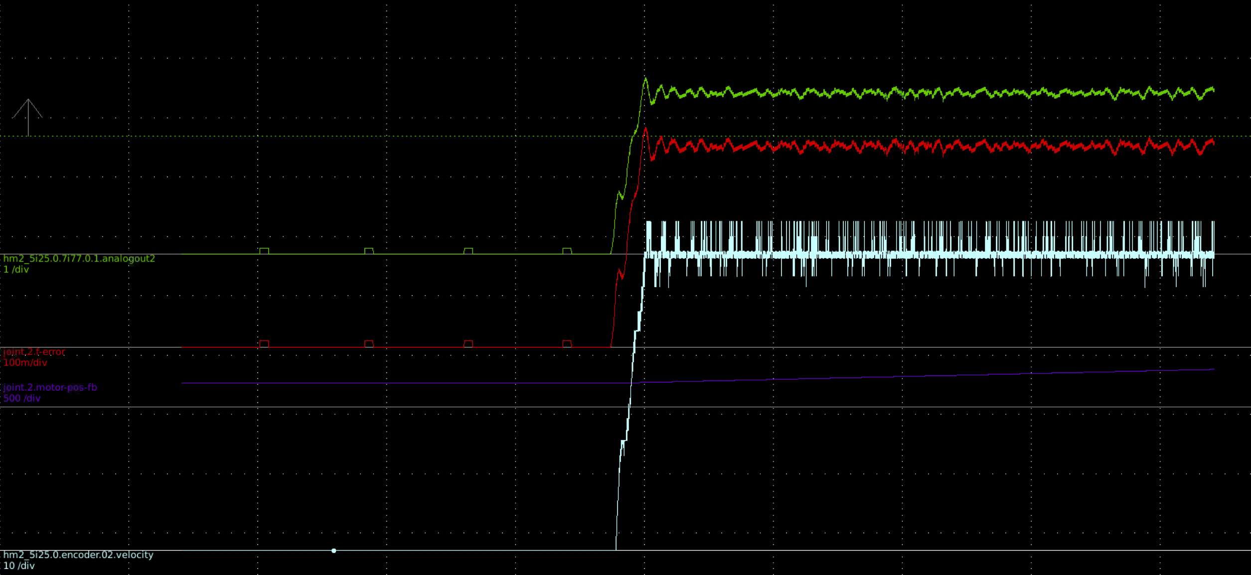

Note: you need to tune FF1 to lower the following error, this should be done at
a low P value
Use the calibrate menu and adjust FF1 so the following error is minimized
If error is in the same direction as the velocity (like the plot above) you have
too little FF1, If the error is in the opposite direction of the velocity, you have too
much FF1
This should allow you to get to the previous speed
