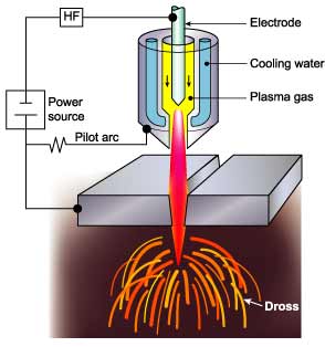

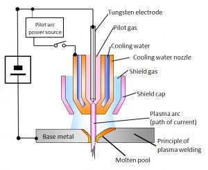

13 May 2020 09:21 #167633
Shielded torch, notice the power and pilot arc connections:
Un shielded torch, again notice the connections:
Replied by tommylight on topic ARC OK signal to activate IO pin
Quite the opposite, it will be on the nozzle.and with this solution i might be able to keep the nozzle longer as the arc will be on the plate and not on the nozzle.
The following user(s) said Thank You: rodw, jay1st
