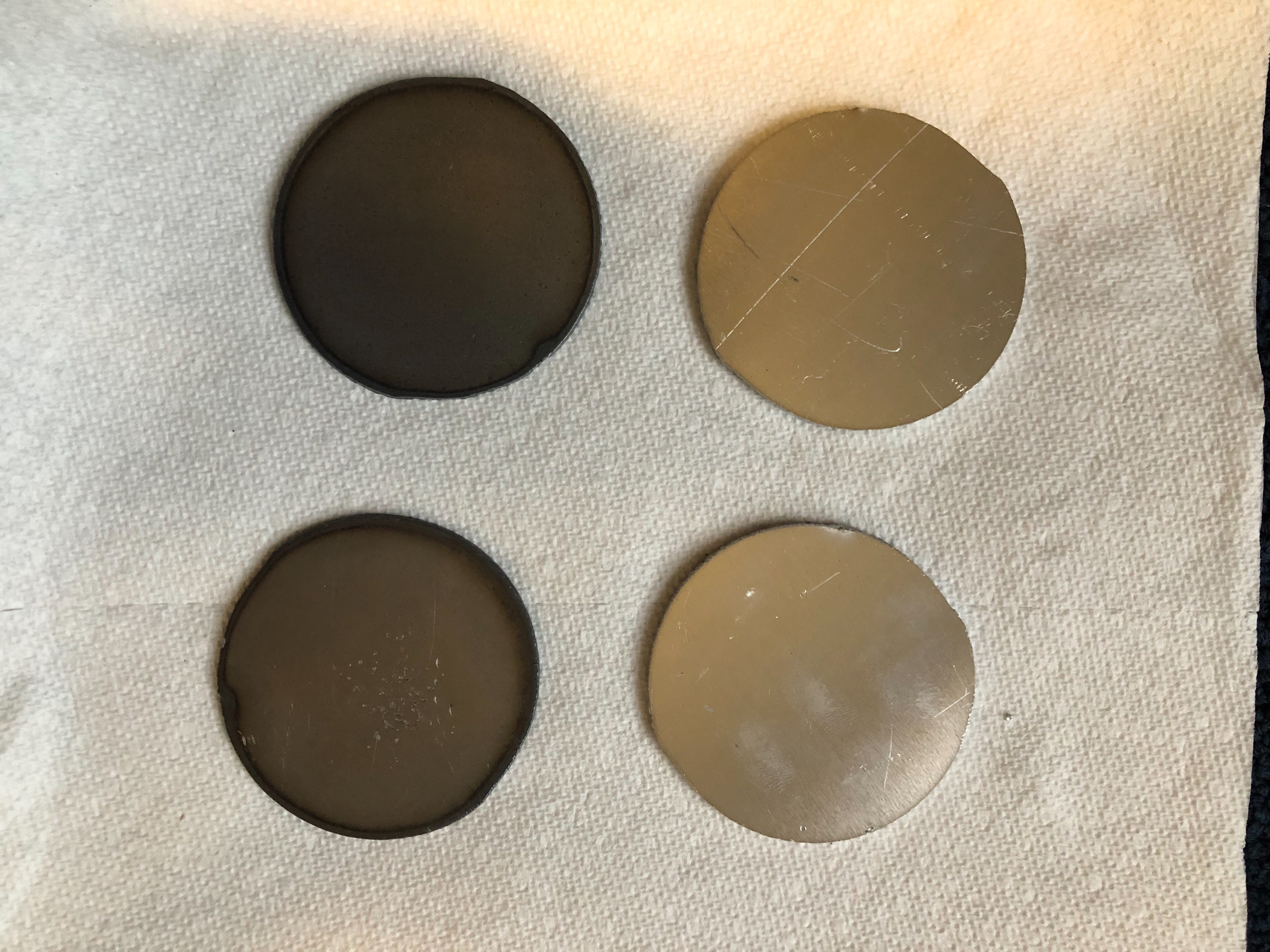

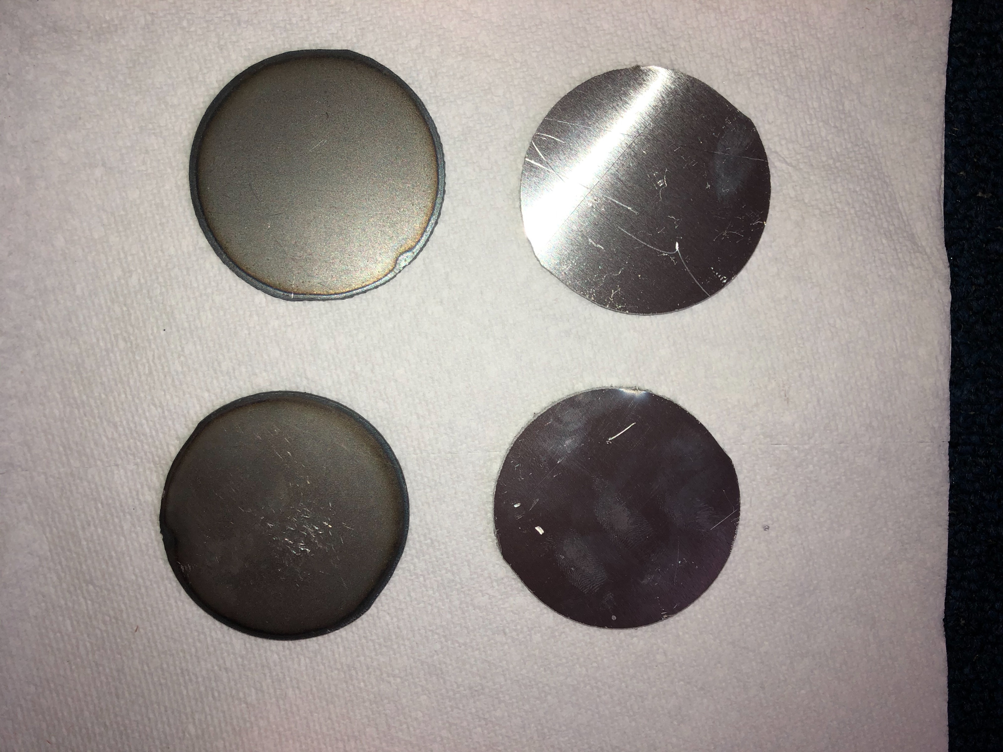

I’m still fine tuning my newly “finished” plasma. So I’ve only really been cutting lines and basic shapes. My machine seems to have problems with circles though, they don’t match up and there’s just some weird lines going on. But it cuts squares perfect, it’s square, and it scaling is perfect. Could the issue be the design software? I’m using librecad, then dxf2gcode

25 Sep 2020 08:25 #183692 by tommylight
Replied by tommylight on topic Cuts are not as designed
Pictures ?

25 Sep 2020 13:25 #183714 by tommylight
One of the axis has backlash of about 1mm.
And please upload the pictures here, not on external sites.

25 Sep 2020 13:28 #183715 by Aldenflorio
Replied by Aldenflorio on topic Cuts are not as designed
How do I find out which axis and how do I fix that?

25 Sep 2020 13:30 #183717 by tommylight
while the machine is powered on and the motors are locked, move each axis by hand, they should not move. Also check the pulleys as one of them might be loose.

25 Sep 2020 13:45 #183719 by Aldenflorio
It’s direct drive, so I have a gear rack and gears. I’ll check in a few hours. How would I fix that?
