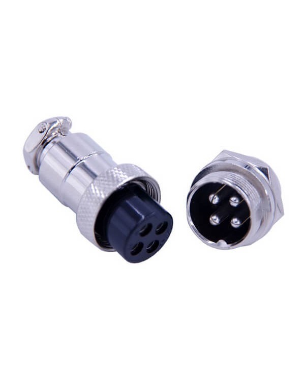

I used GX16 aviation microphone connectors so the motor could be removed easily. On some motors, I used a small piece of aluminium angle secured with the motor mounting bolts to hold the panel mount socket.
Where the wires come into the socket, mounted on the angle, did you use heat shrink?

Yes, sent me nuts doing that! I think I shrink wrapped each wire, then put a large piece around the whole cable. In some exposed areas, I covered the bare motor wires with some of that nylon mesh cable cover.
