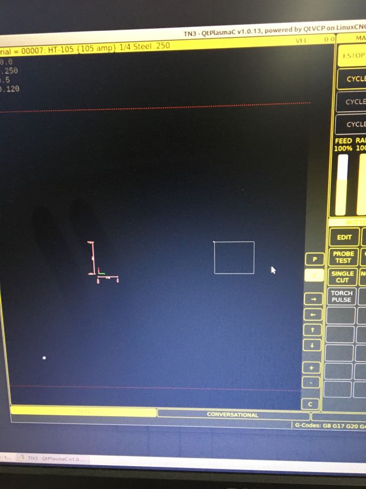

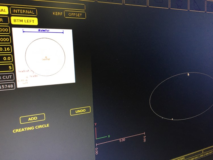

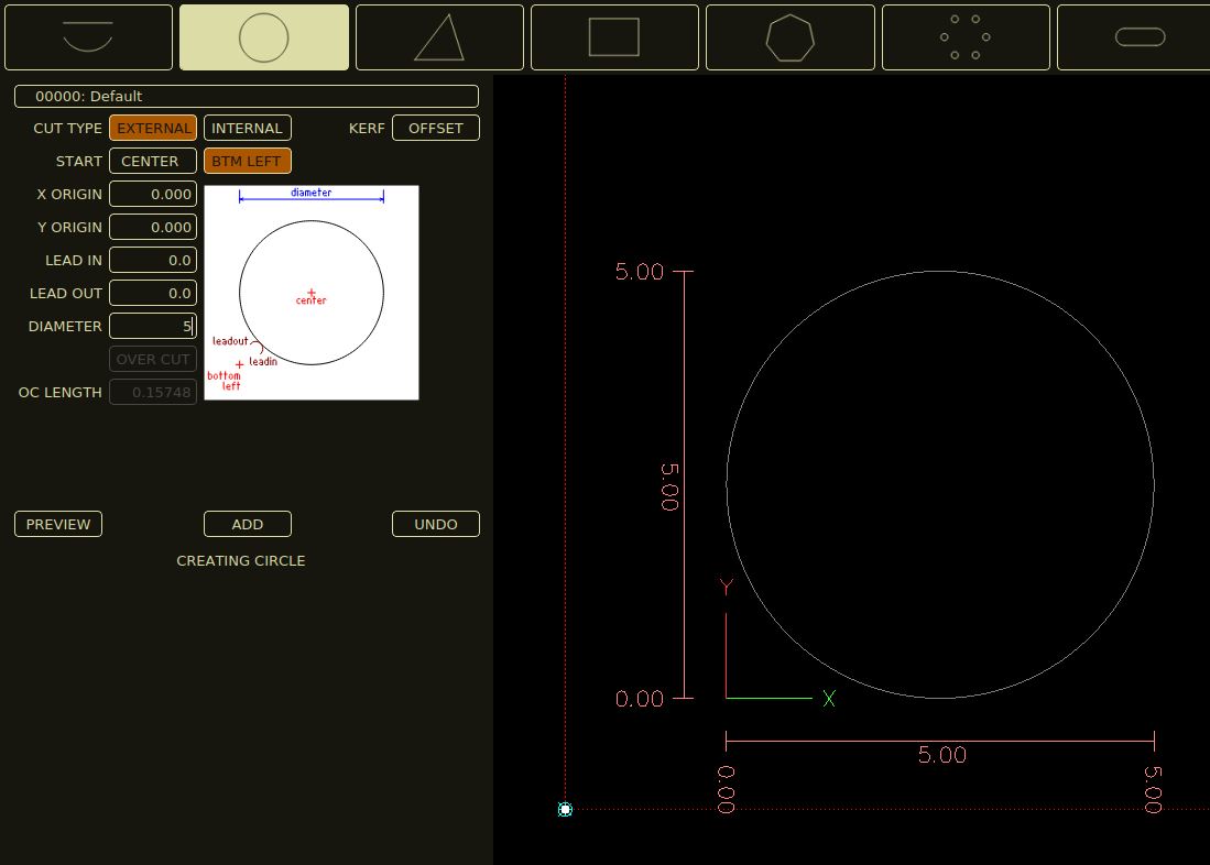

Replied by bevins on topic (Solved) QTPlasmac scaling issue
I put the OFFSET_AV_RATIO to 0,
Still has the same behaviour. I think the X is scaled.

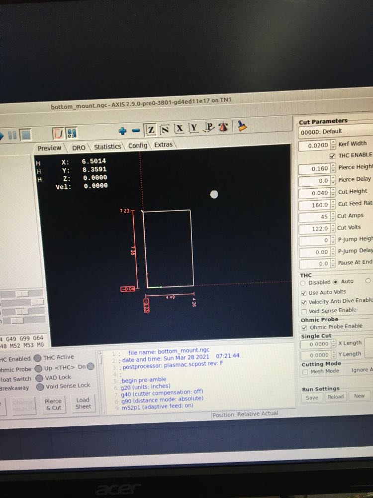

14 Apr 2021 02:45 - 14 Apr 2021 06:01 #205841
by phillc54
Replied by phillc54 on topic (Solved) QTPlasmac scaling issue
Try either commenting out this line in the .ini file
or changing it to:
forum.linuxcnc.org/21-axis/38334-2-8-0-p...ction?start=0#156597
GEOMETRY = xxyzor changing it to:
GEOMETRY = xyzforum.linuxcnc.org/21-axis/38334-2-8-0-p...ction?start=0#156597
