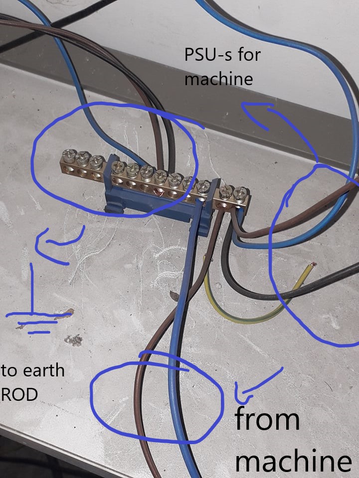

Star grounding to avoid ground loops is one.

Do everything in the attached. (Note better motors include a grounding point to attach the star ground wires.)
Add an RFI/EMI filter on the mains inlet
Use a quality industrial 24 volt power supply eg Meanwell etc

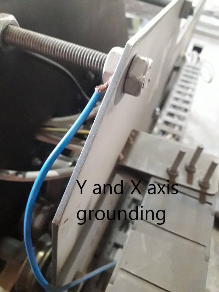

Make sure there is a grounding patch across all linear guides.
That should solve your problem.
The biggest source of noise I found was entering via the mains power earth so the EMI filter is critical.
EDIT: Also layout of your control panel is critical to keep mains power, motor power and logic power seperated.

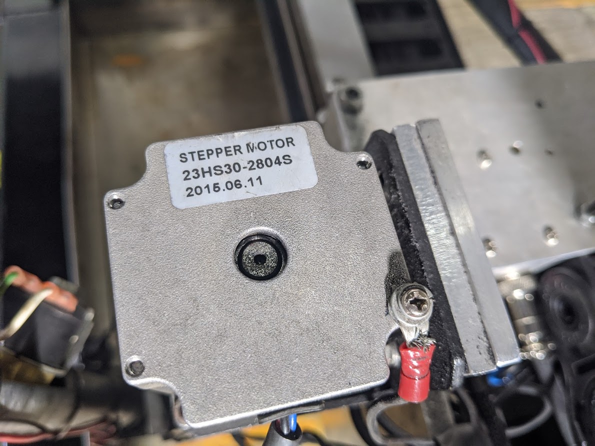

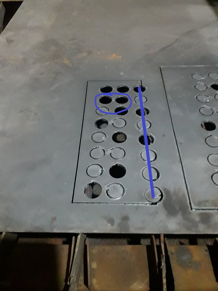

Thanks for you replies.

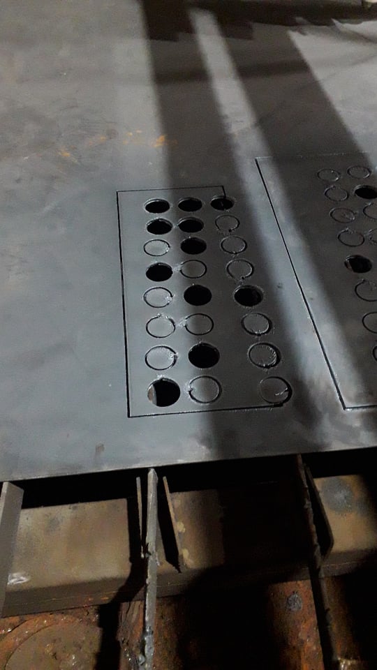

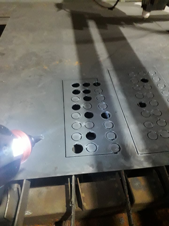

problems : Inaccurate cutting ,arc will start for pierce then stop for 1-2 mm then continue ,keyboard freezes , etc etc

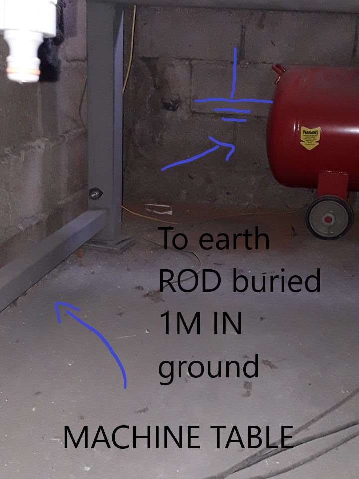

I Have seperate groundings : One for the plasma table , and one for pc and electronics.
Last edit: 30 Jul 2021 05:52 by shpatb.

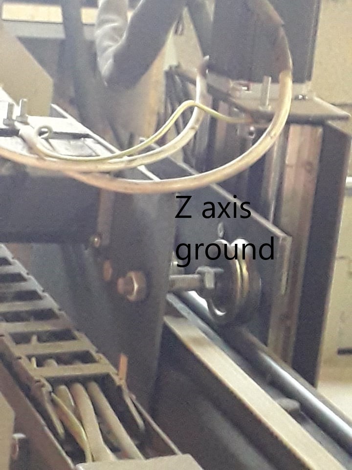

- shpatb
- Posts: 87
- Thank you received: 62
30 Jul 2021 10:05 #216331
by shpatb
Replied by shpatb on topic Ultimate guidance to avoid Electromagnetic
Thanks for reply Mr.Rod

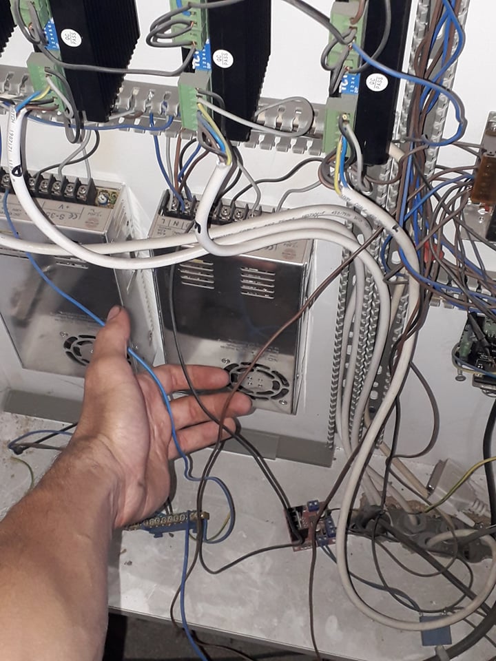

1.stahwerk cut 70 igbt
2.2x breakoutboards
3.3Nm stepper motors
4.36V DC
5.Act motor psu-s
4.latest plasmaC
Yes with torch disabled it runs perfectly . i have dual configs with mach 3 and PlasmaC , perfectly on both.
Attached some pictures to make it more clear.
regards Shpat
2.2x breakoutboards
4.36V DC
5.Act motor psu-s
4.latest plasmaC
regards Shpat

Replied by rodw on topic Ultimate guidance to avoid Electromagnetic Interference
Looks like its a HF start machine?
Lower voltage on the BOBs is not helping.
Make sure you use 24V with the mesa for greater noise immunity.
Move your PC away from the control box as the ethernet cable will add more isolation
Add a RFI filter to the mains power entering the control box.
Try and run your shielded stepper cables right to the stepper drive and ground the shield right there.
Try and earth to the motor across to your existing earths.
The following user(s) said Thank You: shpatb
