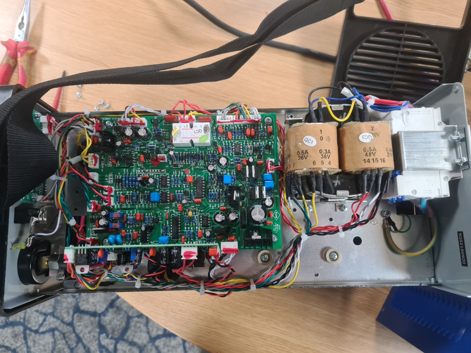

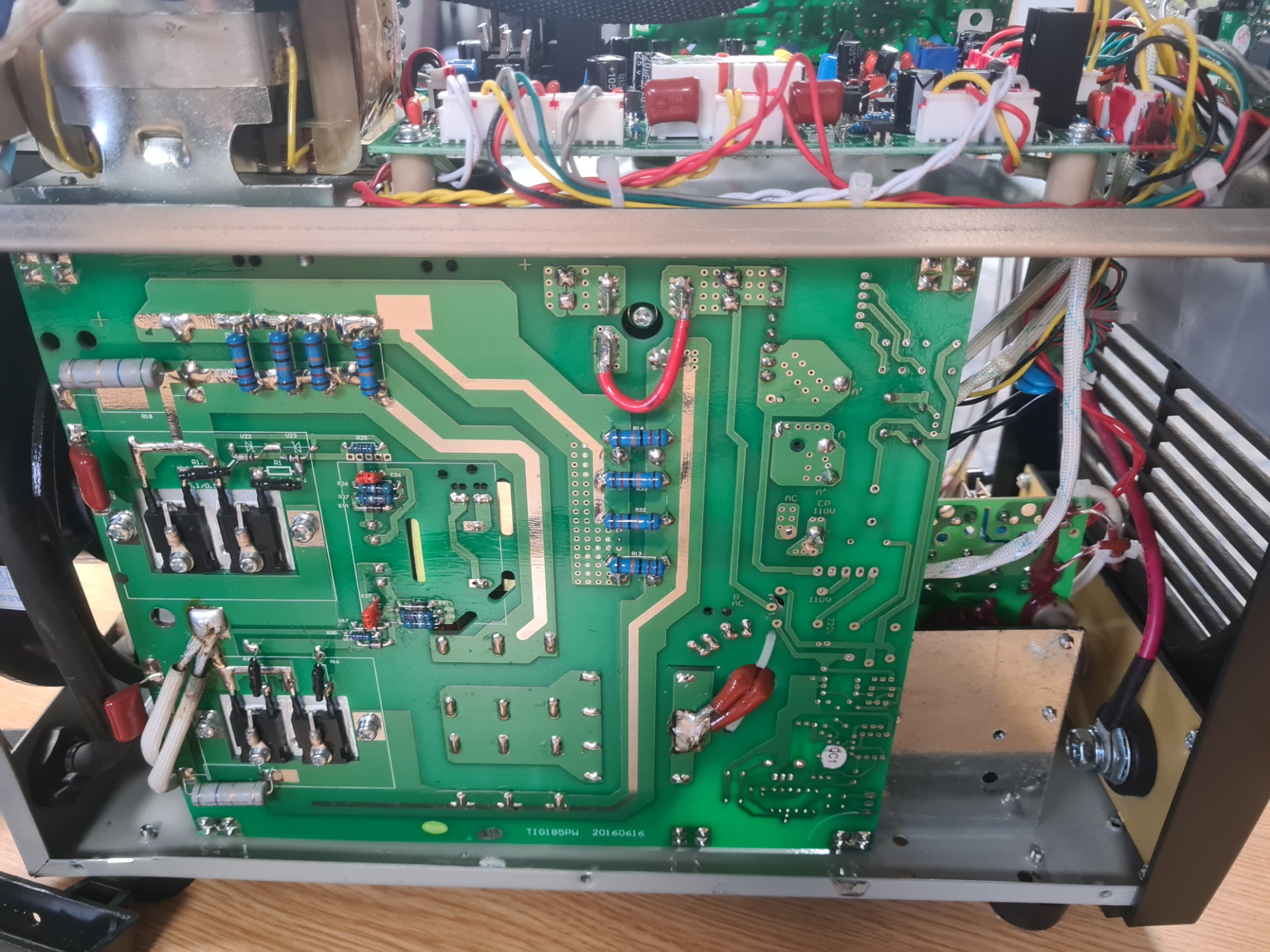

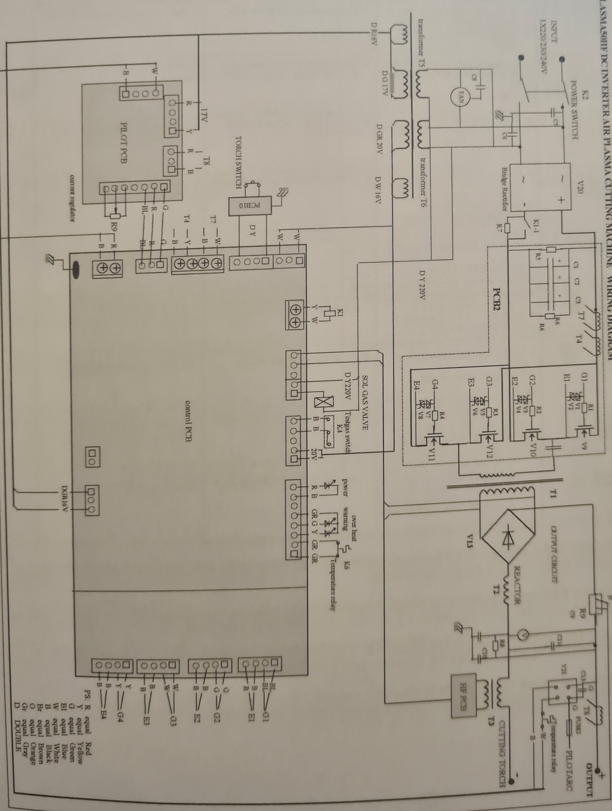

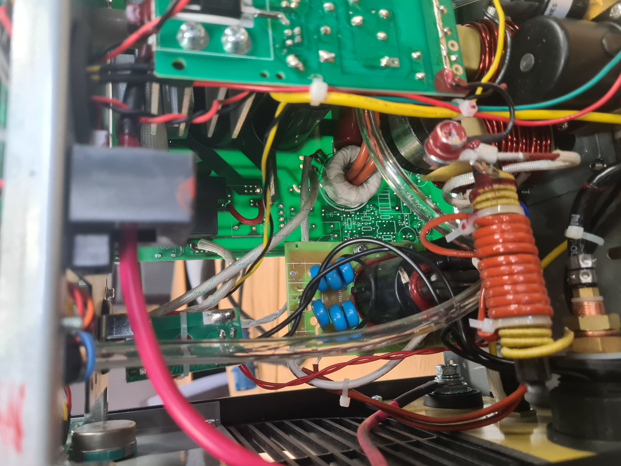

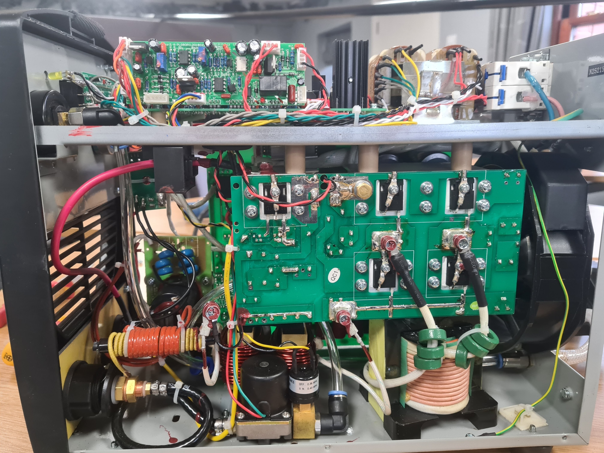

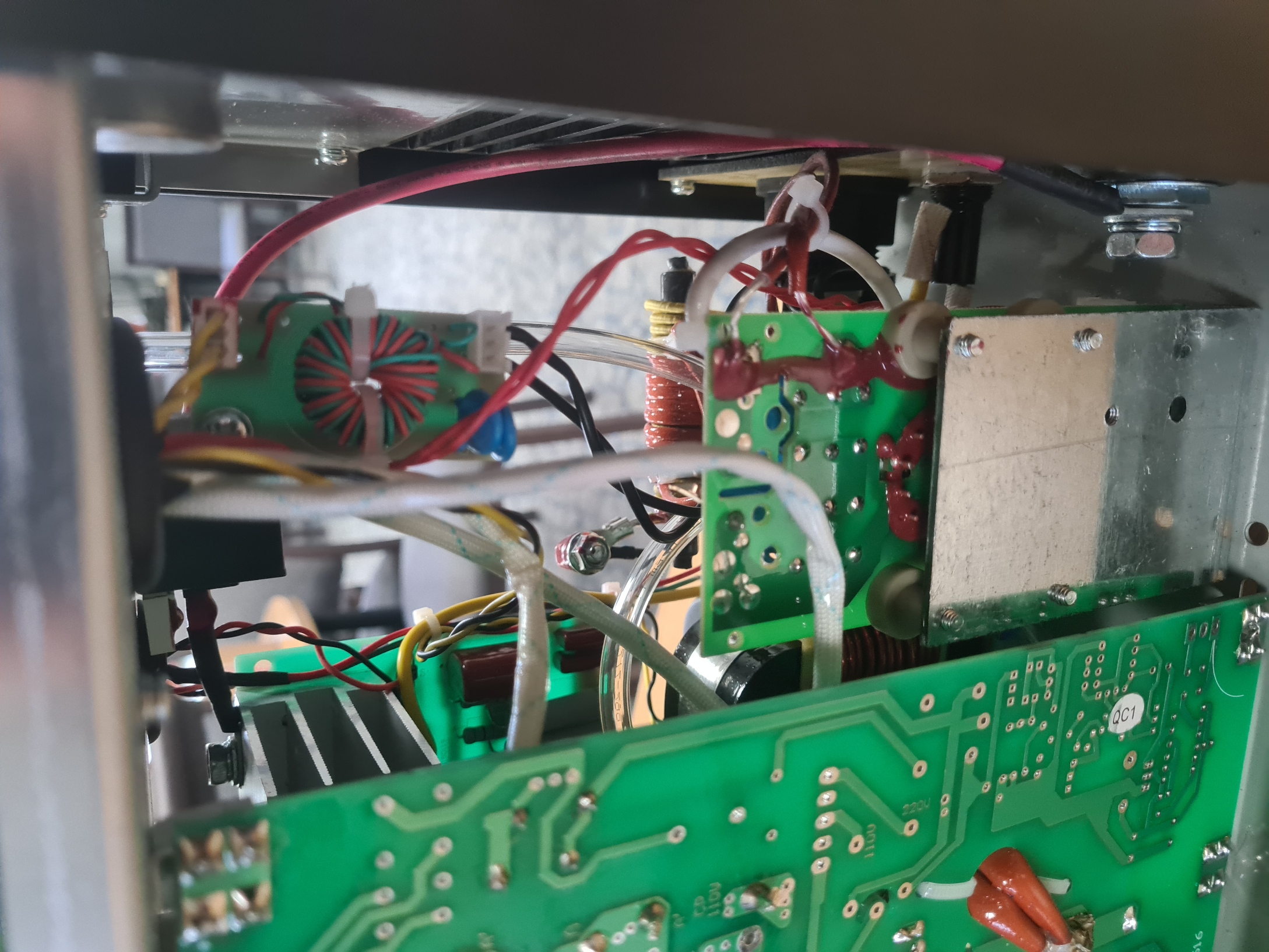

I have the P50HF plasma cutter from Rtech, which is working very well with my DIY table and PlasmaC. I currently have no THC and wish to use a mesa THCAD to do this. I know that I cannot connect the THCAD-300 across the output because of the HF / HV start, so I need to work out where inside the machine I might be able to do this. Attached are the supplied schematic and some photos of the inside of the machine if anyone is able to help - I am sure this might be of use to others as well. Many thanks in advance.
- Posts: 21880
- Thank you received: 7461
27 Dec 2021 11:16 #230058
Replied by tommylight on topic Rtech P50HF with THCAD-300
The circle with V in it, that is where the THCAD should be wired.

27 Dec 2021 18:06 #230072
by Howlingg
Replied by Howlingg on topic Rtech P50HF with THCAD-300
Many thanks for the quick reply - I should have seen that!!
Just to clarify, I can identify T2 and T3 easily, but not R8, C10 and C11, can I take the connection anywhere between T2 and T3, and then measure to the output line or is it critical exactly where? Thanks again

27 Dec 2021 19:57 #230081
Yes.

01 Jan 2022 15:47 #230458
by Howlingg

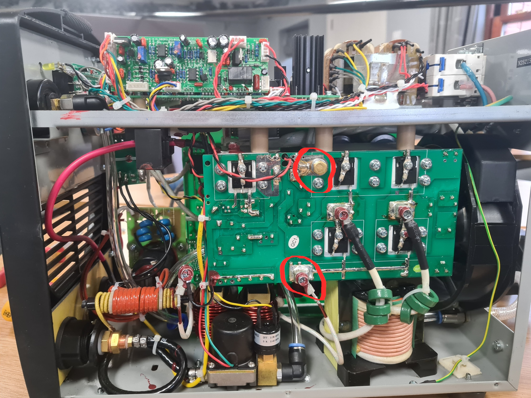

I have connected a multimeter between the ground clamp output and the point between T2 and T3 as above (on the right hand end of the yellow coil in photo 4 above, where the nut has been painted with red).
I used a cheap multimeter just in case!
Measuring high range DC (600v) , there is a flash from within the meter as the pilot fires, which I guess implies there is still HV present at this point. I am reluctant to install my THCAD-300 until I am certain I will not fry it.
Are you able to offer any further advice?
Many thanks

07 Feb 2022 19:48 #234279
by Howlingg
It's been a while until I had time to try this - but it works perfectly, Many thanks
