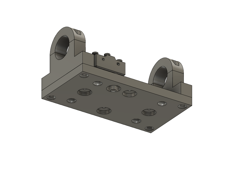

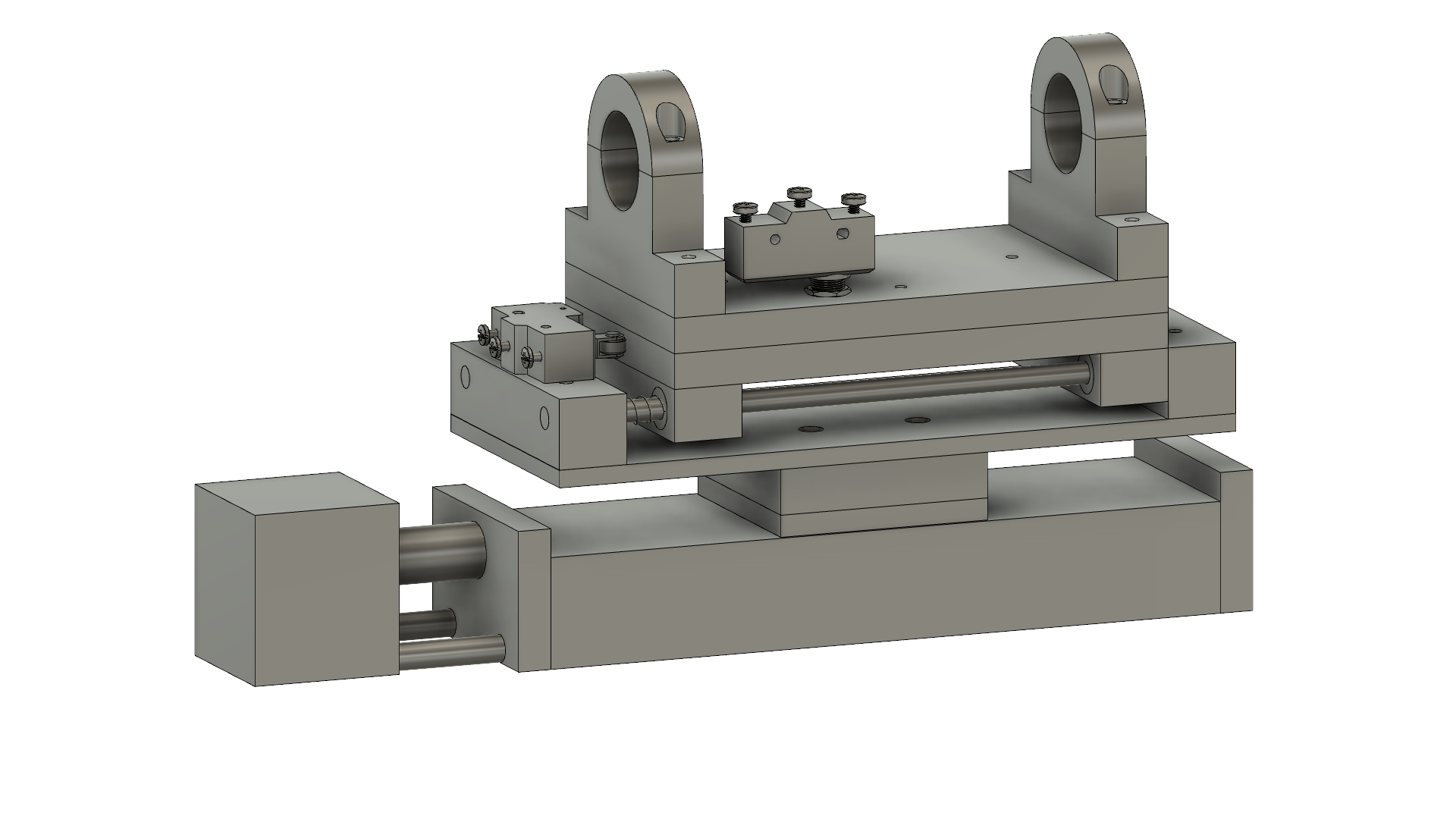

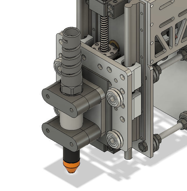

I'm designing a LinuxCNC 5'x5' plasma table and modeled up my torch carrier in Fusion. The design has 8mm linear bearings to allow the torch mount to slide up and make contact on the roller limit switch for material sensing. I've also designed in a magnetic breakaway for the torch holder. Attached are 3D renders of the back plate, breakaway plate and the entire Z-axis assembly.

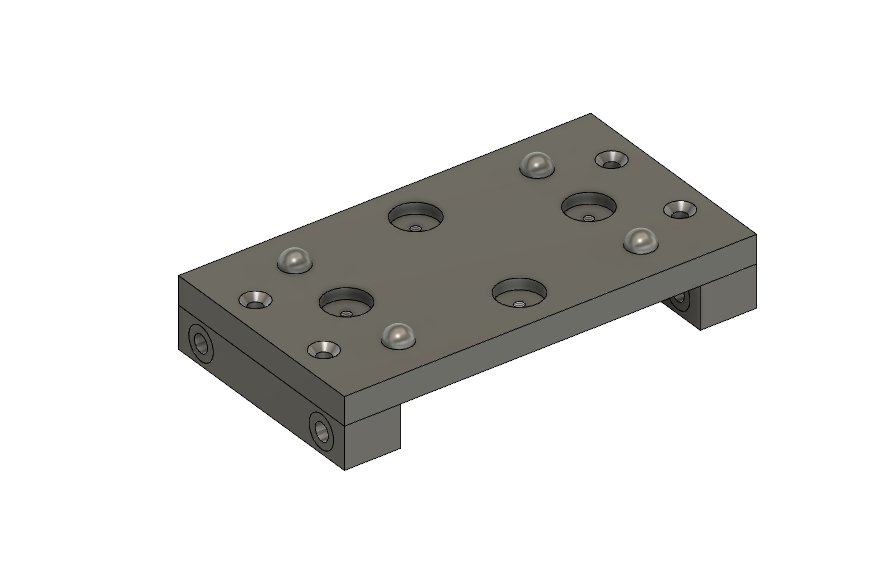

The breakaway torch holder and the back plate will be indexed on .5" ball bearings mounted in the back plate as shown. I've allowed for up to 4 pairs of opposing magnets (on both the back plate and breakaway). If I find 4 pairs is too strong to allow the torch to breakaway appropriately, I can try 3 or even 2 pair.I have a plunger limit switch mounted through the breakaway plate and contacting on the back plate to signal when the torch breaks away and trigger an Estop.
All the assembly components will all be milled out of aluminum.
In the 3D model you can see how it mounts on the Z-axis gantry which is an OpenBuilds C-beam 20x80 aluminum extrusion linear actuator. That gantry plate on the actuator is only 3"x3" and is leadscrew driven. The Z axis actuator is rated for 26 lbs force. I'm hoping the weight of this assembly (which is a total of 10" long) doesn't put so much moment arm stress on that gantry plate in high acceleration movements. Fingers crossed.
Please feel free to reply with any suggestions for improvement or any problems you see in this design.

No eBay APP ID and/or Cert ID defined in Kunena configurationYou might find three balls to be more stable (like the three-legged milking stool).
Also, possibly make the mating part as a groove, so that they can all settle in to a repeatable position (basically somewhat like a touch-probe)
For the carrier rail I have long thought that a (second hand) guided pneumatic cylinder might be a good starting point. Then you can regulate the spring rate (and even vary it during the phases of cutting). They also generally have limit-switch mounting built-in.

If the three grooves are at 120 degrees to each other (actually, as long as they are at three different angles) then it is perfectly constrained, but not over-constrained.
The grooves do not need to be very long. Maybe only a couple of mm. Just enough so that there is enough wiggle-room for all 6 flat sides to touch their ball.

Ok yeah now I get it. That makes total sense. Duh! Probably a lot less sensitive to how well I press the balls into their undersized holes and/or machine the dimples to match. To not have any play that was going to need to be precise and I was a little worried about how that might go. It also explains your 3 ball vs 4 ball suggestion a great deal.

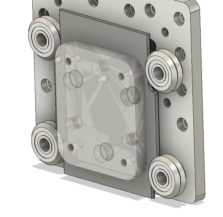

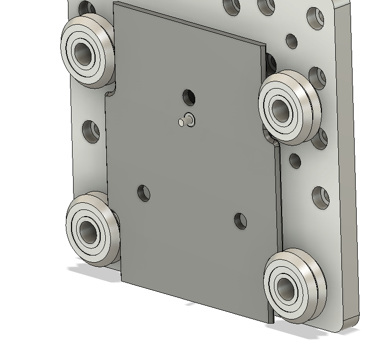

Here's a design I made that's cheap, been working well for 4 years and >200k pierces with no accidental activations.
Holes in slider can be easily adjusted (chamfer, size) for an appropriate break-away force in all directions. I found that to get a good 'feel', the balls should be buried about 1/3 the diameter of the ball when the magnets are touching the slider plate and slightly chamfered.
The dimensions are also important - the distance between the magnets top to bottom should be fairly short, otherwise you wind up with much stiffer break-away force front to back than rotationally. The torch should have quite a lot of leverage.
Hope it helps.
-Ralph
- Z-plate is aluminum, and there are 4/ea V-bearings mounted to it.
- Two of the bearings are on eccentrics so they can tension the slider.
- Float switch mounted on Z-plate, triggered by slider
- Slider is a piece of 1/8" steel plate
- Edges are beveled/rounded and is captured by the V-bearings
- 3 holes drilled in it to locate the bearing balls on the carrier plate
- Microswitch (post-type), NC, triggered by the carrier plate being in place. Switch wires are routed through the Z-plate and up the back.
- Carrier plate is aluminum and has
- 3/ea 3/8" bearing balls pressed in to undersized flat-bottom holes. Holes are just deep enoughso the ball stick out a bit - CAD helps here.
- 3/ea 1/2"x1/4 magnets pressed & epoxied in
