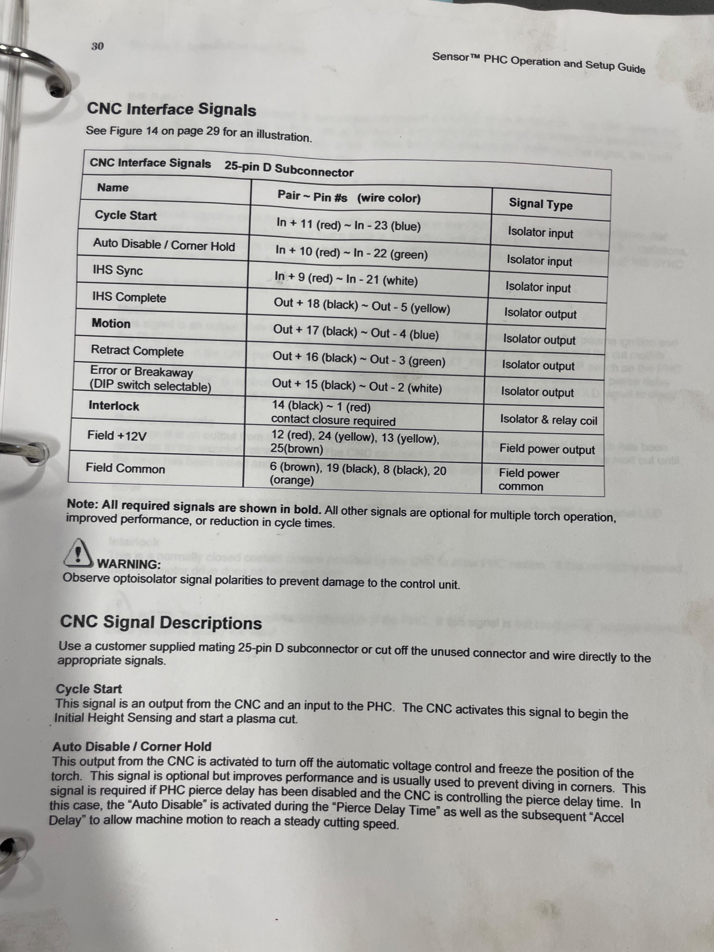

I hesitate to even ask about anything that’s not a mesa thcad, but I’m going to anyway.
Im trying to get an arc ok signal from a hypertherm thc to a mesa 7i97t.
The thc uses a 25 pin d connector. Arc ok(motion according to the thc manual) uses pin 17 + and pin 4 -.
I originally connected pin17+ to my power supply common and pin4- to tb4 pin4 on the 7197t. Tb4 pin6 is connected to v24+ on the power supply.
After a lot of unsuccessful testing, I realized I mixed up my positive and negative.
So I swapped pin17 and pin4, but that didn’t help.
I also tried throwing a relay in, but that didn’t help either.
Now I’m wondering if it’s possible I damaged something with my incorrect wiring.
I know you guys probably aren’t familiar with the thc, so I attached what I think is the relevant part of the manual.
It a hypertherm sensor phc. I’m planning on hitting up hypertherm tomorrow to see what they say.

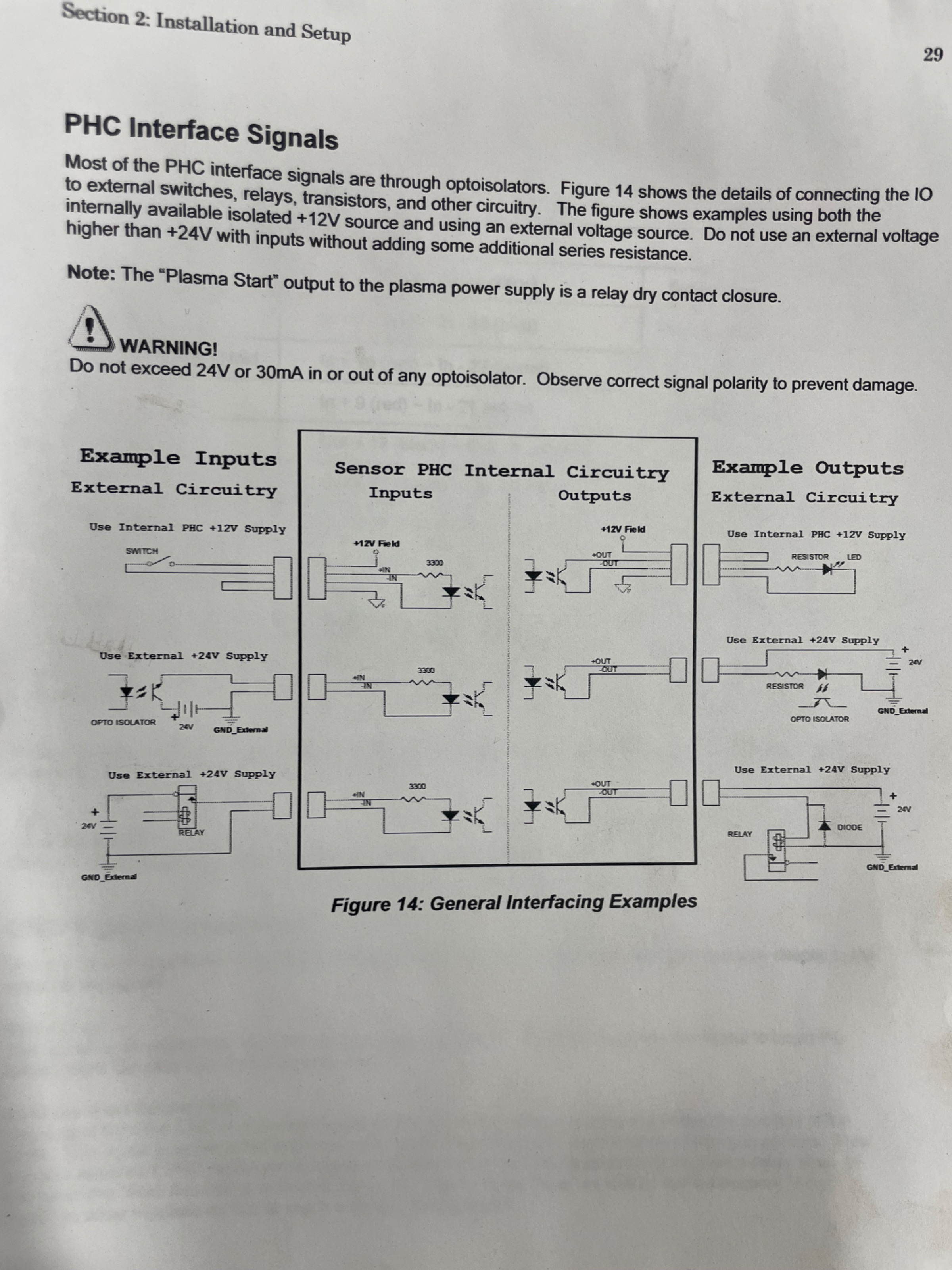

From their diagram it looks like the output is switching on the negative side.
If the 7i97 is expecting a positive input, this will not work. I don't know the card but I am sure PCW will guide you.
A relay may be required to send +24v to the input. example bottom right.

I just tried what I think is the top right example without any impact.
I put a jumper between pin 17(thc)and pin 25(thc field +12v) on the thc connection.
then I ran pin 4 (thc) to tb4 pin12(7i97t).
and pin 20(thc field common) to tb4 pin 11.
Is there an easy trick to get arc ok signals without having the arc going?
It was hooked up to a hypertherm hsd 130, but I hooked up a thermal dynamics a60 just to make sure the plasma was actually sending the signal.

The 7I97 input will work with either input polarity
You should not be able to damage the THC output
as long as you do not wire it directly to power.
The 7I97 input will only put a ~4 ma load on a 24V signal
so as long as the wiring includes the 7I97 input pin pair
in series, there should be no way to damage the THCs
optocoupler outputs.

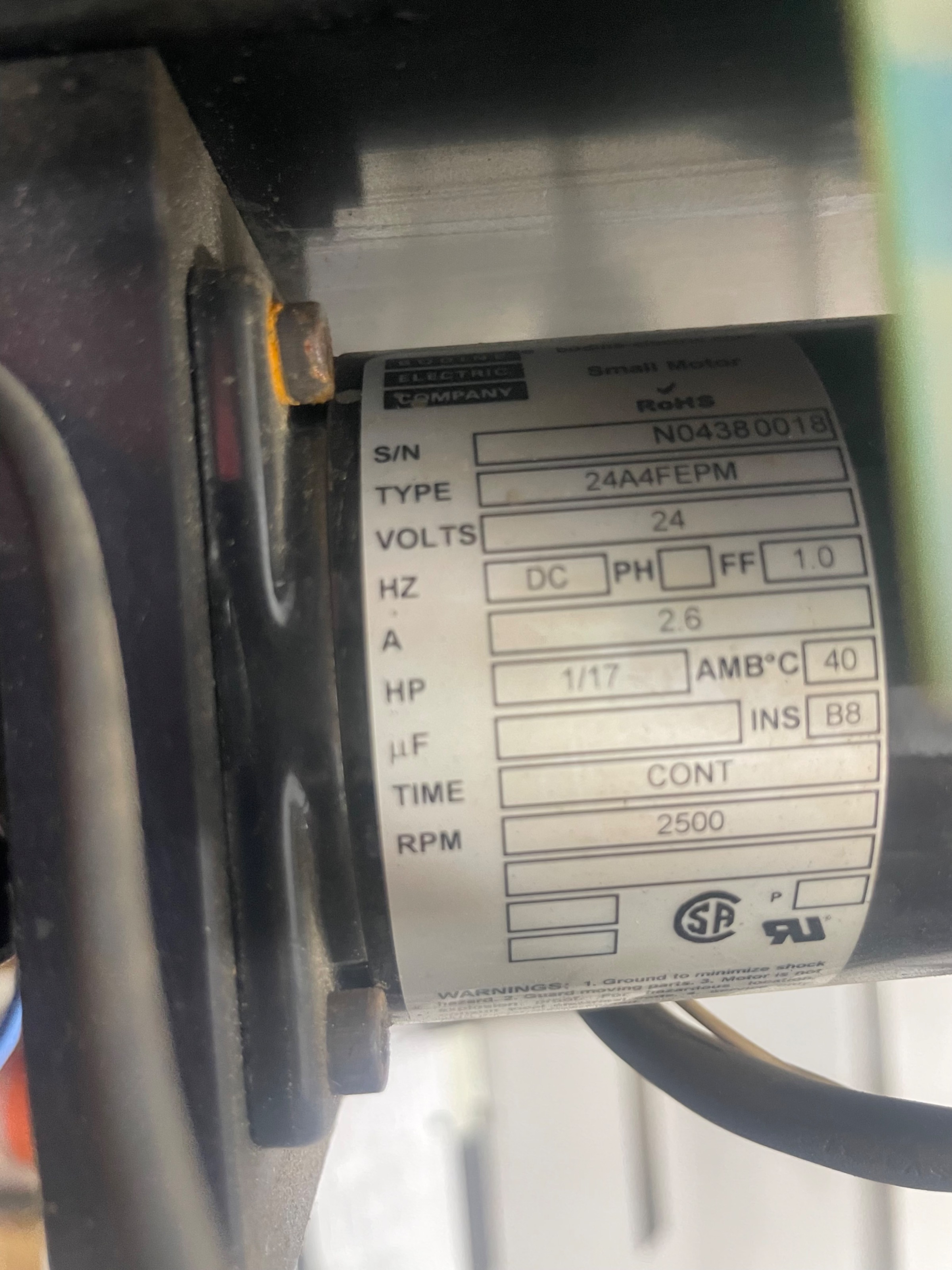

What are the voltage and current ratings of the existing DC motor on the Z axis?

04 Sep 2024 05:38 #309330
by bentiggin
Replied by bentiggin on topic Did I fry my thc?

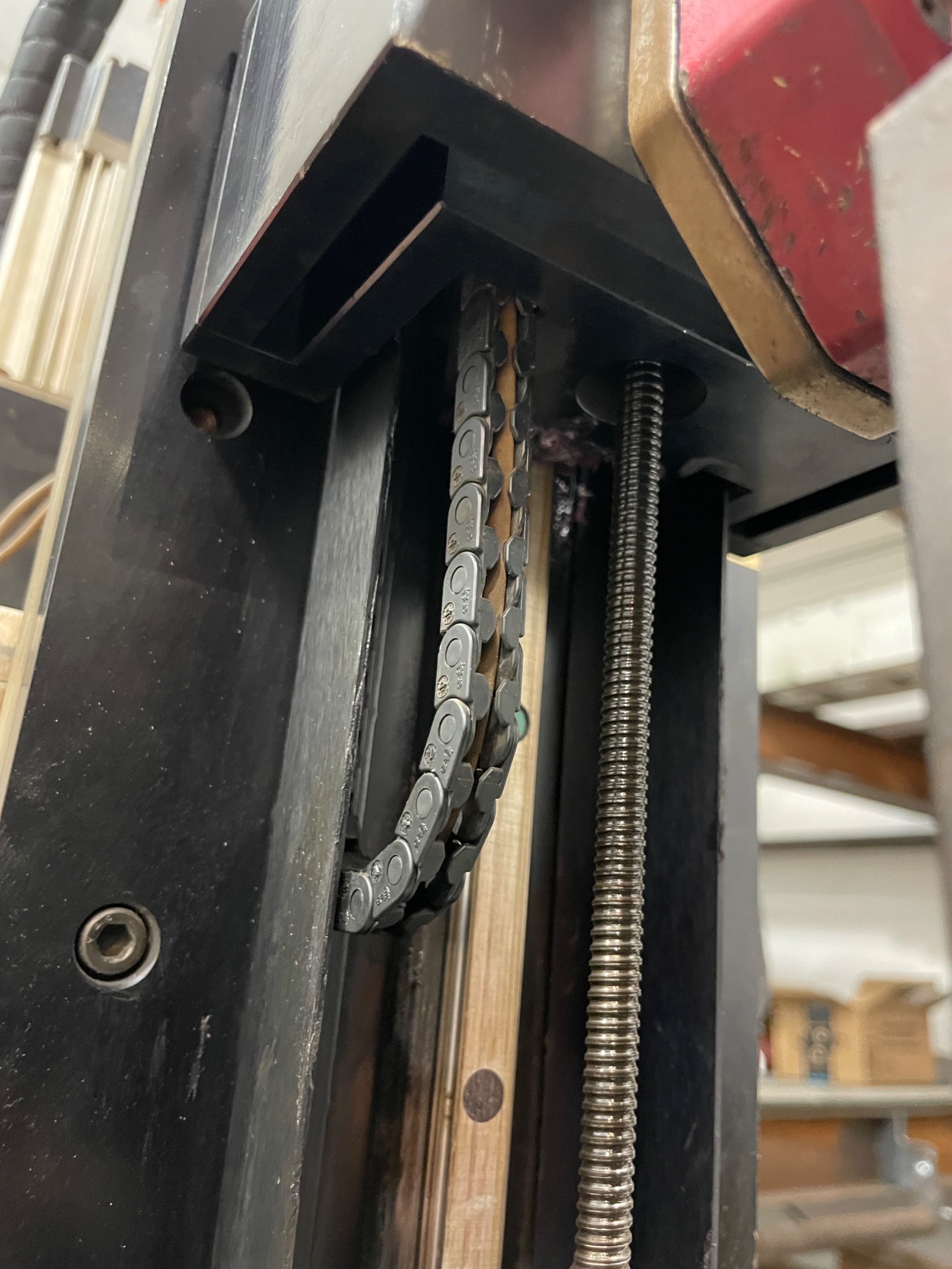

If you remove the motor are there any spot drilled holes to mount a NEMA 23 motor?
The one I had had spot drilled holes for a stepper
If not, can you remove the top plate its mounted to and locate on the hole for the shaft so you can drill and tap stepper mounting holes?

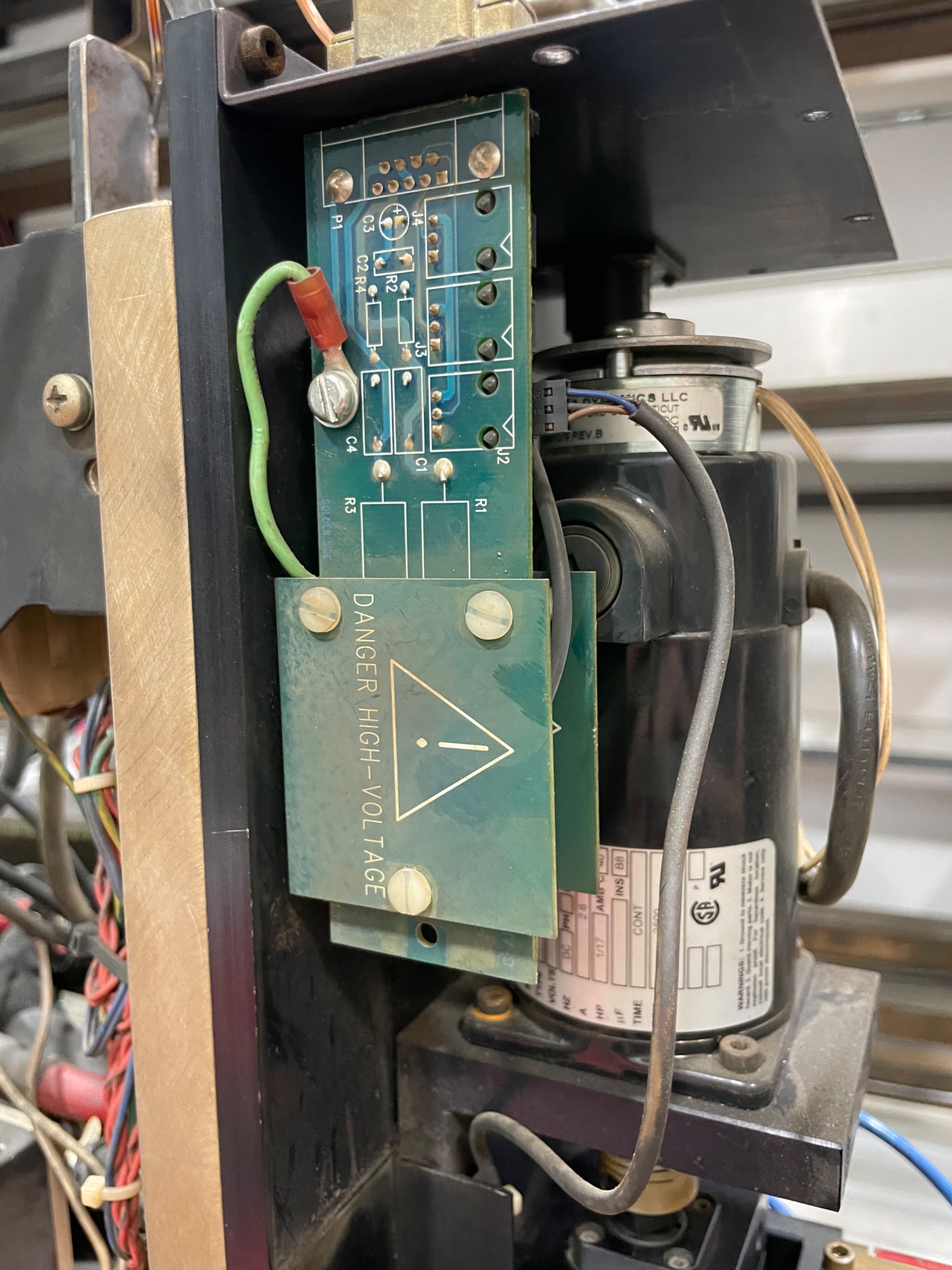

I believe there aren’t any limit switches. It uses stall force and ohmic sensing. I wouldn’t have a problem physically adding limit switches.Im not sure what the encoder looking thing on top of the motor is.Looks like there's brushes.Theres a chip and there’s a wire coming off that that goes to the nut? area for the ball screw.
