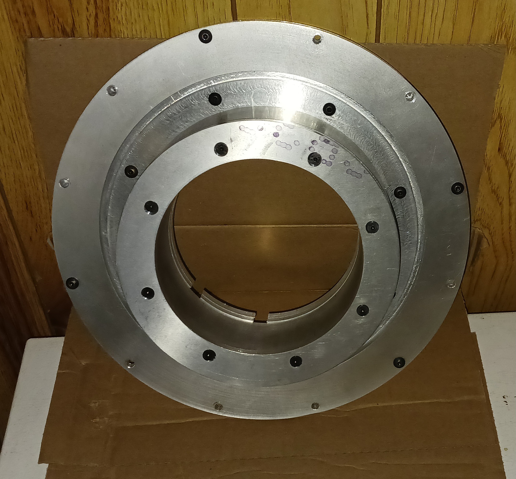

That manual self-centering 4 jaw chuck came yesterday, and that brand seems pretty well made and works really well.
i have some material ordered and coming for a attempt at a rotary union, the seals should be here today, i hope this material is not under sized or i will have issues. for whatever reason thick-walled tube in this size range is expensive and i only had one supplier that i have used that was fair on price, but sizes were limited. i checked on bar stock prices and that was even more expensive yet
it's amazing how you get screwed so bad on prices for small orders.
these unions are hard to make on the cheap. i did see one import that had 120 mm bore but was around $400 each. what i am trying is 140 mm bore. not big enough for a 4" square tube so it is what it is i guess. if i can make these i can make 2 of them for around half the price of one of the smaller imports.
i hope i can make it work
would be a neat build and if nothing else i am eager to try it at least. nothing ventured nothing gained

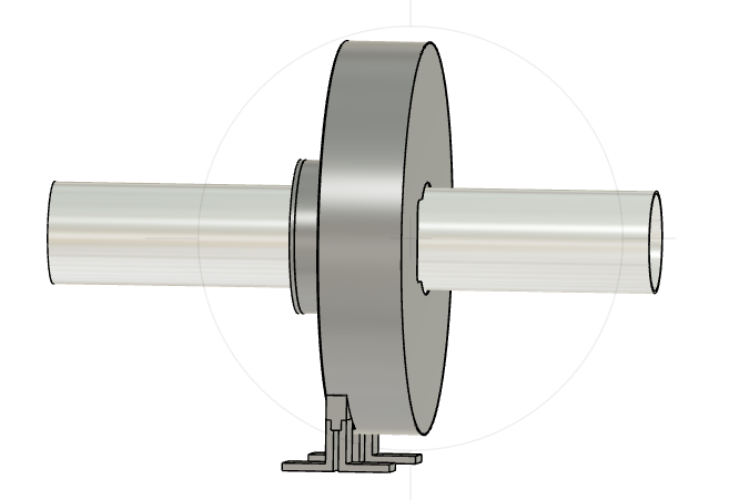

the deeper i get into this the more i realize how ambitious this project really is
one thing i did notice was i need to add some travel to my z axis to do everything i want it to do. these self-centering pneumatic chucks are turning out to be pretty big once you cover them with some sort of guard. the rotary end is going to be much more involved if this works out for me. as far as the moving parts go things seem to work really well so far. the thing that could break this is the rotary union if it does not seal well.
this build is like building 3 machines if everything works out as planned
these end up being almost 21" tall and a little over 19" in diameter and 6 1/4 "wide i added a 5" round tube which will be the max on round tube. the guards should be a treat to make the plan is to laser cut some flat sheet and either weld them together or use a special solder rod made for aluminum. welding aluminum is not something i enjoy or am very good at
but anyways here is a screen grab of my model to give you and idea of what this will look like if it works

Travis MItchell has an excellent series on buidling a rotary tube cutter for a laser head for circular, square and rectangular tube.
You should review his chuck design befor going to far into this. The material is held between 2 seperate self centring roller assemblies so it can move in and out while driven by a powered chuck at the other end on a tailstock on the Y axis. I don't get why he powers two chucks. I think only one powered chuck is required.

22 Jan 2025 01:59 #319611
by machinedude
Replied by machinedude on topic Black Friday Deal got me :)
i seen his video it's a pretty nice build but it is a manual self-centering if i remember right. the idea is to have the overhang so you can have both the flat table for larger stuff and the rotary off to one side.
what would be different about what i want to do is have the automated clamping and a second liner axis as a bar feeder and drive the rotary from a second in the rear in line with the fixed end. the fixed end is basically a steady rest with automated clamping system to hold the place while the other can be released to move back and grab another bite on the material and keep feeding material if you want to cut something long,
you basically have infinite travel on a small footprint machine.

10 Feb 2025 22:37 #321190
by machinedude
Something like 3 weekends later and the rotational parts move as they should. I got lucky with my material choices trying to keep things cheap. I ended up with about .005 to spare on the surfaces that mater and ended up with some mismatched surfaces just from the stock not being round. I got lucky this time. now if i can get it to seal in the right places and direct the air in the right places I'm in business
the rest is downhill on this on this side. the other end is more complicated yet

17 Feb 2025 20:31 #321869
by machinedude
well, it seals at least. with no pressure it spins pretty nice, but my first pressure test tells me once you add pressure it gets tighter to spin. now i have two air zones by design and i am glad i did not add more to get fancy. once i add a solenoid vale and control the air flow i will only have one zone under pressure at a time and i hope the helps with the spinning. i would be afraid to try and cut the glands any deeper the shaft already pulls itself through the body with gravity when put together. i have to do more testing to see where i am at unfortunately.
