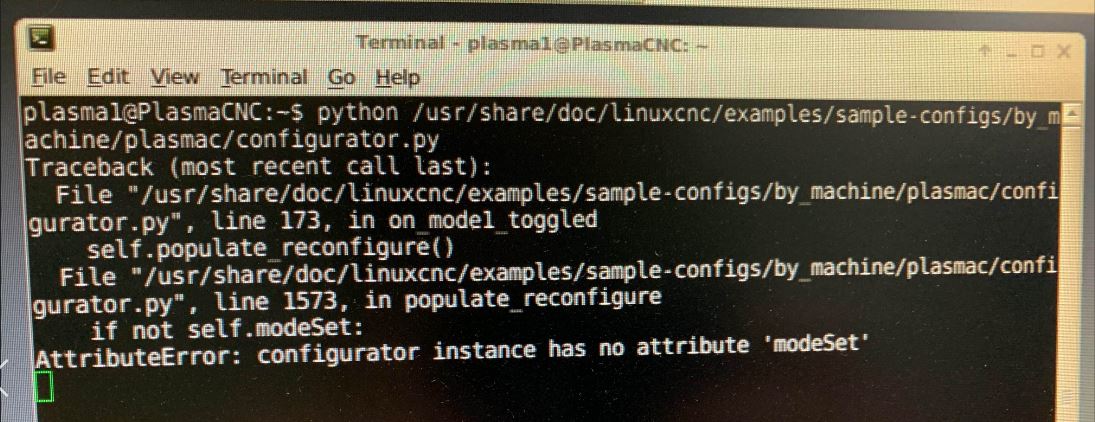

04 Jan 2020 20:29 - 04 Jan 2020 20:31 #154020 by snowgoer540
Replied by snowgoer540 on topic Configurator Error
I think I may have discovered a new error with configurator.py. I found it when trying to reconfigure an existing setup. See attached picture.
To replicate: Run configurator, click "Reconfigure", change radio button for THC Modes. Error results.
Maybe I did something wrong?
Last edit: 04 Jan 2020 20:31 by snowgoer540.
04 Jan 2020 22:22 #154036 by phillc54
Replied by phillc54 on topic Configurator Error
Should be OK in the latest version.
