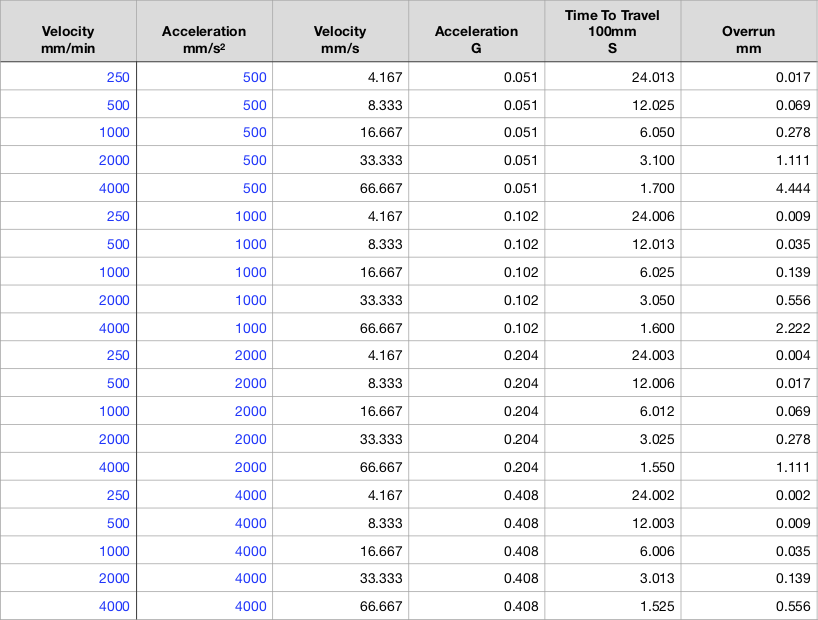

The main issue for users is that you would need a floating head with enough movement to soak up any overrun on the first probe. I did a quick spreedsheet of overrun figures (metric only) and it shows at 2m/min it takes roughly 3 seconds to move 100mm (provided my calculations are correct).

13 Apr 2020 05:30 #163860 by rodw
Replied by rodw on topic Probing Revisited
I can't imagine what you were thinking doing calculations in G forces. Australia saw the light in the 70's and converted to SI units. What were you thinking???
:ohmy: :evil: :ohmy:
And nowhere do we reference g forces in Linuxcnc configs. ...
Its been discussed previously on this forum that Newtons apple was accelerating at 9.81 m/s/s when it hit him on the head! (so 0.051g = 0.051 * 9.81 = 0.500 m/s/s = 500mm/sec/sec (in Aussie Device units)
Anyway, your efforts deserve a reprieve so I am prepared to overlook your dalliance! :) :)
Thanks for taking this on board Phill. I'll test when I can but I think it will be a few days before I can try this out. You did really well finding that earlier post. Hopefully ideas like that can be broken out into separate threads now Plasmac has its own forum section.
Its interesting you mentioned the float switch. A few times I noticed that probing was really slow last week but then I observed exactly what you said. A bowed sheet must have resulted in slow ohmic connection so I noticed when this happened the probe upwards was taking up the overshoot on the float switch.
