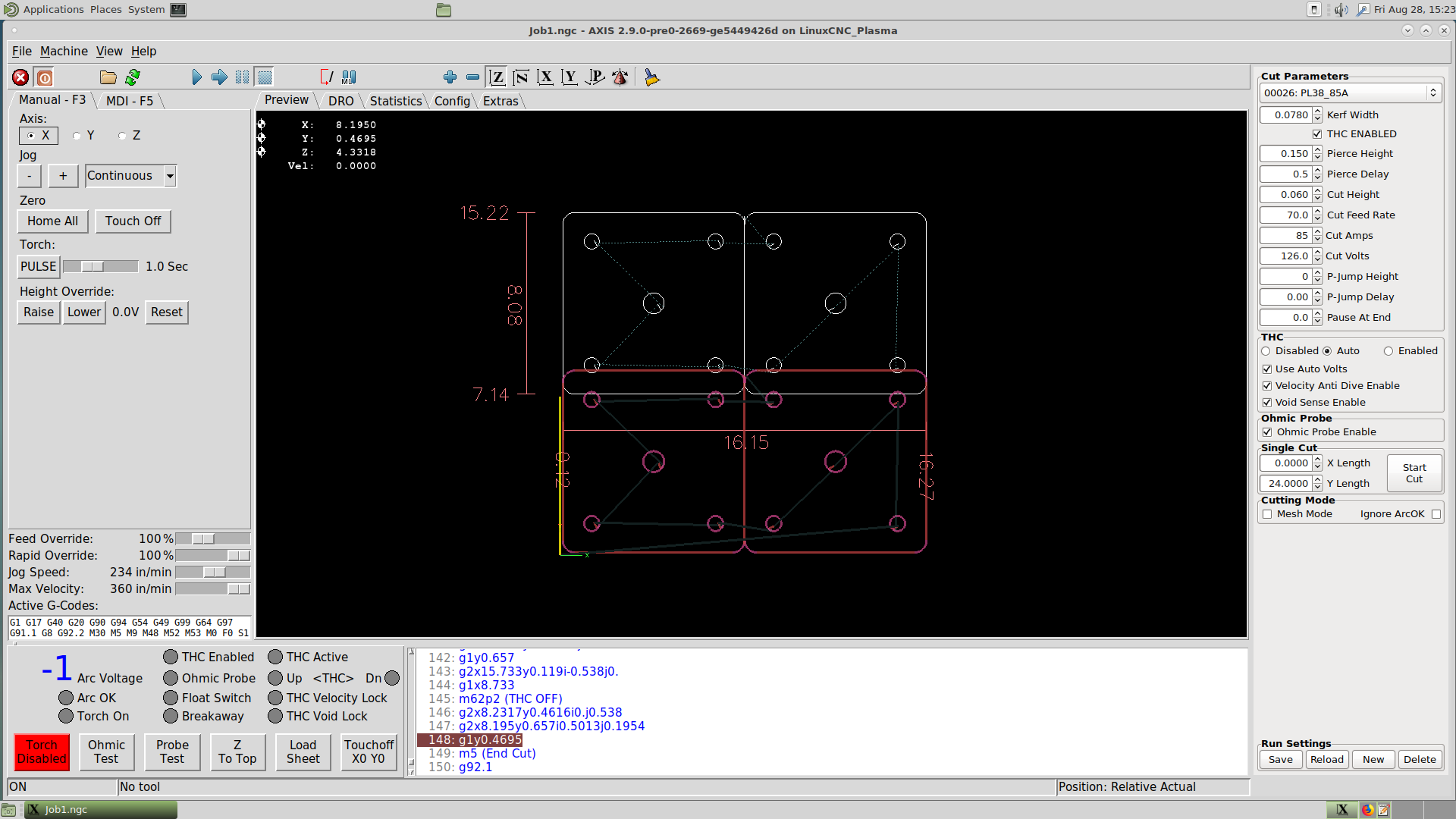

I am setting up a custom user button in Axis that would let me set X0 Y0 sheet touchoff in one button press.
I set it up two ways.
First in .ini file:
BUTTON_5_NAME = Touchoff\X0 Y0
BUTTON_5_CODE = G10 L20 P1 X0 Y0
Second in .ini file:
BUTTON_13_NAME = Touchoff
BUTTON_13_CODE = o<touchoff> call
touchoff .ngc
O<touchoff> sub
G20
g10 l20 p0 x0 y0
G53 G0 Z[5 - 0.25]
O<touchoff> endsub
M2
Both ways work, but I’m having one issue. If I have the program loaded first, it will set the coordinates to X0 Y0, but the display will not update to show the parts at actual position. Is there something that can be done to have it refresh the display? Is this just in Axis or does Gmoccapy perform the same?

For Axis you could try:
g10 l20 p0 x0 y0 \ %axis-remote --reload
this will set the coordinates then reload the program which refreshes the preview.

Excellent! It works, right what I was looking for.:)
You might want to consider adding it in PlasmaC documentation as a user button option.

I did this today, and found it a little annoying that it didn't clear the live plot (thick yellow line of where you'd jogged around) as well. A little digging around, and guess work, and I discovered that this does both:
G10 L20 P0 X0 Y0 \ %axis-remote --reload \ %axis-remote --clear

One more thing would could be added to make this button perfect... it needs to re-zoom, to bring it back to the center of the screen and sized correctly. If I click "top view" it does what's needed, but I dont know how to do that via code. Any ideas?

I keep hitting the top view Z button to center the plot. I probably wouldn't need to, but it sure is ease of mind to see that it touched off correctly before I start to cut. I liked your addition to clear the plot. Thanks all for contributing to PlasmaC. I checked around, but with my limited understanding of LinuxCNC I didn't find a solution to centering the plot.
