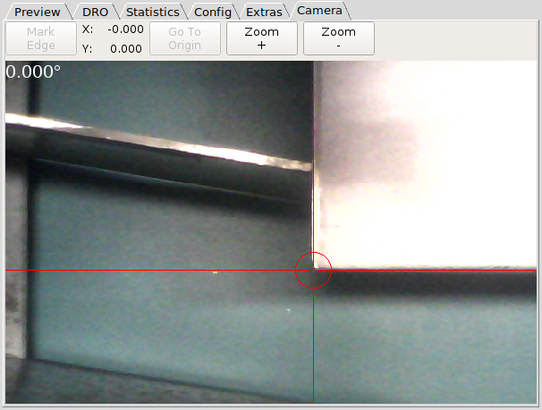

I have been playing around with a Qtvcp camera view tab embedded in Axis and Gmoccapy and with the help of Chris Morley I mangaged to get it working pretty well for touching off X and Y and also setting the rotation of the coordinate system.
Camera View:
Warning: Spoiler!
The camera needs to be attached firmly and it is wise to spend the time adjusting it so the crosshairs point to the same place when Z is at the top of travel and also at the bottom of travel. Make sure that the crosshairs are aligned properly with the X and Y axes.
Install any dependencies required for Qtvcp (it is supported by default in the new LinuxCNC Buster ISO).
The attached file needs to be copied to the machines config directory.
Edit the machines ini file by adding these lines to the end of the [DISPLAY] section:
Warning: Spoiler!
The Mark Edge button and the Goto Origin button will have their names changed to Set Origin and Set 0o Rotate depending on what function they are able to perform.

17 Sep 2020 06:07 #182509 by Mud
Replied by Mud on topic Camera For Touchoff
Very nice - can it be used with any linux-compatible webcam?

17 Sep 2020 06:14 #182510 by phillc54
Replied by phillc54 on topic Camera For Touchoff
Good question, I used it with a cheap'n'nasty "endoscope" usb camera I had lying around, similar to this
It also worked on a virtual machine with the inbuilt camera on my Mac.

17 Sep 2020 08:27 #182515 by rodw
Replied by rodw on topic Camera For Touchoff
Phill,
very nice.
Can this be used with a laser pointer?
Do you have to set the rotation by pressing buttons or does it calculate that?

17 Sep 2020 08:30 #182516 by phillc54
Camera only.
Rotation is manual with a mouse, right button + scroll.

17 Sep 2020 08:41 #182518 by rodw
Camera only.
Another method is to find an edge down the back of the sheet, press a button, and then go to the origin corner and click touchoff and calculate the angle using some trig and adjust for the offset. That is much more accurate when a full sheet (say 2400mm x 1200mm or 3000mm x 1500mm) is used. I have done some work on that with my laser pointer extending some work by BigJohnT.
But with the camera, you should be able to implement edge detection and corner detection using opencv features. Imagine that! Just click one button "Align sheet" and let the machine do it all automagically. Let the camera wander around looking for edges then finally move to the origin corner.

17 Sep 2020 09:02 #182521 by phillc54
Camera only.
Yeah, that would be easy to implement.
There's project for you, Qtvcp uses opencv so it's half done. :)
