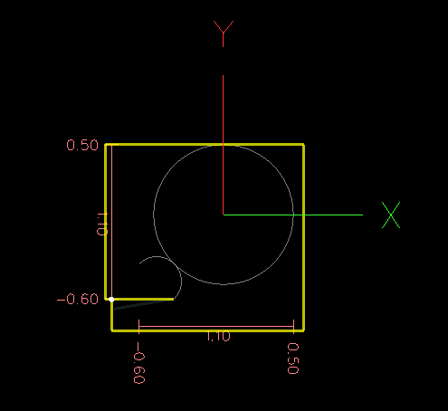

I use a program called lightburn for my CO2/diode lasers. One feature that I use alot is the frame button. This basically runs the nozzle around what you are cutting in a square to make sure you have room on the material to cut that particular item. I noticed linuxcnc has a extents display on screen giving the location of the start as well as the length/width. I know I missed this feature as I was cutting some items and missed the plate on the one

Interesting. Normally I just look at the preview window and jog the torch around the extents of the program's movements (white/grey lines) and then jog the torch down at each critical point and make sure it will have enough material to eat.
Seems to work well. Though it's not automated like you're saying.
Take this for example, the yellow is my jog path prior to running the program:

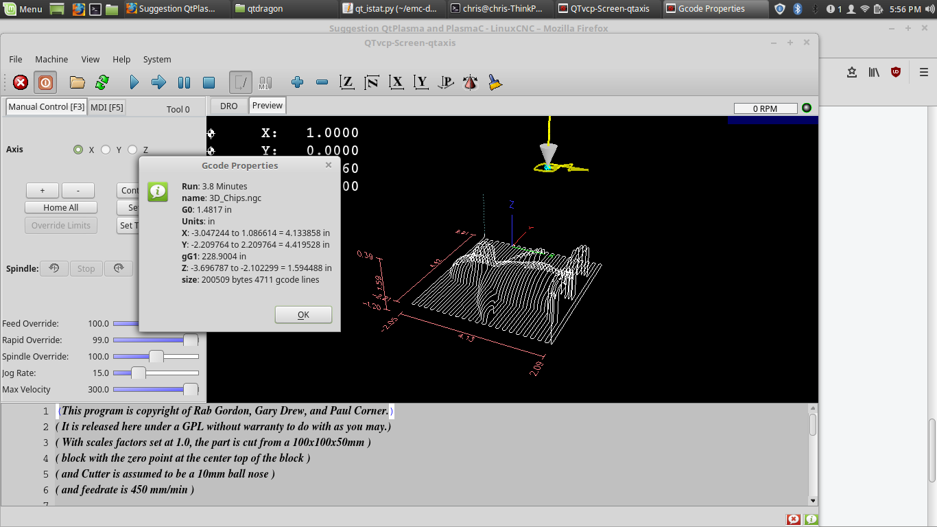

04 Mar 2021 01:58 #200977
Replied by cmorley on topic Suggestion QtPlasma and PlasmaC
- phillc54
- Posts: 5711
- Thank you received: 2100
04 Mar 2021 02:01 #200978
by phillc54
Replied by phillc54 on topic Suggestion QtPlasma and PlasmaC
Thanks Chris, that is helpfull, I didn't know about that...I wonder if the 'gcode properties' info is useful for that - you could use the info to build a macro to rapid around the perimeter...
