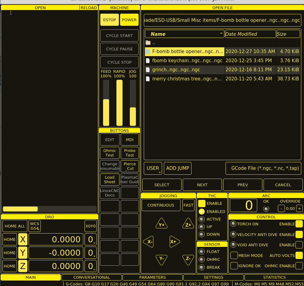

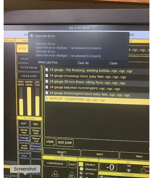

Hi all, I have converted to QTplasmac and I'm having some trouble starting a cut with a file. I get the error, multiple not allowed.

20 Mar 2021 20:27 #203033
by snowgoer540
Replied by snowgoer540 on topic QT plasmac conversion
Can you clear the error message, and show the whole screen?
I am guessing that you have recently updated, because the labels for the error message are correct (they werent a few days ago).
However, I have seen something very similar before when there was a problem with Qt's file manager.
It may also be helpful if you can click the backup button in the parameters/settings tab (depends on screen size) and post that here as well.

20 Mar 2021 20:42 #203037
by snowgoer540
Before what?
If you had an older version of QtPlasmaC, you may have had a version with the file manager bug that Chris fixed.
You may have to go to those files in your file manager and remove the extra . in them. It's complaining because right now your files are named FILENAME..ngc instead of filename.ngc. After you get them straightened out, it should go away.

20 Mar 2021 20:55 #203040
by wade956
Replied by wade956 on topic QT plasmac conversion
Thanks that worked. All my files get those long chains for some reason. I’ll need to start deleting them when a bring it from sheet cam.

20 Mar 2021 20:59 #203042
by snowgoer540
also, when you make sure there are no ".." in the file names, edit "qtplasmac.prefs" and change this:
to this:
That will also help clean up some of the file system stuff.
[BOOK_KEEPING]
last_loaded_directory = /media/wade/ESD-USB/Small Misc items
RecentPath_0 = /media/wade/ESD-USB/Small Misc items/F-bomb bottle opener..ngc..ngc..ngc
style_QSS_Path = DEFAULTto this:
[BOOK_KEEPING]
RecentPath_0 =
style_QSS_Path = DEFAULTThat will also help clean up some of the file system stuff.
