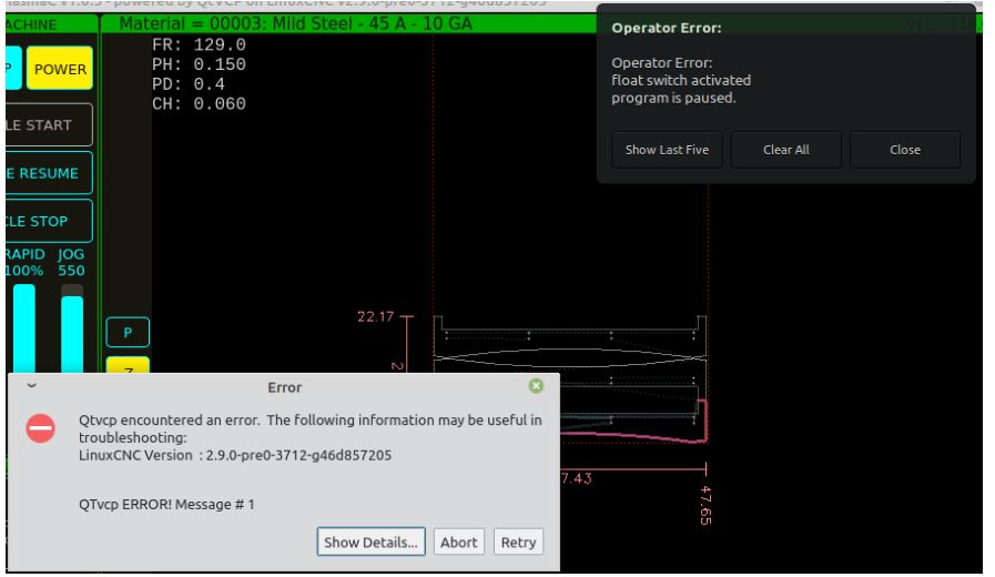

I would like to start out by saying QTPlasmaC is sweet! All involved in its creation should be commended. I do want to report a bug though, and hopefully get some ideas to fix my issue.
I am updated to version 1.0.5. (The latest at the time of writing this) I was cutting some stuff out tonight and I kept getting an error while cutting that would result in a complete crash of the software.
I switched over to PlasmaC (Not QT) and ran the same file. I got a pause program over there saying that my float switch activated. The big difference is it didn't crash the tool over in PlasmaC. It just paused, and would allow me to resume. So the fact it is crashing instead of pausing is the bug.
Now my question. I think the float switch activating during cut is an EMI issue that I don't have the expertise or equipment or knowledge to track down. Is there a way to deactivate the float switch during the cut, then reactivate it for the next pierce so the controller stops reading any signals coming from it while cutting? If not, is there a way to add debounce or something like that so that false signals don't interrupt? I didn't see anything in the config for that. I probably missed it. I saw the Arc OK debounce.
My controller is the 7i96. It is an awesome controller, but a little too sensitive for it's own good in my noisy, crappy cheap table, environment.
Thanks in advance.

Can you click "Show Details" on the error message and post the result.
There is debounce on the float switch in the connections.hal file.
linuxcnc.org/docs/devel/html/plasma/qtpl...ml#_contact_debounce

As far as clicking "show details". I tried. Any button I pressed would crash the software. Show details, about, retry, the little x at the top. All attempts resulted with a crash.

If you were running from a terminal was the a error message in the terminal. If you weren't running from a terminal can you try that.
This is untested but you may be able to enable ohmic sensing, this then has a hal pin plasmac.ohmic-enable which is only active while probing. You could connect this to a relay and run you float switch signal through the relay contacts.
I would not recommend doing this if you don't have a breakaway switch for safety reasons.

I know you suspect EMI noise, but are you sure the float switch isn't actually getting tripped? I have had the same problem in the past when cutting material that warped during cutting. It doesn't take a whole lot for the material to push the torch up and trip the float switch. I also saw it once when I was messing around with the tuning of the THC and had made it too slow.
How much travel is in your float switch? I would recommend actually watching the floating head/switch while it's cutting to make sure it's not actually moving/getting tripped. It seems everything happens 10x faster while actually cutting :laugh:

I rebooted my machine last night before coming in the house. I don't know if that has something to do with it, but now when the float switch gets tripped while cutting, it pauses the program as designed, and is no longer crashing. So I couldn't get a crash report.
Now I will play with the debounce and see if I can eliminate the float switch falsely tripping. I don't think it is getting pushed by the material because the THC isn't doing it's job. Not outside of possibilities, but I was looking pretty close last night at that and it didn't appear to be happening.

I've have had a chance to record in the terminal when the tool crashes. I saved the report on my other computer and don't have it available to post. But I know what it says. Basically an arc OK signal lost on initial arc is causing the tool to crash. You can duplicate this by removing your ground clamp and running a job. I had an issue with QTPlasmaC sampling for Arc OK before my hypertherm is giving the signal. I thought this issue was from the float switch getting triggered, but I was wrong.
I have the issue resolved by adding time to the arc ok debounce value. So I don't want to get into that. It is working great now. But the tool still has the bug of crashing if arc ok is lost.
