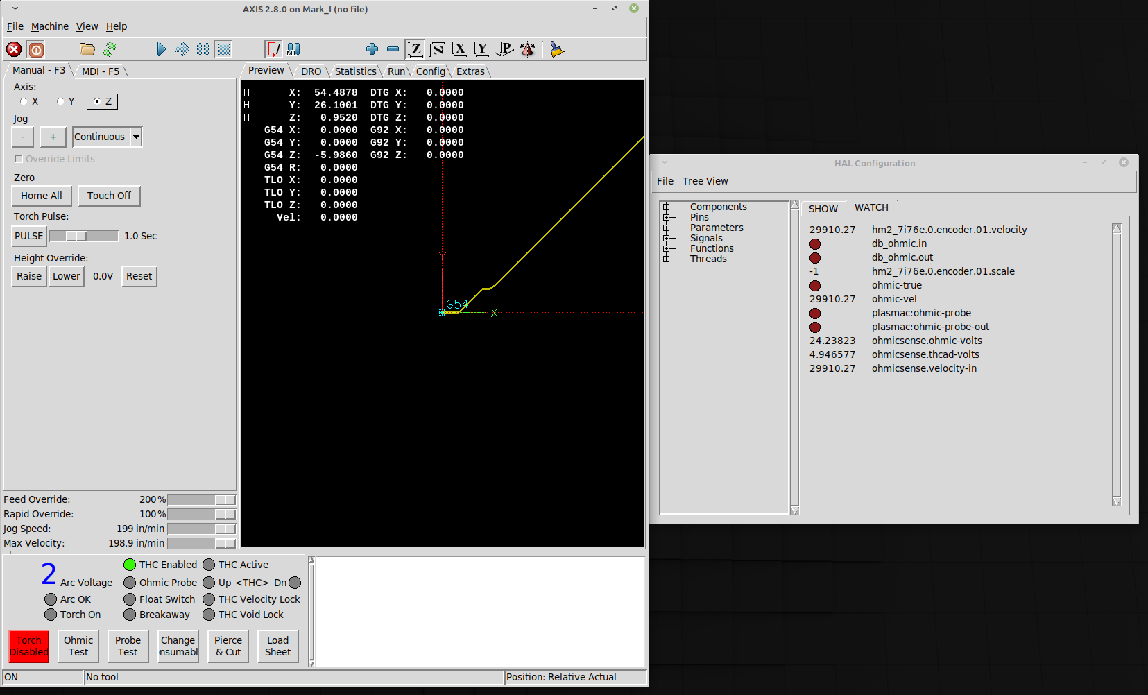

I cannot get Hypersense to work. Not sure what I have done or not done. The screen caps are with the torch not touching the plate and then with torch touching. Also including my ini hal and hal connections.

Could be a wiring issue.
If you simply short the two sense wires do you get close to 0V
on ohmicsense.ohmic-volts?

Replied by rodw on topic Hypersense configuration with 2.8 and PlasmaC
I'm thinking some crap is in the nozzle shorting it out. Can you remove the consumables and give it a clean out in there?
There is a near full voltage when off the plate so as PCW says, there is s short somewhere.

Replied by PCW on topic Hypersense configuration with 2.8 and PlasmaC
Ahh I had forgotten it reads high (~24V) when shorted
so yeah either a short or the sense load resistor is missing
or misconnected
or misconnected

That makes sense! (pun intended) ... but this is a two part problem.
Before I left the shop for the day I tried unplugging the sense cable from the torch and the reading dropped to near zero. So you are probably correct about the short being caused by "crap in the nozzle". I made some simple cuts this weekend, mainly to test the downdraft, and must have gotten said crap in the nozzle.
HOWEVER (part two)
The ohmic signal is not on in the GUI... and I do not recall seeing it on. I believe I have the wiring correct, but never connected all of the HAL/Plasmac pins properly.
Replied by txtrone on topic Hypersense configuration with 2.8 and PlasmaC
HOWEVER (part two)

You would have to press "OHMIC TEST" to see the Ohmic Probe indicator light up on the GUI.
Replied by snowgoer540 on topic Hypersense configuration with 2.8 and PlasmaC

Correct. I failed to mention I pressed the OHMIC TEST button, nothing lit up on the GUI.

Just to be sure, does the torch have an electrode, a nozzle and a shield ?

What is the pin that enables Ohmic sensing so the probe becomes active?
I suspect that Plasmac has changed since the component has been written or we got something wrong in the connections file.
the component will only go true if ohmicsense.is-probing is true
se lets setp it to 1 for now

The same one it has always been, plasmac.ohmic-enable
