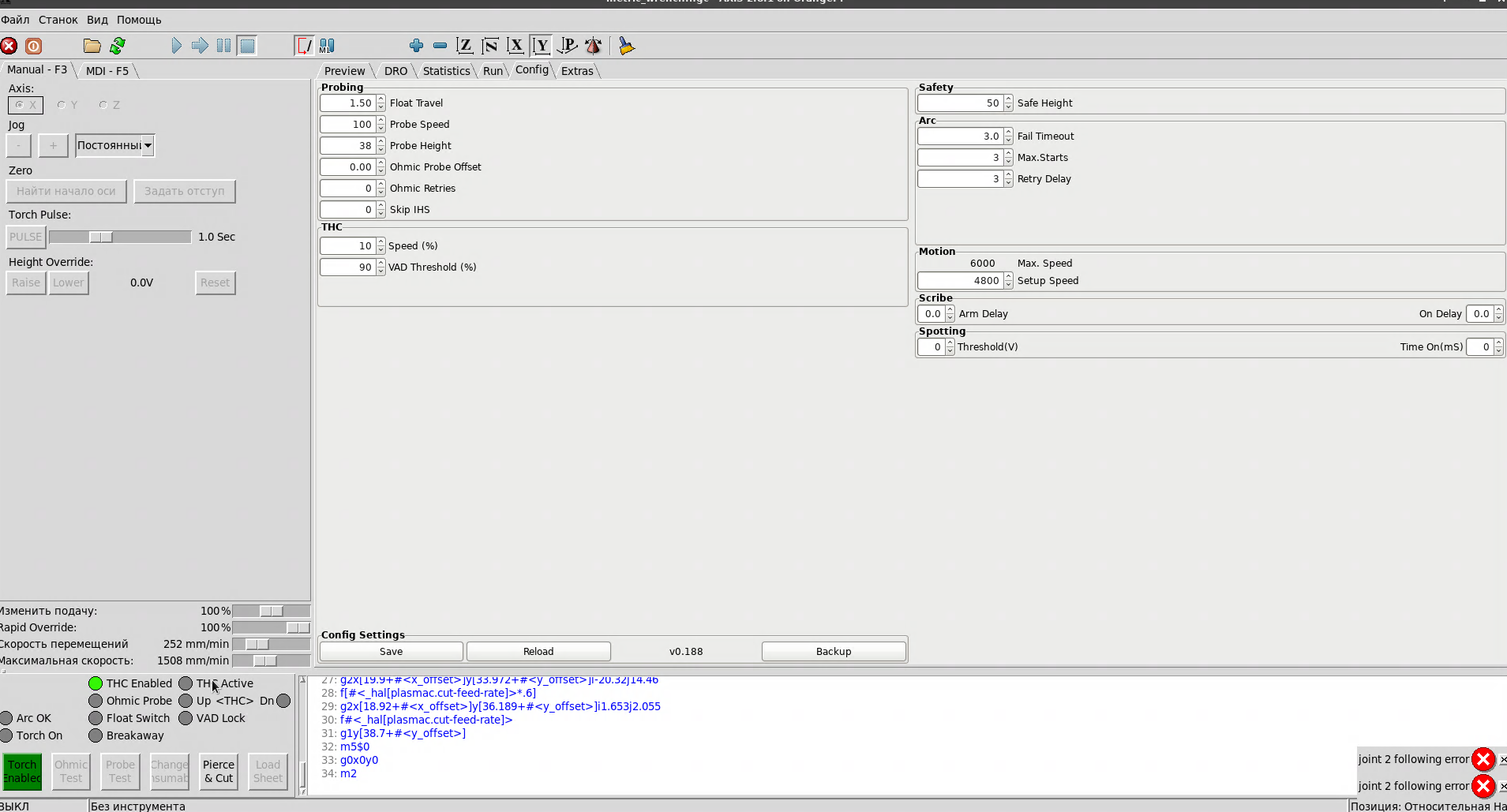

There is a problem:
1. Hardware - Orange PI PC Plus
2. Software - LinuxCNC / AXIS Version 2.8.1 + AllwinCNC (allwincnc.github.io/index.html) - (mode2)

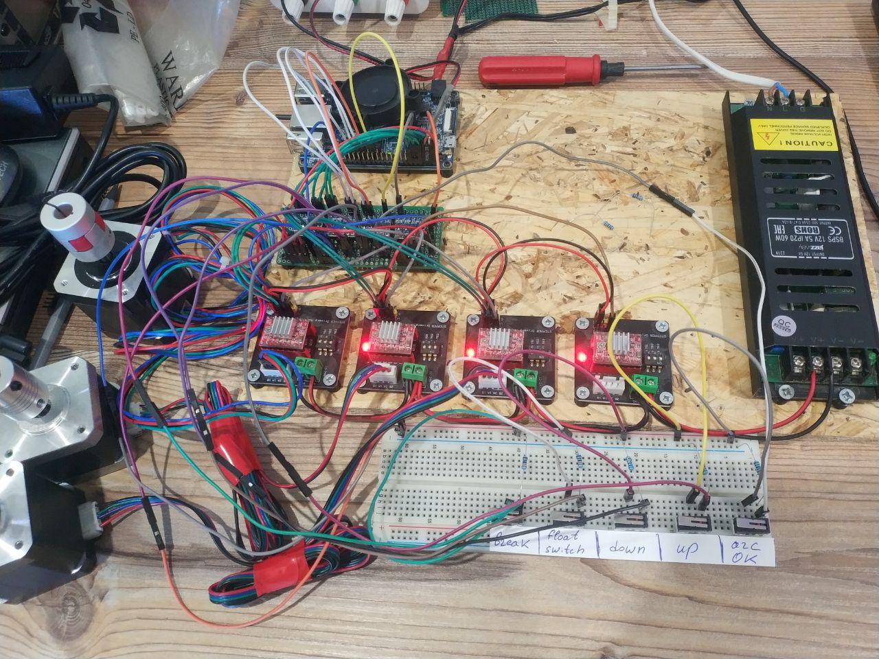

Due to the lack of THC modeling it with the help of the buttons. In general, the part works - to change the "Float Switch" and "Arc OK" signals, it is regulates correctly, however, the "THC ACTIVE" and "UP <THC> DN" indicators are not activated in any way and the corresponding variance of the z axis during the head movement is not controlled.
Please tell me what could be the problem?

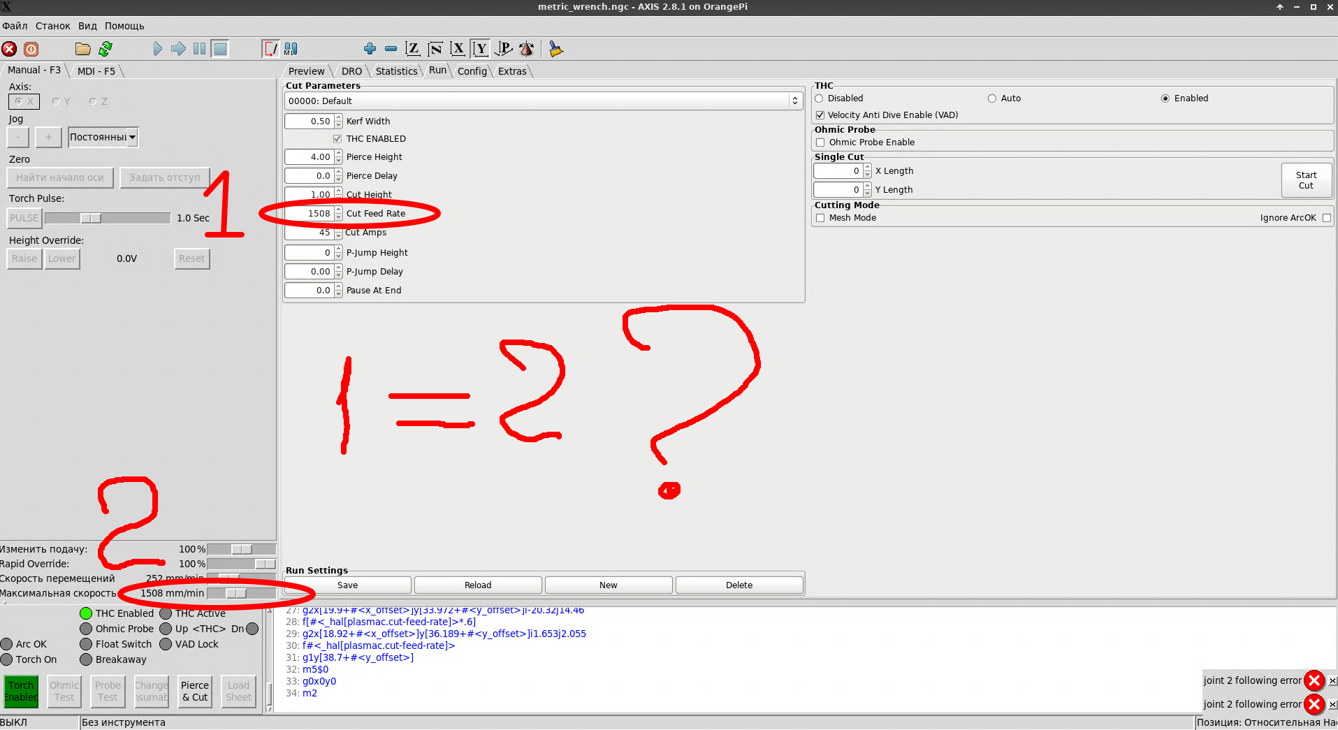

08 Jun 2021 09:42 #211490 by phillc54
Replied by phillc54 on topic The "THC ACTIVE" indicator is not active.
The THC UP and THC DN LEDs can only be on if the THC ACTIVE LED is on.
"THC ACTIVE" can only be on if all the following are true.
The macine is cutting.
THC is Auto or Enabled in the THC frame of the Run Panel
THC is enabled in the Cut Parameters frame of the Run Panel
The cut velocity has reached 99.9% of the Cut FeedRate in the Cut Parameters frame of the Run Panel
The THC Delay in the THC frame of the Config Panel has timed out.
08 Jun 2021 11:25 #211500 by Egor
It turns out "1" and "2" should always be equal?
Where on "Config Panel" is the option "THS delay"?

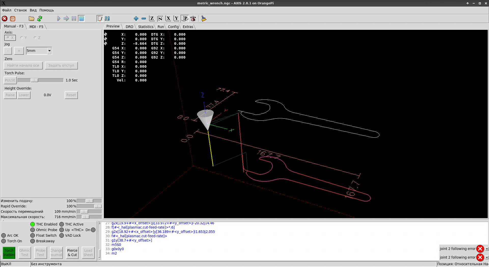

1. What a mistake in the lower right corner - "joint 2 following error"
2. When operating in 0 mode, the ark-voltage-in input signal is supplied to what form (analog voltage, PWM with a certain frequent)? Can I enter analog voltage after a voltage divider 50: 1?
08 Jun 2021 11:35 #211501 by Egor
another question :-)
where the minimum distance is configured to which the head will move, after receiving the signals Move Down, Move

08 Jun 2021 12:08 - 08 Jun 2021 12:10 #211502 by tommylight
Replied by tommylight on topic The "THC ACTIVE" indicator is not active.
That is set by the PID settings and the thc velocity.
There is no distance to set i PlasmaC or QtPlasmaC, not chinese THC.
The reaction speed can be set usually just by changing the P value from default 10.
Last edit: 08 Jun 2021 12:10 by tommylight. Reason: more info
08 Jun 2021 13:02 #211505 by Egor

08 Jun 2021 14:04 #211509 by tommylight
"Config" tab, THC section, "speed" in %
Set it to 12 and test.
09 Jun 2021 03:01 #211582 by phillc54
No. the actual velocity during cutting has to reach 99.9% of "1" before THC Active LED is on.
Sorry, that does not apply for Mode 2.
The ArcVoltage input is a floating point value. Most folk get it by using a Mesa THCAD connected to an encoder and then use the velocity output of the encoder.

09 Jun 2021 07:10 #211594 by Egor
Why an error in the lower right corner appears - "joint 2 following error"?
