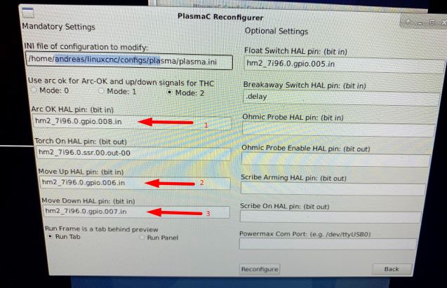

Hi!
Can you run PlasmaC without a THC? I´m not shore how this works, but what I’m after is that i want the height probing (floating z?) part.

29 Sep 2021 06:25 #221802
by phillc54
Replied by phillc54 on topic PlasmaC without THC?
Sure, you could set the THC to not enabled.

29 Sep 2021 07:04 #221806
by Ekholm
Replied by Ekholm on topic PlasmaC without THC?
I couldn't configure it without a THC? At least with the configurator. I tried to change the modes, but none would work without filling in something

30 Sep 2021 05:49 - 30 Sep 2021 05:52 #221867
by Ekholm
"You can use PlasmaC with no THC in mode 2 and by ignoring the ARCOK signal." /TommylightI tried to run the PlasmaC configuration and i didn´t manage to fill it the config without a ARKOK signal. See attached picture. I therefore added a not used input (number 1 in picture). Is that how you ment?The move up and down HAL pins are they necessary? It seems that i can't go through the wizard without those? Sorry for the basic questions!I have tried to look for tutorials but didn´t find what i was looking for. So now i added unused ports and the configuration did go through (but haven’t tested yet)

30 Sep 2021 05:58 #221869
by phillc54
All the entries on the left side are mandatory so you will need to put something in them. After the config is made then you can comment them out in the hal file. You will also need a fake arc-ok signal so you will need to do some editing of the hal file after it is made. When you get all the motion correct and your machine running then post your hal files here and we can help you with the changes required.

- Posts: 21990
- Thank you received: 7487
30 Sep 2021 09:21 #221875
Replied by tommylight on topic PlasmaC without THC?
Wire the torch.on pin to arc.ok pin in hal.
