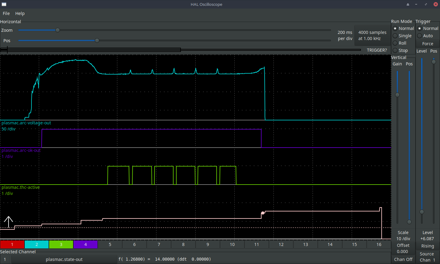

31 Oct 2021 20:06 #224789
by snowgoer540
Replied by snowgoer540 on topic THC Delay in material file
Was doing other testing today. But pictured below is a graph where my THC Delay is set to 0s. You can see that the voltage is stable for about 50mS before the first time the THC became active.
I didnt have time to test on different thicknesses, but I would expect other thicknesses to follow suite.
In case it matters to anyone, this is with a Hypertherm Powermax 65XP
- Posts: 12156
- Thank you received: 4149
31 Oct 2021 21:01 #224795
Replied by rodw on topic THC Delay in material file
Looks good!
What thickness material?
Whats with the voltage spikes? Are you testing kerf crossing?
