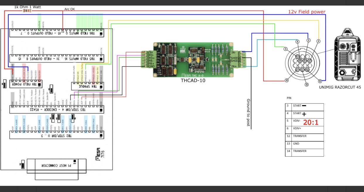

PlasmaC THCAD-10 was created by Aldenflorio

I have the arc OK which is in pin 10, then I have the floating switch which is pin 2. I got those from the hal. I just am not sure where to find what exactly to type in for arc voltage, or torch On.

I think arc voltage would be hm2_5i25.0.encoder.00.velocity
Torch on would be whatever output pin ypu have wired.

arc voltage-??? I tired what was suggested but I get error messages saying it doesn’t exist
Ark OK- hm2_7i76e.0.7i76.0.0.output-10
torch on- ???
floating switch- hm2_7i76e.0.7i76.0.0.input-01
I cannot figure this out.
torch on- ???

Float switch is alo INPUT so the above should work.
Use "hal configuration", on the left side select "pins" then the card (7i76) then 0, then whatever comes next until you find "encoder", click on it, now on the right side check and write the pin, it should be something similar to what PhillC mentioned above, enter EXACTLY that pin for "arc voltage".

I’m sorry I’ve been away. I’ll post the compressed file of my base machine set up. I again am using the same wiring as the picture. My floating switch is pin 1, my arc okay is pin 10. I found afc voltage to be hm2_7i76e.0.encoder.00.velocity
