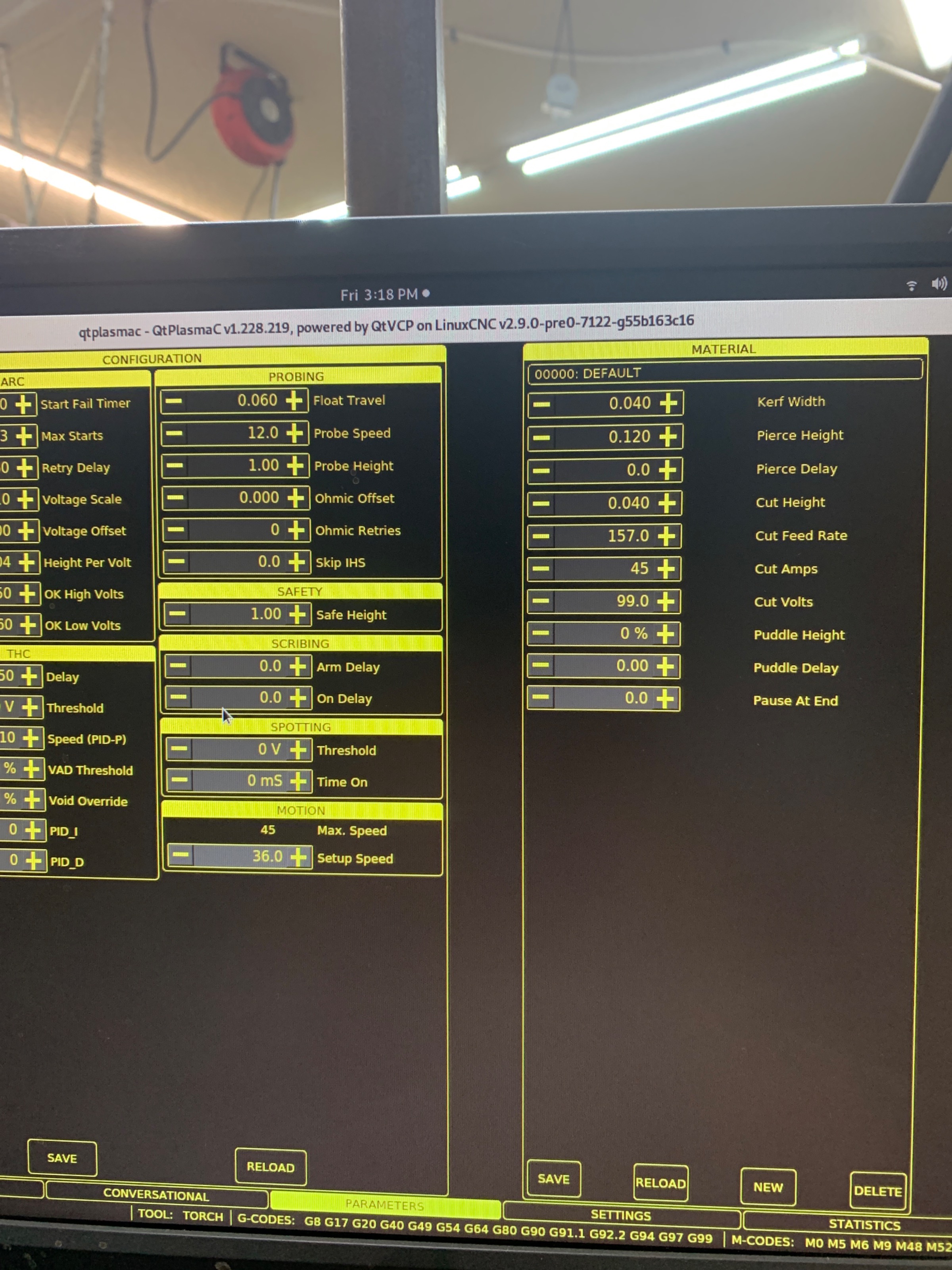

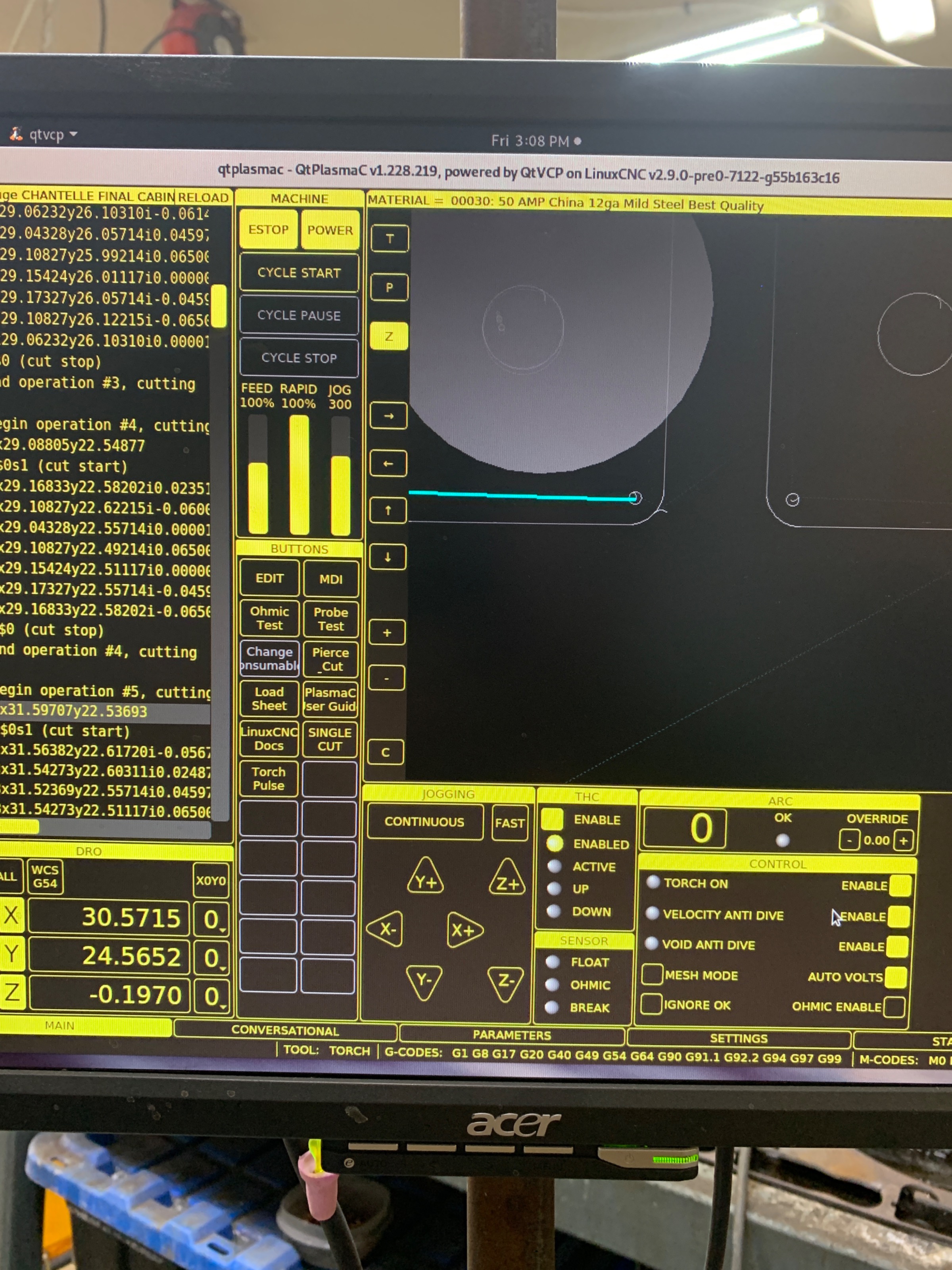

Hi, it appears something has changed with my THC. When I used my machine today it lost voltage scale and offset information. I put those back in but I’m not getting any float height or cut height any more (torch drags on the sheet)
I also can’t seem to get run from line to work any more either. Has that changed?
thanks again for the help.

Can you post a backup of your config from the settings tab?

See attached

It’s old files. Also I tried just a square on the conversational and it did the same thing. It’s sees the float switch come on but doesn’t seem to do much other than stop z axis.

Looks like run from line was disabled. This is fixed now

Please disregard. My float setting changed as well. Thanks for looking.

It appears my THC have been changed as well.
Are there backups stored anywhere for these settings? Or do I need to do that manually?
