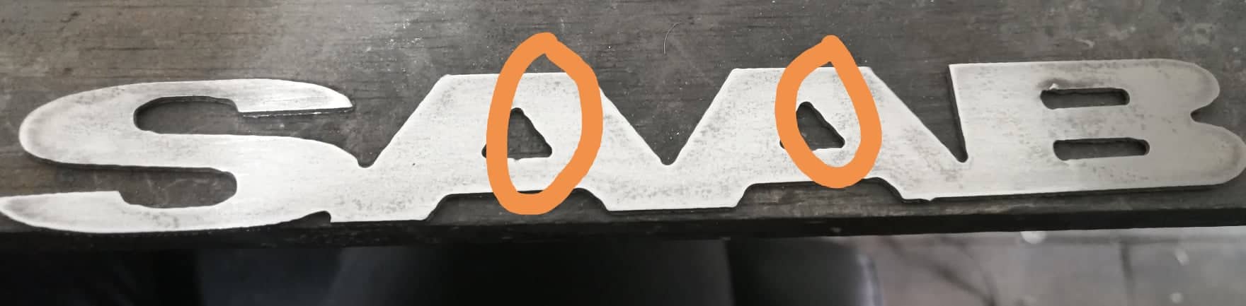

Greetings to all. I am trying to cut some car logos for a client, does anyone know if I have to change any cutting parameters because in these small parts I have a wave. Thank you.

That is mechanical, so no parameters will help.
Still, lowering current and speed might improve things a bit.

Thank Tommy, and yes reduces speed and current and greatly improves
