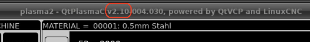

Your update log has 24-01-16 Updated to V2.9-236.278, are you sure you are running master branch, the title bar should have 2.10 in it:
I am not sure why you are using the HAL file plasmac.tcl, normally QtPlasmaC would use qtplasmac_comp.hal
I made a sim from your config, changed the HAL file to qtplasmac_comp.hal, ran it in master branch and the last plasmac component I posted here definitely works.

11 Mar 2024 19:40 - 11 Mar 2024 21:15 #295674 by Deveraux
Replied by Deveraux on topic Another offset probing request
Soooo i hate to annoy you again but i have a couple of questions as i have been trying to solve this on my own for a few days but im not getting anywhere.
First of all which version of debian are you running the master branch on ?
(I was not running the masterbranch for the records i had the normal repos ) But once i updated the repos to the masterbranch with 2.10 on buster i couldnt even start qtplasmac anymore ( neither with qtplasmac_comp.hal nor plasmac.tcl)  with plasmac.tcl it started up once into the gui telling me to restart afterwhich i get an error that it cannot find M190...
qtplasmac_comp.hal gets me errors that the hal pins for arc ok do not exist. (If i comment out the arc ok pin it just Iterates through the halpins saying they dont exist)
(for the records my System was build on linuxcnc 2.8 plasmac and i upgraded to 2.9 and via the converter.
I pretty much gave up on my config already since it seems to be the problem  and i will recreate the machine config from scratch.
But before i do that i would like to know if there is a possibility to run the master branch on bookworm ? I tried buildbot2 but the Package wasnt Signed so i thought id rather ask if there is an offial repo for the masterbranch on bookworm or if i should rebuild my setup on buster since the buildbot page only shows the repository of the master branch for buster...
Anyways since i couldnt progress on the software side of things i built a floating z axis with 3 inductive sensors to pause the program upon collision which does help. But i would still like to get this up running.

11 Mar 2024 22:42 - 11 Mar 2024 22:44 #295697 by phillc54
Replied by phillc54 on topic Another offset probing request
Buster, Bullseye, and Bookworm. All my development is done on Bookworm.
Aha, one of your earlier posts did mention master, and the update from 2.8 does explain the .tcl file.
If you installed the package that is in Debian Bookworm then I am not surprised by the errors, that version is very buggy.
You can definitely run master branch on Bookworm. There should be no problem installing the packages from buildbot2 and then we should be able to rework your existing config to get you up and running although that may take longer than creating a new config...
