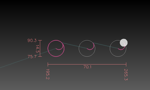

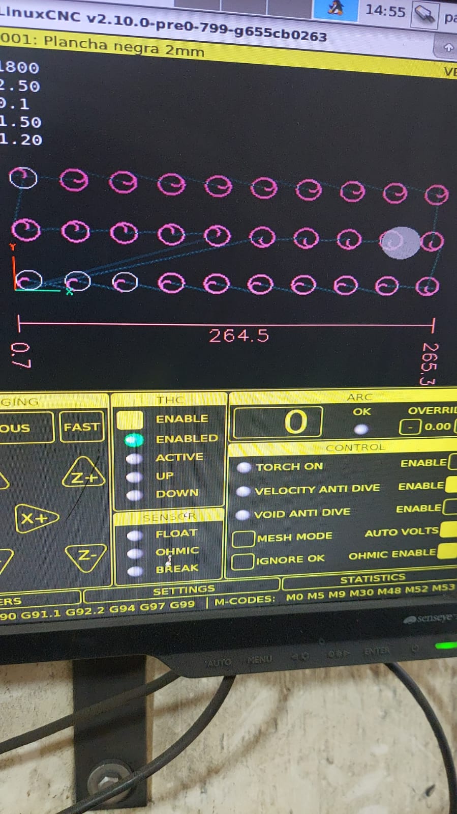

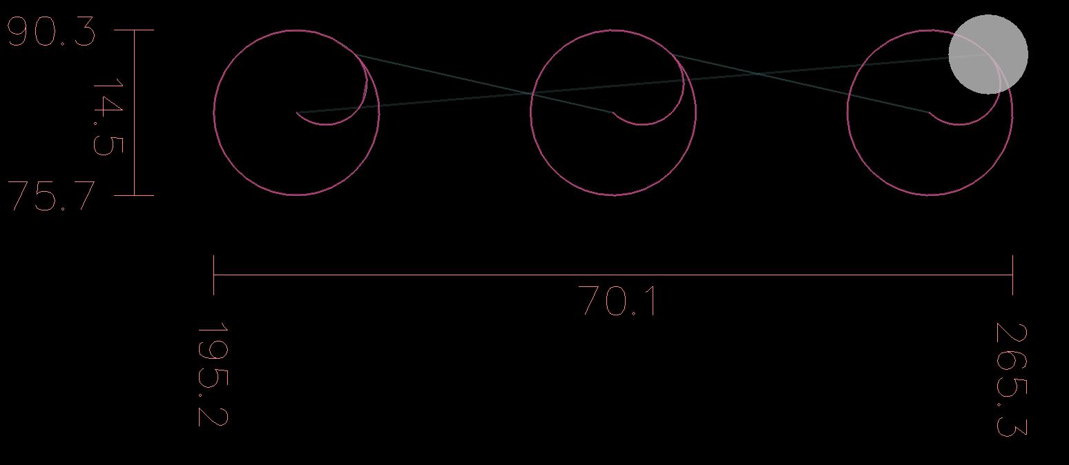

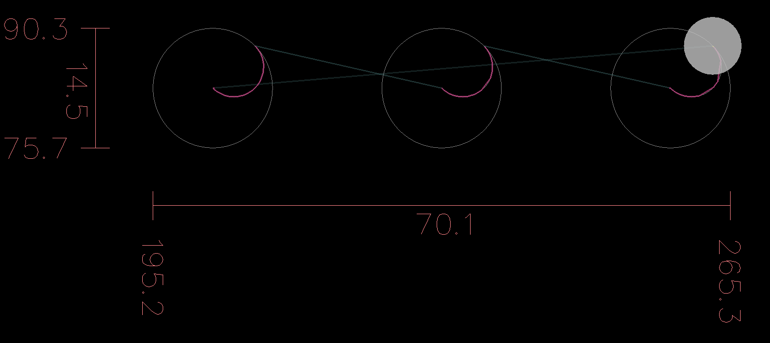

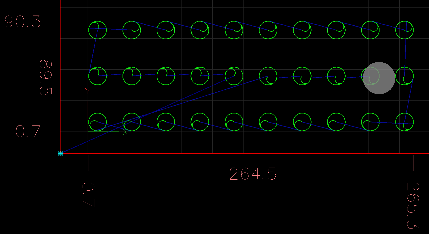

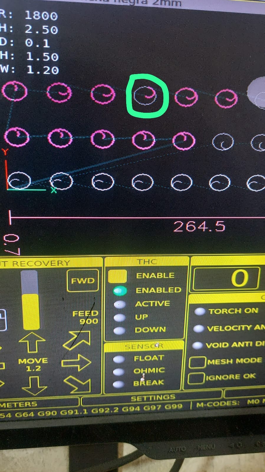

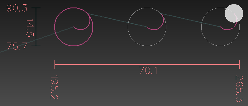

Hello.I am using shetcaam and Qtplasmac making holes with central arc entry and using plasmac's automatic circle creation Option 2. Slowing down and overcutting. The problem is that Qtplasmac detects some holes automatically and others not, and only cuts the arc as it happens in the image. This occurs only at the arch entrance.

May be helpful if you could post your g-code, please.

Thanks for you reply.
; file name: holes.tap
; date and time: Mon May 06 2024 15:33:00
; postprocessor: LinuxCNC_PlasmaCv1.scpost rev: 0.5
;begin pre-amble
G21 (units: metric)
G40 (cutter compensation: off)
G90 (distance mode: absolute)
M52 P1 (adaptive feed: on)
M65 P2 (enable THC)
M65 P3 (enable torch)
M68 E3 Q0 (velocity 100%)
G64 P0.254 Q0.025 (tracking tolerances: 0.254mm)
#<holes> = 2
#<h_velocity> = 50
#<h_diameter> = 42
#<oclength> = 4
;end pre-amble
;begin material setup
T0 M6 (select plasma tool)
G43 H0 (apply tool offsets)
M66 P3 L3 Q2 (wait for valid change)
F#<_hal[plasmac.cut-feed-rate]>
;end material setup
G0 X119.111 Y45.5
M3 $0 S1 (plasma start)
M67 E3 Q100
G3 X113.985 Y50.627 I-2.563 J2.563
G3 X235.349 Y40.373 I2.563 J-2.563
G3 X235.349 Y40.373 I-5.127 J5.127
M5 $0 (plasma end)

It runs fine here on my virtual machine. I did notice that it's running at 49.6% of the material feed rate, instead of 50%, I am not really sure why, but perhaps rounding error as I'm running this on an imperial simulation. Ignore the differences in colors, I change the color of the plotter via stylesheets.

I only had a few minutes this evening, I should have ran it through a metric config as well. Phill might be able to pick up where I left off this evening.
It is odd that everything ran at 49.6% velocity instead of 50%. Maybe it’s somehow related ¯\_(ツ)_/¯

I can confirm that this is an issue on both QtPlasmaC and plasmac2 in both LinuxCNC 2.9 and master.
I have been able to consistently observe it on metric configs but it does not appear to happen on imperial configs, this is with both configs run both a metric g-code and a imperial g-code.
It does not happen on PlasmaC in LinuxCNC 2.8, nor does it seem to happen on AXIS in LinuxCNC 2.9.
It also happens with all hole detection features commented out, a simple piece of code like below does not run the second G3 line on some holes:Adding a G4 P1 or a G0 X2.873 Y50.627 between the G3 lines appears to make no difference.
Currently I have no idea what is causing it...
In the meantime if you need to cut this job then changing the leadins to perpendicular should work.
G0 X8 Y45.5
G3 X2.873 Y50.627 I-2.563 J2.563
G3 X2.873 Y50.627 I5.127 J-5.127
M5 $0 (plasma end)Currently I have no idea what is causing it...

It's odd, because the code Phill posted, works for me. But running paulsao's code, I get 3 holes in a row that don't work, so I isolated them and started playing around. I dont know why, but if I change the starting point coordinates by 0.001mm, it works:
Before:
Result:
After:
Result:
I do see this issue in the following GUIs:
QtDragon HD XYZ (although not for all the circles)
QtDragon XYZ Metric:
No idea why, but the following GUIs ran OK:
QtAxis
Axis
Total g-code, because I wonder if these holes work on either of your setups:
Before:
G0 X202.444 Y83
G3 X207.571 Y88.127 I2.563 J2.563
G3 X207.571 Y88.127 I-5.127 J-5.127
G0 X230.222 Y83
G3 X235.349 Y88.127 I2.563 J2.563
G3 X235.349 Y88.127 I-5.127 J-5.127
G0 X258.000 Y83
G3 X263.127 Y88.127 I2.563 J2.563
G3 X263.127 Y88.127 I-5.127 J-5.127Result:
After:
G0 X202.445 Y83
G0 X230.223 Y83
G0 X258.001 Y83
QtAxis
Axis
G21 (units: metric)
F10000
G0 X202.444 Y83
G0 X230.222 Y83
G0 X258.000 Y83
M30 (end program)Attachments:
- snowgoer540
- Posts: 2580
- Thank you received: 907
07 May 2024 23:00 - 07 May 2024 23:03 #300073
by snowgoer540
Replied by snowgoer540 on topic Inssues Hole cutting
Well, I did some digging as I remembered some stuff around arcs and circles and what not. Long journey short, I came across this:
github.com/LinuxCNC/linuxcnc/commit/ad91...6d2b50d1fff275200941
Andy added the comment:
Which lead me to change line 717 of posemath.h to change the CART_FUZZ value from 1.0e-8 to 1.0e-7, and that worked, the arcs transitioned into the circles as intended.
Then I noticed that Phill you commented on Andy's commit. So I changed CART_FUZZ back to 1.0e-8, and made a change at line 1851 of _posemath.c to:
To open the check up a little bit, and that also works. Since your commit and comment on andy's commit had to do with movement around circles, maybe the latter change is more appropriate?
I am honestly not sure which is more appropriate.
// andypugh 5/2/22 This seems to be interpreted to be in config units.Which lead me to change line 717 of posemath.h to change the CART_FUZZ value from 1.0e-8 to 1.0e-7, and that worked, the arcs transitioned into the circles as intended.
if (d < CART_FUZZ) {To open the check up a little bit, and that also works. Since your commit and comment on andy's commit had to do with movement around circles, maybe the latter change is more appropriate?
Last edit: 07 May 2024 23:03 by snowgoer540.
