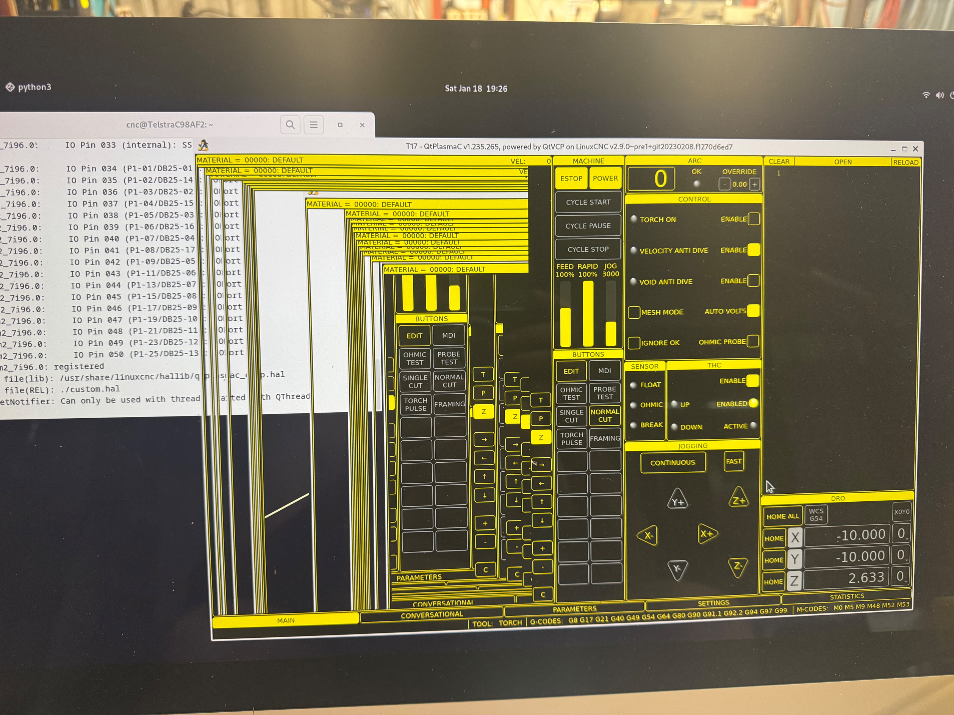

Hey,
So new PC all setup and running Debian Bookworm and LinuxCNC 2.9.0.
Glitching and not showing anything in the display screen.
Juat did a check in Synaps and have the latest version.
Any ideas?
Any ideas?

Code from terminal
linuxcnc
LINUXCNC - 2.9.0~pre1+git20230208.f1270d6ed7
Machine configuration directory is '/home/cnc/linuxcnc/configs/T17'
Machine configuration file is 'T17.ini'
Starting LinuxCNC...
Note: Using POSIX realtime

hm2/hm2_7i96.0: registered
Found file(lib): /usr/share/linuxcnc/hallib/qtplasmac_comp.hal
Found file(REL): ./custom.hal
QSocketNotifier: Can only be used with threads started with QThread
Can't jog any joints while homing.
emc/task/taskintf.cc 976: Error on joint 0, command number 106
task: main loop took 0.145498 seconds
task: main loop took 0.159640 seconds
task: main loop took 0.166205 seconds
joint 3 on limit switch error
emc/task/taskintf.cc 976: Error on joint 3, command number 364
task: main loop took 0.218127 seconds
/usr/bin/linuxcnc: line 974: 8429 Segmentation fault $EMCDISPLAY -ini "$INIFILE" $EMCDISPLAYARGS $EXTRA_ARGS
Running HAL shutdown script
task: 41912 cycles, min=0.000008, max=0.218127, avg=0.010067, 4 latency excursions (> 10x expected cycle time of 0.010000s)
hm2_eth: in hm2_eth_reset
hm2_eth: HostMot2 ethernet driver unloaded
hm2: unloading
/home/cnc/linuxcnc_debug.txt
hm2: unloading
and
/home/cnc/linuxcnc_print.txt
as well as in the output of the shell command 'dmesg' and in the terminal

That version of QtPlasmaC is from Feb 2023 and is known to have issues, you should update to the latest version.
The following user(s) said Thank You: RNJFAB
