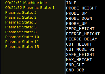

23 Mar 2025 13:44 #324665
by snowgoer540
Replied by snowgoer540 on topic 2.9.3 - Stuck in wrong state and stops
Here is what it looked like:
For reference:
So it missed:
4 - ZERO_HEIGHT
14 - SAFE_HEIGHT
16 - END_CUT
17- END_JOB
For reference:
# plasmac states
self.IDLE = 0
self.PROBE_HEIGHT = 1
self.PROBE_DOWN = 2
self.PROBE_UP = 3
self.ZERO_HEIGHT = 4
self.PIERCE_HEIGHT = 5
self.TORCH_ON = 6
self.ARC_OK = 7
self.PIERCE_DELAY = 8
self.PUDDLE_JUMP = 9
self.CUT_HEGHT = 10
self.CUT_MODE_01 = 11
self.CUT_MODE_2 = 12
self.PAUSE_AT_END = 13
self.SAFE_HEIGHT = 14
self.MAX_HEIGHT = 15
self.END_CUT = 16
self.END_JOB = 17
self.TORCH_PULSE = 18
self.PAUSED_MOTION = 19
self.OHMIC_TEST = 20
self.PROBE_TEST = 21
self.SCRIBING = 22
self.CONS_CHNG_ON = 23
self.CONS_CHNG_OFF = 24
self.CUT_REC_ON = 25
self.CUT_REC_OFF = 26
self.DEBUG = 27So it missed:
4 - ZERO_HEIGHT
14 - SAFE_HEIGHT
16 - END_CUT
17- END_JOB
