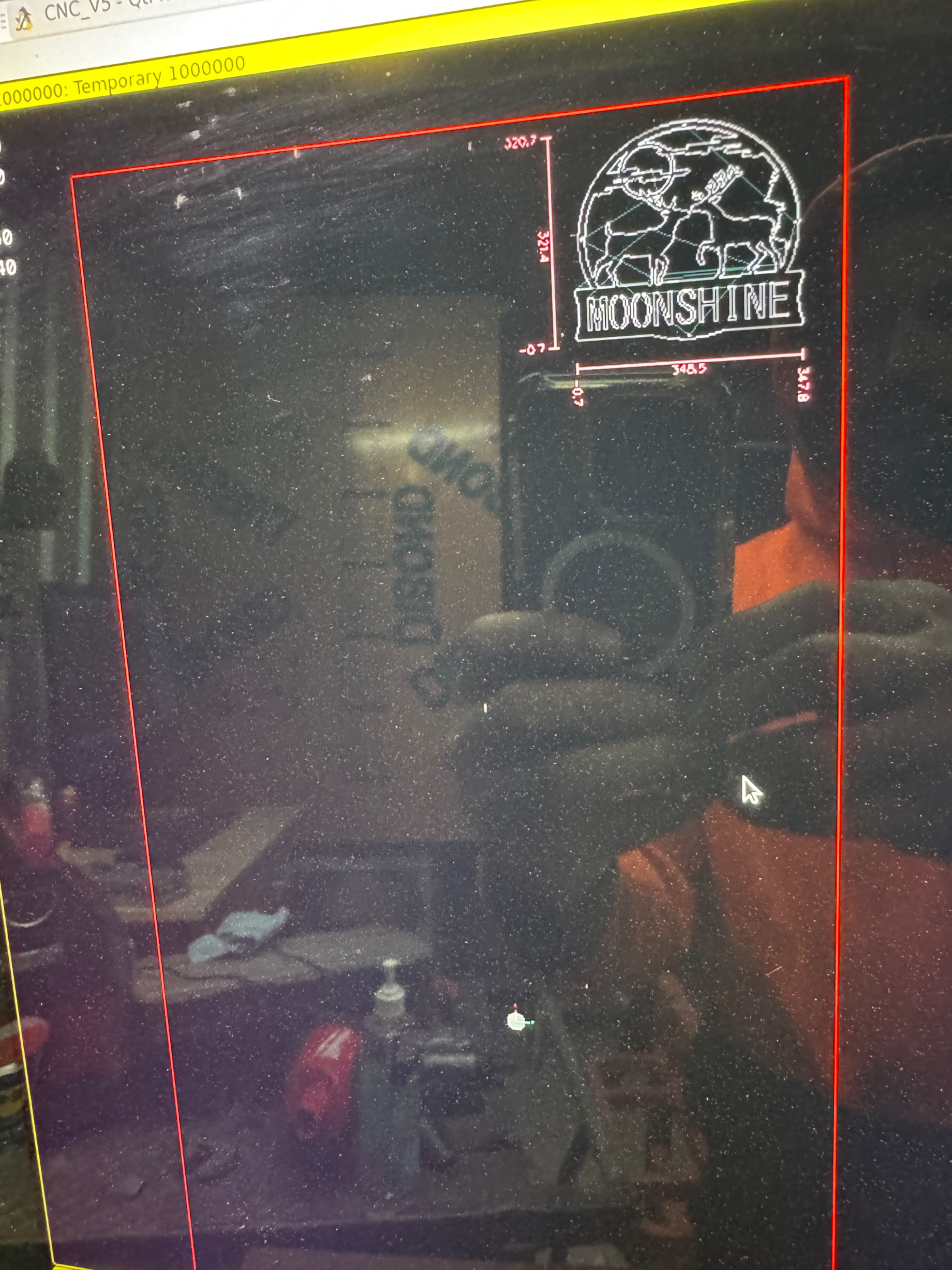

Just downloaded and installed 2.9.4.
Having a few issues with the loaded job.
It cuts once then deciding it wants to show the job 2500mm low on the Y axis. Although it will still cut where it is supposed to.
Also throwing error codes if i change any of the .tap file through the edit option.
Is there a new one I need to install?

05 May 2025 10:14 - 05 May 2025 10:30 #327748
by RNJFAB
Replied by RNJFAB on topic Job not showing in position - 2.9.4 - v2.9-238.315
tool is fine.
Attached photo of where it has decided to put this job.

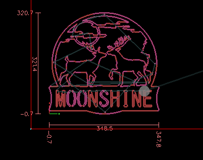

Can you post the original gcode file you’re having issues with please?

06 May 2025 11:52 #327843
by RNJFAB
Thanks Snow,
Willing to bet I have done something.
N00010; file name: Deer 3.tap
N00020; date and time: Mon May 05 2025 20:10:48
N00030; postprocessor: LinuxCNC PlasmaC.scpost rev: 0.4
