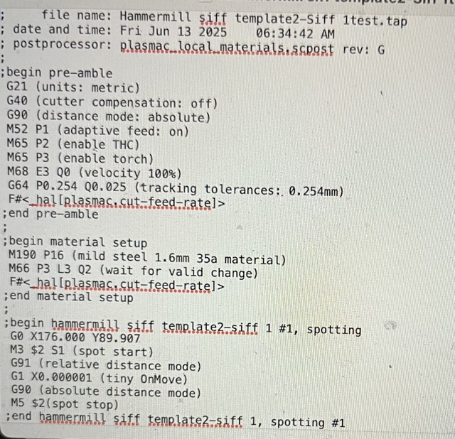

I have been trying to use the spotting operation on my plasma cutter.
it is a file with an array of many holes.
so I used the drilling operation.
I used the postprocessor for local materials.
So I got it to work well. Does the spots as expected.
But there is some strange behavior on my machine.
If I load the file the machine uses the jogging as set on the machine. But if I activate the button for slow jogging it still jogs fast. After a couple of spots the machine stops at random amounts of spots.
The pause resume button does nothing.
I have to stop the program completely and resume at the line where it stopped.
Is the local materials post processor ok for spotting operations or do I need a custom post processor for this?
