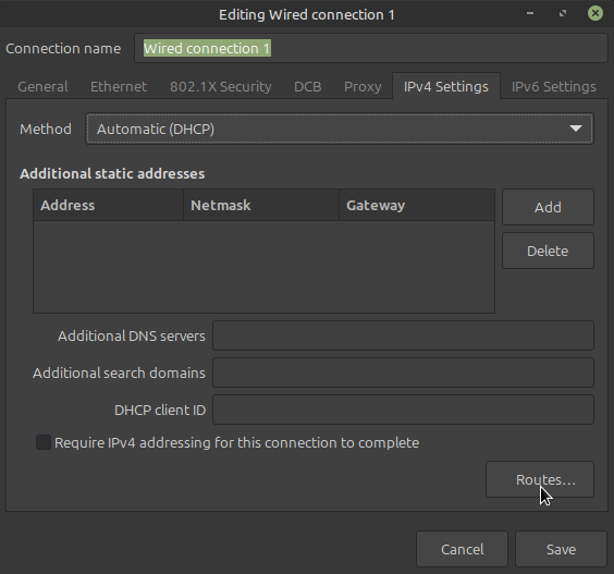

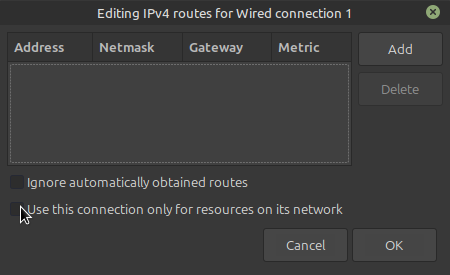

31 Oct 2025 12:22 #337584
If yes, then make sure the below is selected:
Replied by tommylight on topic USB activity causes network error
Is that the included Network Manager ?Tommy I usually make use of nmtui or the network manager

Replied by mariusl on topic USB activity causes network error
It is the included one yes. So you say I must select the option of "Use this connection ..."
Regards
Marius
www.bluearccnc.com
- Posts: 21984
- Thank you received: 7483
31 Oct 2025 13:10 #337587
Yes, but only for the network Mesa is attached to.
