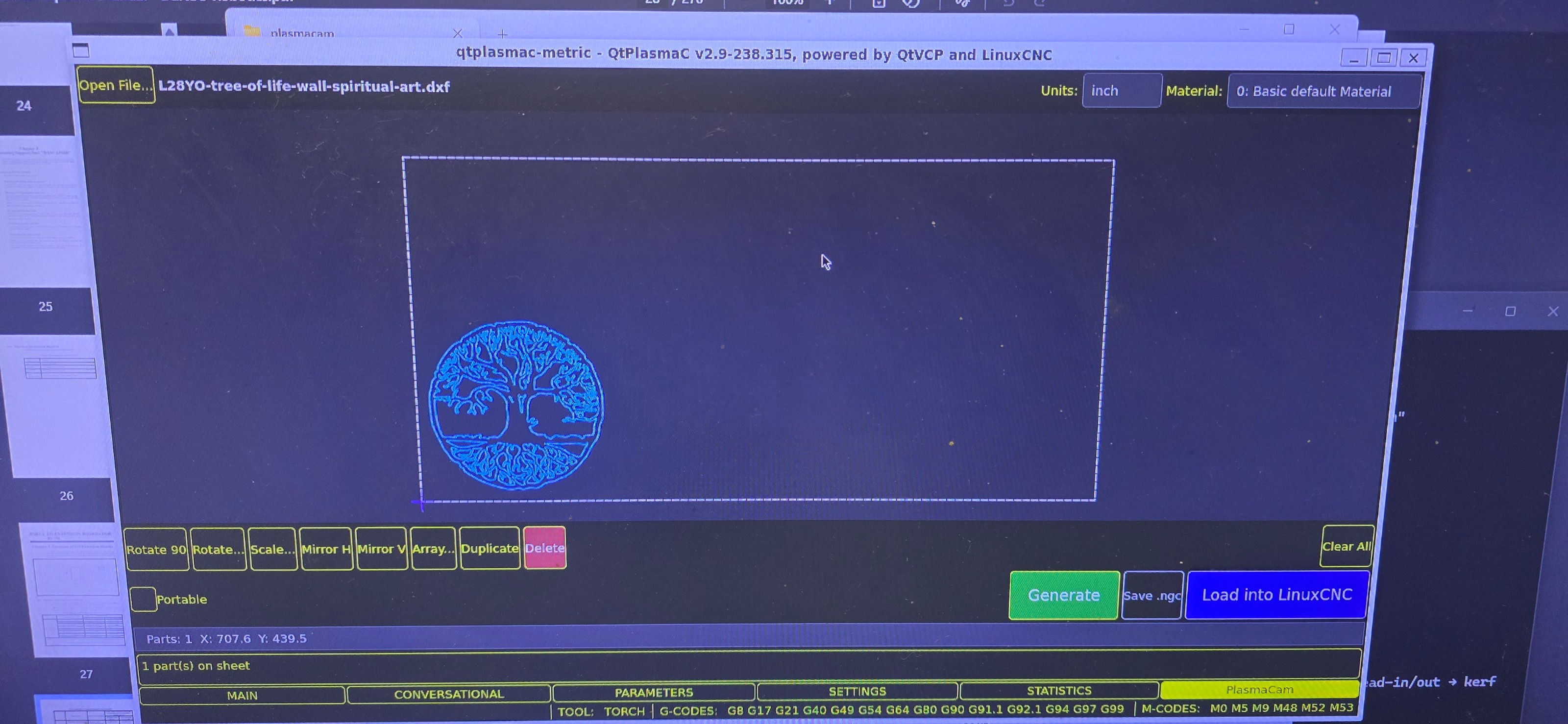

21 Feb 2026 07:18 #343248 by tcbmetalworks
Replied by tcbmetalworks on topic QTPLASMAC integrated cad/cam
I ran sheet cam for a long time on my mach 3 plasma table. Maybe I am a little confused with qtplasmac its my first time using it. I just dont understand why you would have a materials tab and then end up setting all your speeds and feeds in sheet cam? Is this only for the conversational? Either way all in one would be much better. I am trying to keep it super simple so that I can teach people super easy how to run my machine. There also is no automatic nesting in sheet cam and I know this is not a easy task but, for a basic version should not be to crazy. This is what I have done so far, all internal to qtplasmac

21 Feb 2026 07:49 #343250 by Hakan
Replied by Hakan on topic QTPLASMAC integrated cad/cam
Good start!
Materials, there are two ways (at least). One is to set all options in Sheetcam and that overrides the settings from the Materials tab.
Sheetcam is then the master of everything. That's what you have seen.
An other way is to set material index from sheetcam, it uses then the material index from the Materials tab.
Still, you need to select that when you sit with Sheetcam.
For that you need to go in the post processor code and change to false line 24
useTool      = false  -- Set to true to use SheetCam's tool table to generate a temporary material file entry
An other way, that I use, is to set material myself when I am at the machine.
Sheetcam only makes the cutting movements, not the material selection.
For that, insert comments in the printouts on line 171 in the post processor
   else
      post.Text ('; M190 P' , tool,' (',string.lower(toolName), ' material)\n')
      post.Text ('; M66 P3 L3 Q2 (wait for valid change)\n')
   end
Note the initial ";" comment in the printout. Plus useTool=false.
Automatic nesting isn't needed, at least to start with.
Being able to read in several G-code objects and interactively
place them on a sheet would be golden.
I like your start and hope you continue.
21 Feb 2026 08:30 #343251 by tcbmetalworks
I will continue working on it everyday, I know theres a way I can make this work with multiple programs but it really makes it hard for me to train someone on it. a built in 2d cad would be amazing too, even if its just super simple. My goal is to have it be the MS paint of cad lol.
