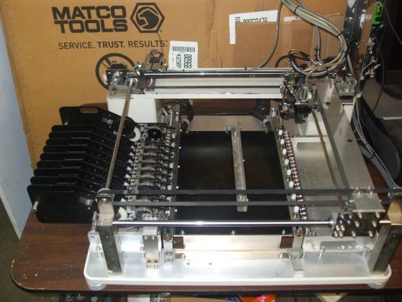

So I know SMD Pick and Place machines is kind of an oddity for Linuxcnc however one of the possible machines I want to try linuxcnc on is an old Mancorp Pick and Place machine the X,Y,Z, and A axis is pretty straight forward, advancing the feeders however is not. I am sure I can treat them as a rack style ATC but I would need to advance the feeder after a component is picked up. Fortunately the mechanism that advances the feeder is a pneumatic cylinder that is on a seperate
3 position slide so that one cylinder can advance 3 different feeders ( obviously not at the same time ). This machine has a total of
48 feeder slots ( 24 per side ).
16 feeder advancing cylinders ( 8 per side )
4 rack position cylinders ( 2 per side )
and I have to have 2 more air / vacuum control solenoids for the head to pickup and release of the components when placing them . Which means I need to control 22 separate pneumatic control solenoids
So I guess my question is are there any examples presumably rack style ATC setups that has to deal with multiple relays / solenoids?
That way I can figure out how to do it.
hopefully I have enough I/O pins to make it work ( 6i25 and 7i76 )
sorry I don't have more pics I hope to load up more soon.

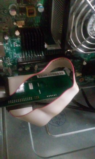

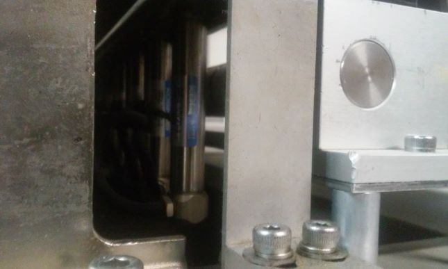

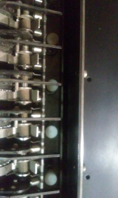

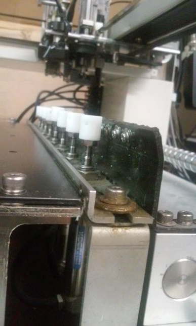

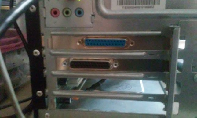

there is a very similar machine that is operational ( a few years newer ) I have to wait for them to run a job on it to get some video. for now though here are some pics I took while I was there today
those two cylinders are what moves the rack into 1 of 3 positions. position 1 both cylinders off . position 2 one cylinder is on. position 3 both cylinders are on
this one shows the advancer cylinders when 1 is activated the white cap extends about an inch to push the advancer arm. when off
an internal spring retracts it.
this is what the cylinders look like underneath
a top view with the feeders still in place
the new 6i25 with an additional DB25 connector above it
view of the plugs
