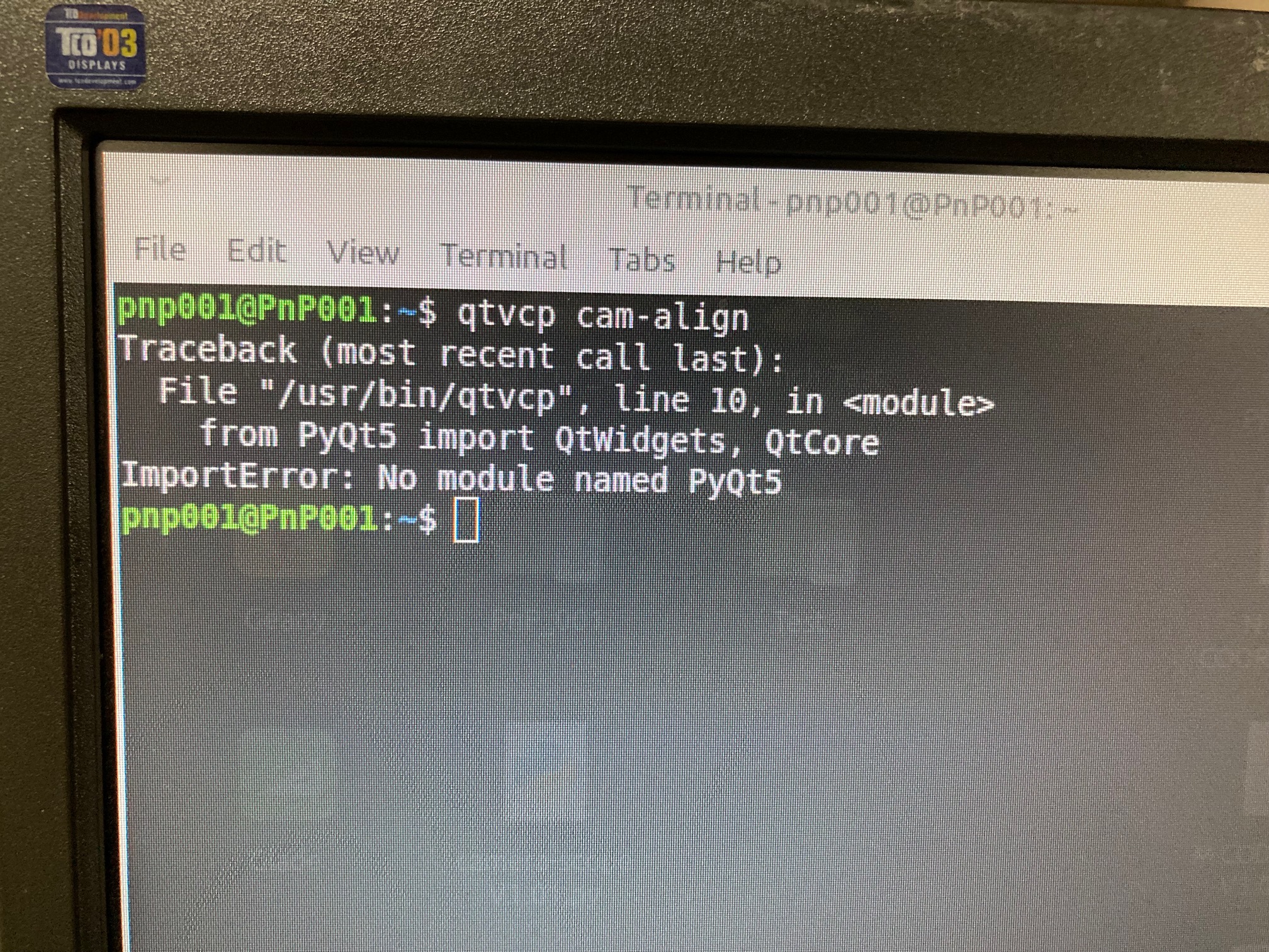

in a terminal try:
qtvcp cam_align
and see what happens.
Post errors if you get some.
qtvcp cam_align

23 Feb 2023 21:46 - 23 Feb 2023 21:49 #265154
by my1987toyota
Replied by my1987toyota on topic Downlook Camera X Y Offset
Last edit: 23 Feb 2023 21:49 by my1987toyota.

23 Feb 2023 22:27 #265162
Replied by tommylight on topic Downlook Camera X Y Offset
The following user(s) said Thank You: my1987toyota

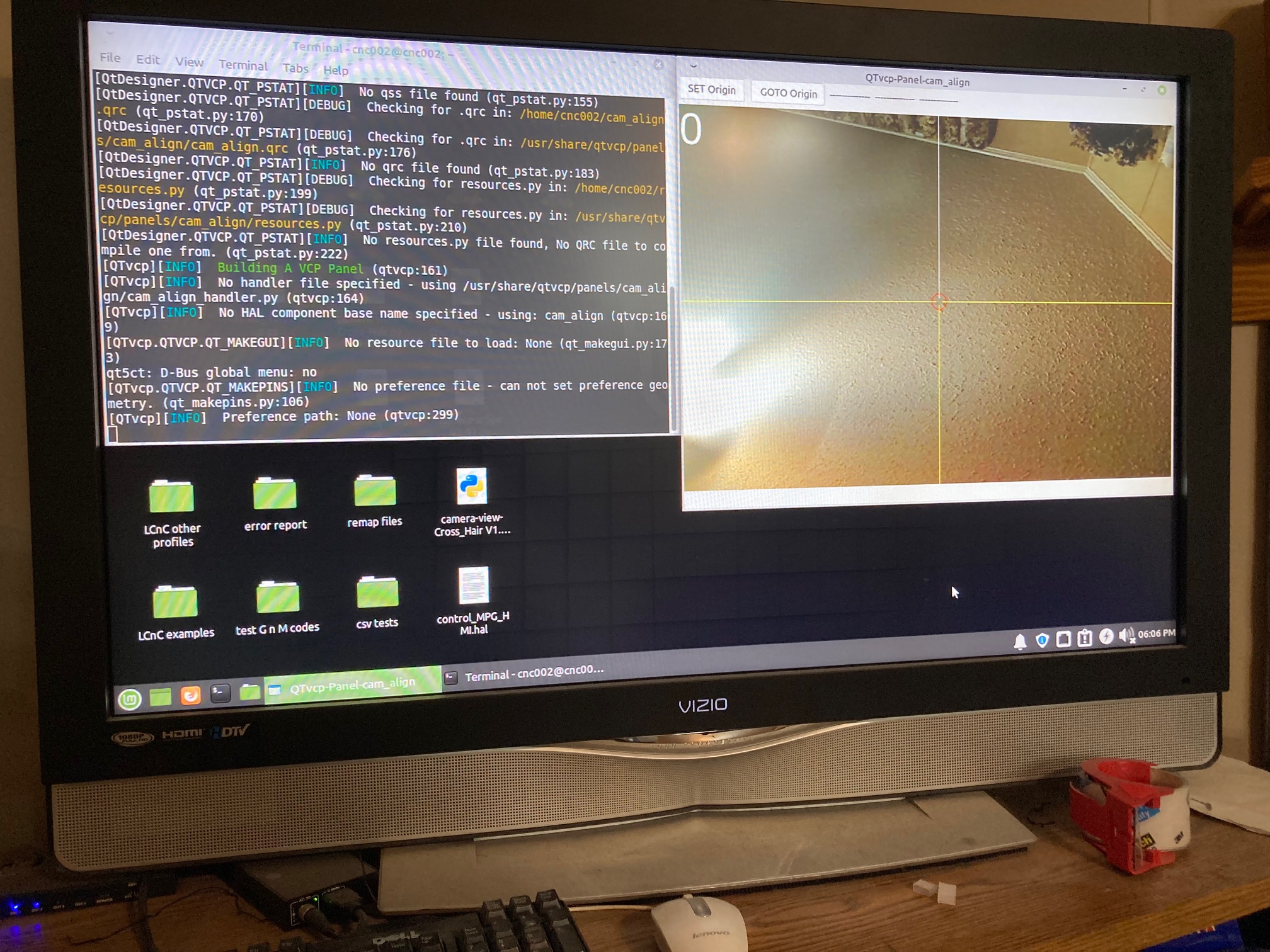

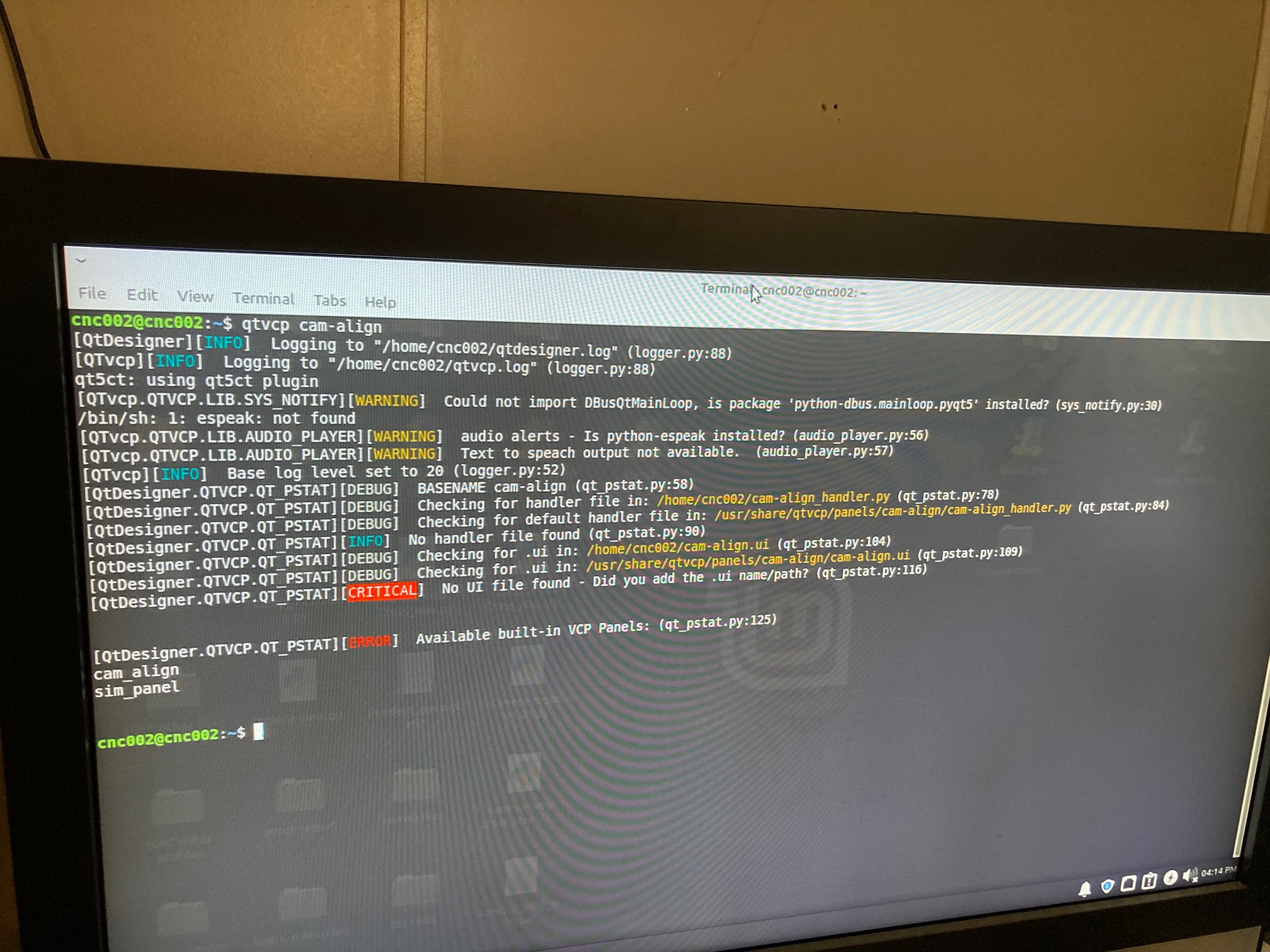

23 Feb 2023 22:28 #265163
Replied by cmorley on topic Downlook Camera X Y Offset
Try cam_align with underscore
- my1987toyota
- Posts: 1001
- Thank you received: 447
23 Feb 2023 23:12 - 23 Feb 2023 23:33 #265168
by my1987toyota
Last edit: 23 Feb 2023 23:33 by my1987toyota.

- Posts: 7368
- Thank you received: 2181
23 Feb 2023 23:54 #265174
just another option. conveniently it already uses opencv.
Note the buttons on top. These call MDI commands but could do other things.
