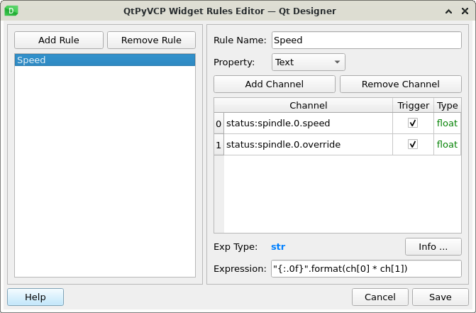

2. how do I connect the spindle encoder to the "DRO" on the GUI? my pins are all there in the HAL file, but im sure there is another file that needs one or more of the hal pins.
The darker (left side) spindle rpm dro in the lower main panel is the actual spindle speed taken from linuxcnc "speed" status. in the gui it is pulling data from linuxcnc STATUS: spindle.0.speed and is a float value.  you should be able to connect your hal to feed this.  you can see the dro widget rule for the readout below as well as the docs link to set you on the path on how to accomplish this:
linuxcnc.org/docs/html/config/python-int...spindle_dictionary_a
im not exactly following what youre saying here, in the pyVCP on a normal Axis GUI the hal pins
"net spindle-vel-fb-rps         =>  abs.0.in
net spindle-vel-fb-rps-abs abs.0.out"
are assigned to
" spindle-fb-rpm-abs-filtered       =>   pyvcp.spindle-speed
net spindle-at-speed        =>    pyvcp.spindle-at-speed-led"
and that shows up in the VCP.
do I use these same pins and just assign them to different values? or am i missing this completely?
29 Jan 2022 15:06 - 29 Jan 2022 15:09 #233485 by Lcvette
Replied by Lcvette on topic Probe Basic Help
sorry misunderstood, thought you were editing the gui itself for your desired needs.. here is an example of the spindle section hal from my machine, should help!
