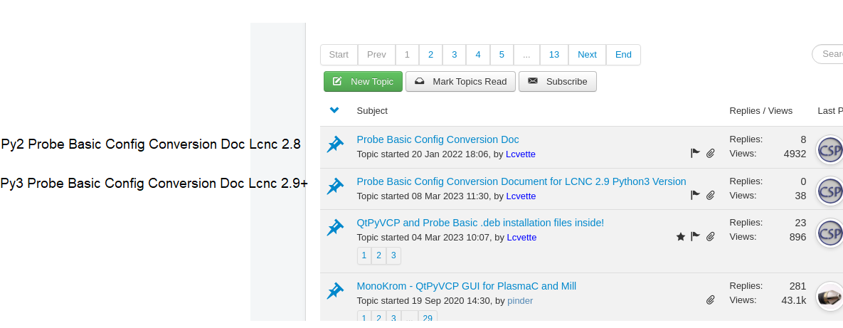

I am a mod but couldnt change the name..
Python2 - Probe Basic Config Conversion Doc
- Lcvette
- Posts: 1679
- Thank you received: 782
08 Mar 2023 18:32 #266136
by Lcvette
Replied by Lcvette on topic Py2 - Probe Basic Config Conversion Doc Lcnc 2.8
and if you could the other one i just posted earlier today could you change it to
Python3 - Probe Basic Config Conversion Doc
that way they are easier to find which one you need
